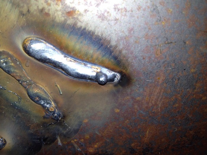

Your technique is also very poor, it looks like you're travelling way too fast with the torch canted over too far and your steering is shocking.
The beads are thin and straggly with a very elongated 'vee' pattern and the only one that's straightish is the one on the left in pic 2 but even that one varies in width.
Slow down, bring your torch nearer vertical and steady the shroud with your spare hand.
Have you looked at the tutorials? If not then I'd suggest you do.
It won't help if you're losing gas, which I suspect you are, but it will help you learn better torch control which you badly need.
