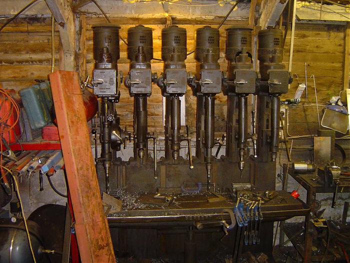

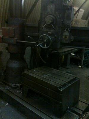

Nice drill. What do you build, arks?
Came free with my fly press, keep meaning to put it on eBay
I`ve got my old but trusted meddings pillar drill or the bridge port miller for any thing bigger
