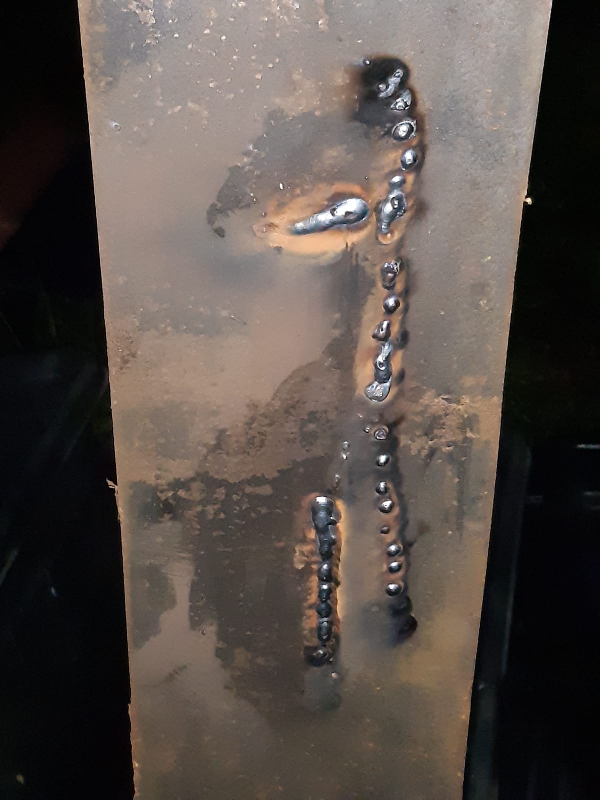

mate my hands are not always very steady due to my disability ..Should have said, I agree with @Wozzaaah , looks like you're skating across the surface, do you have good view/steady hand?!
mate good point as I feel will get there in end..dont be disheartened,everyone has or had to learn at some point, i will never forget my welding tutor at college on the 2nd day "looks like puppy sheet in the snow"....![]()
shouldve gone to specksavers......I'm the only one seeing Clint Eastwood firing a gun to the left it seems. I actually thought this was an art piece.
thank you mate I get the point on movement think also will give her a service...Use both hands on the torch to keep it steady. It is extremely important to be comfortable, rest your arms on the bench if you are able to. Don't be afraid of the sparks and the heat. Don't start moving straight away. Let a weld pool form and then slowly move the torch. I remember watching a mate trying to weld with no prior experience and it looked a lot like what you have produced. It's a slow deliberate movement with torch that you want to be aiming for.
ok mate I get that..You still haven't cleaned the steel. You will not get good results until you do.
thank you mate I feel getting there..Looking much better though![]()
