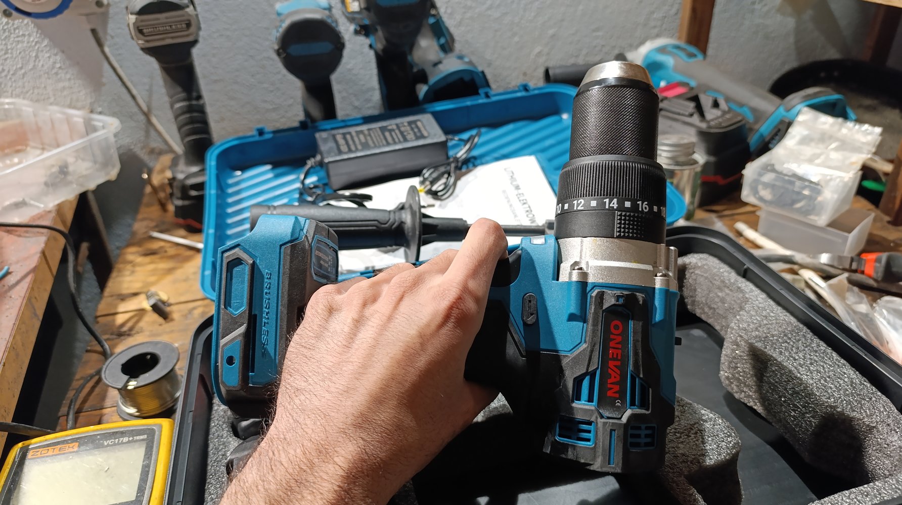

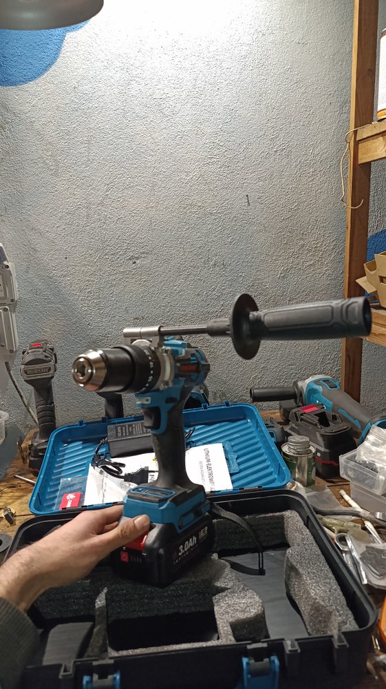

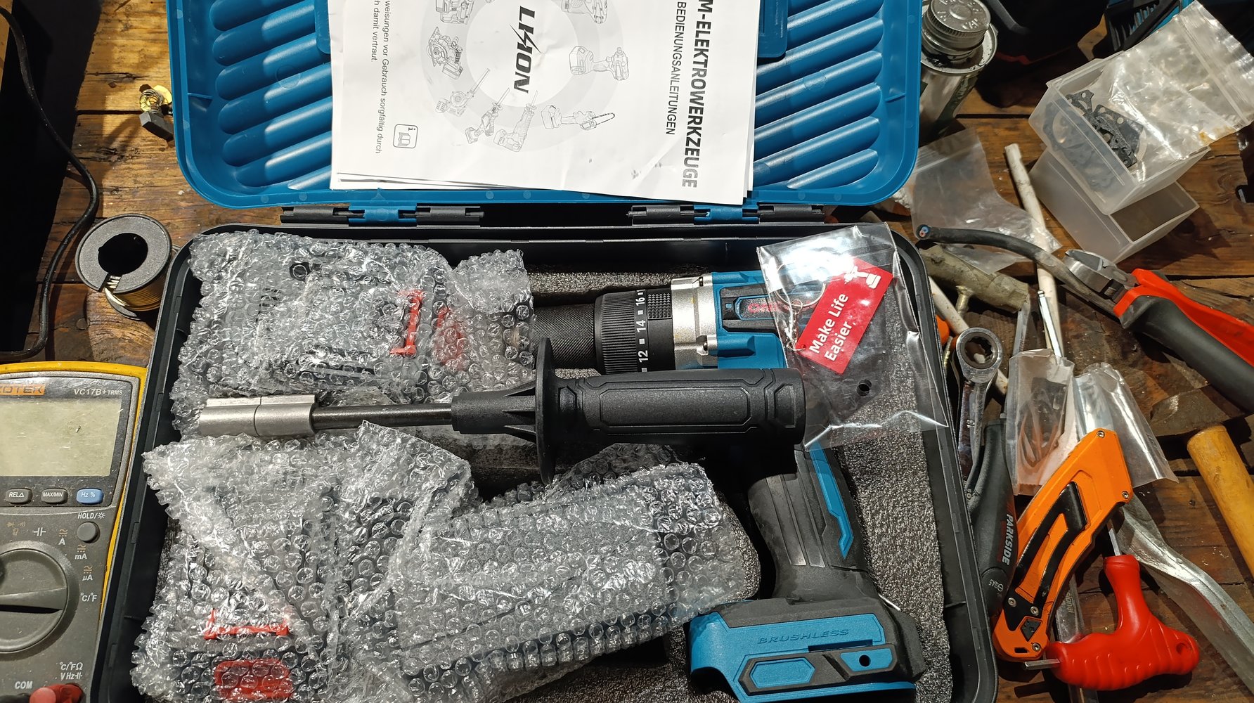

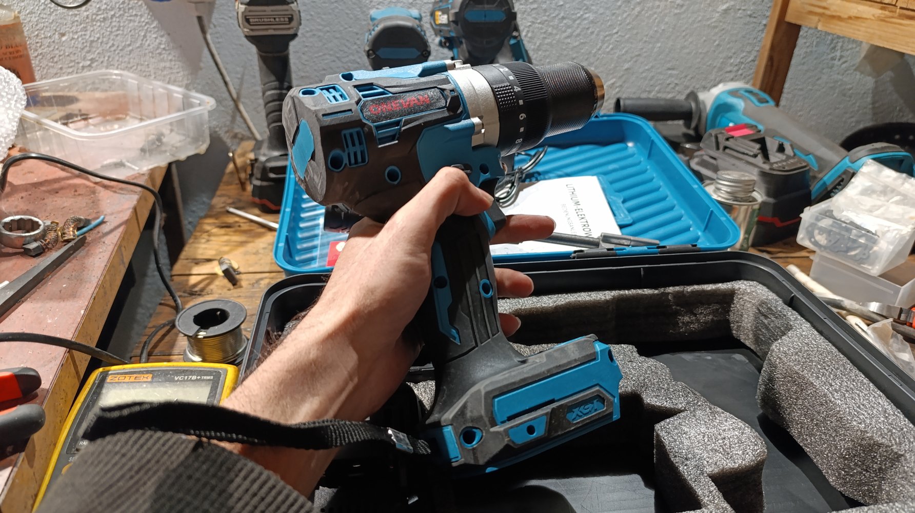

Hi everyone between yesterday and today I've got the time to disassemble reassemble and test the Onevan "650Nm" comby drill.
Let's start saying it surely doesn't have 650Nm or 140Nm advertised on Amazon.
Still have enough power to complete every hobby job we might need.
Here we have it in all its chinesium pride.
Overall a nice drill for the price paid just 60 euro but you can apparently get it for a lot less on Chinese websites like AliExpress Banggood and Company.
It's a mixed designs product, I call it DHP458 clone because it resembles a lot Makita products, it uses LXT batteries, and because it's the model number to which it gets closer while speaking about performances.
It came in a not great but not bad either hard plastic carrying case.
There are two 3Ah batteries, fireproof

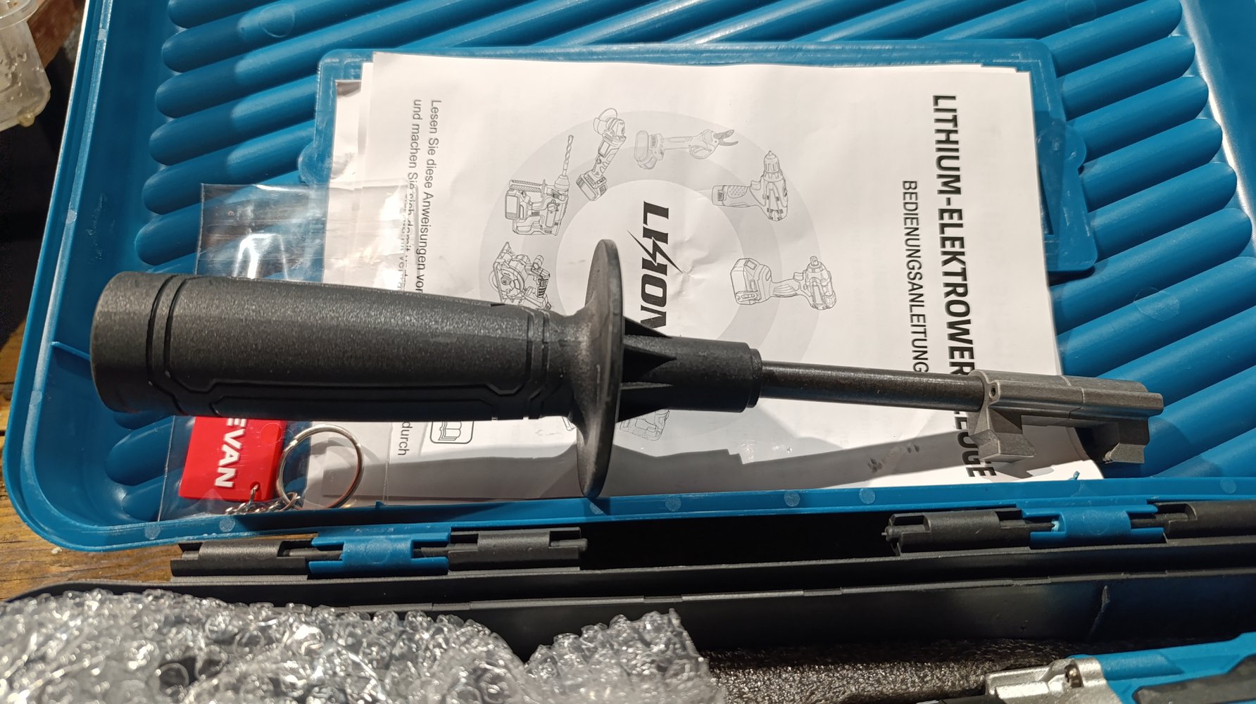

charger, side handle and a little keychain.
The handle looks inspired by Milwaukee both for shape and locking mechanism, cheap and sturdy enough to withstand the torque delivered by this drill.
I'd like if they implement a little spring to spread the detents apart when loosening it, but we are already lucky they used a little guide rod to keep them aligned
Brushless written on a side of the Battery well
XGT logo on the other.
They may have thought that LXT was too old and so the logo the most recent battery platform offered by Makita has to convince more customers to buy it.
Great

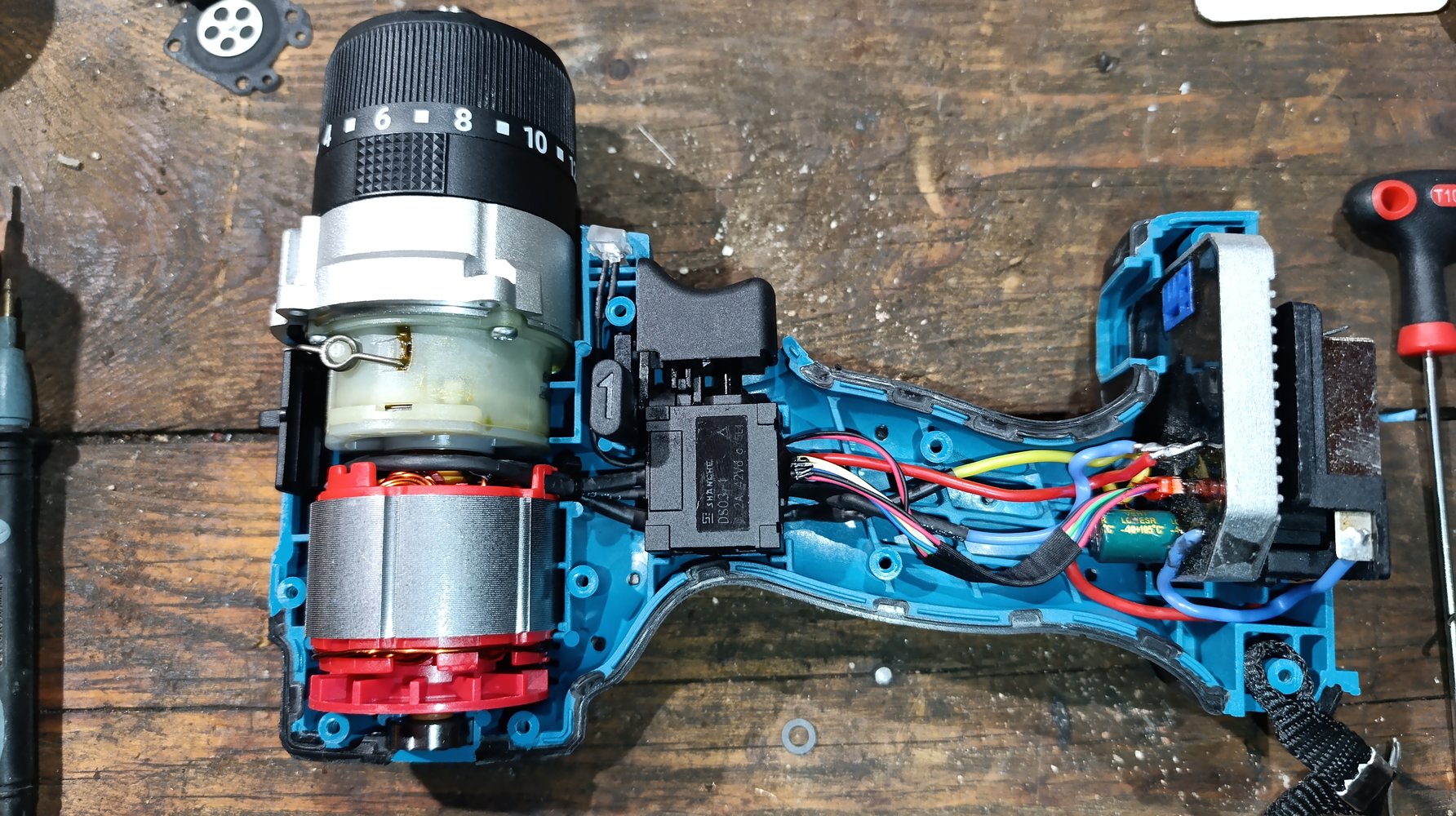

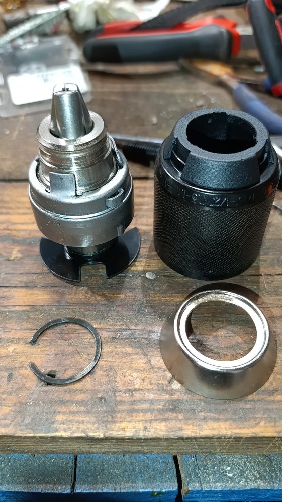

Anyways that's how it looks inside.

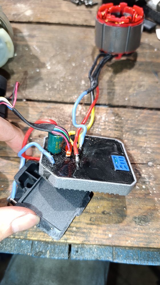

Nothing special, we don't have the regular clone PCB we are used to find on impacts
We have battery and power indicators but not a selector button.
Which can be implemented theorycally because the panel has the button

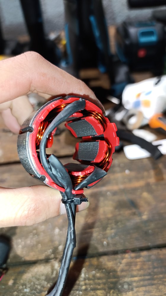

The stator windings are so far the best I've seen on clones yet.
Thick windings, epoxy in place, nothing comparable to real Makita but at least some sort of quality.

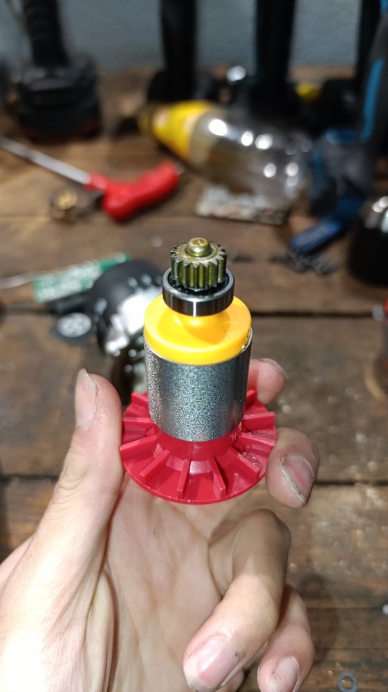

The rotor has a very strong magnet, nice and robust cooling fan, it's yellow too
Anyways it spins on two 625-2RS shielded bearings which is nice to see
