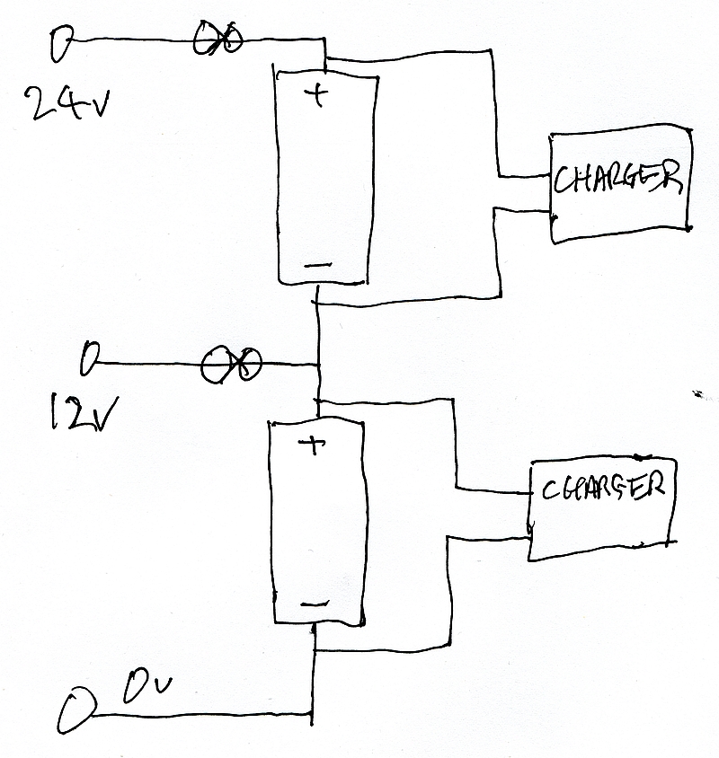

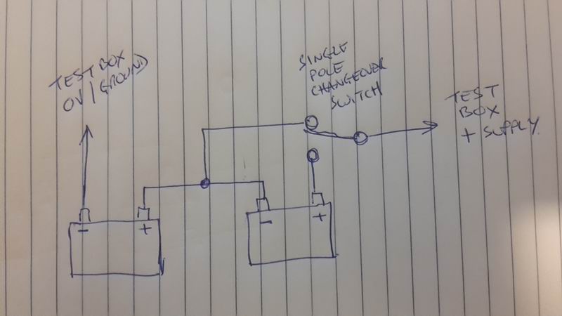

I realise I can have 12v but by connecting to one of the batteries but I still need to switch between 12 and 24 and if I did this only one battery would get used of the two when working on 12. Just thought if its possible I could use the pair in 12 or 24 with the correct switching.
Bob
Doesn't do the parallel bit, but a simple switch will give you 12/24V
