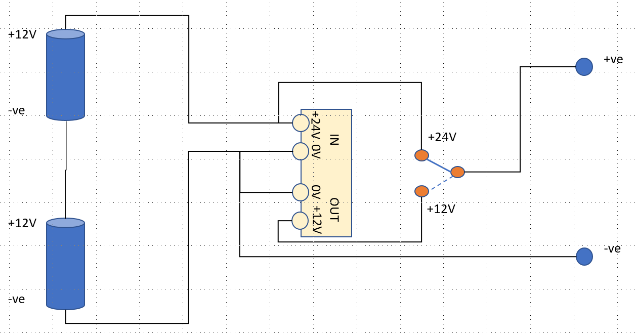

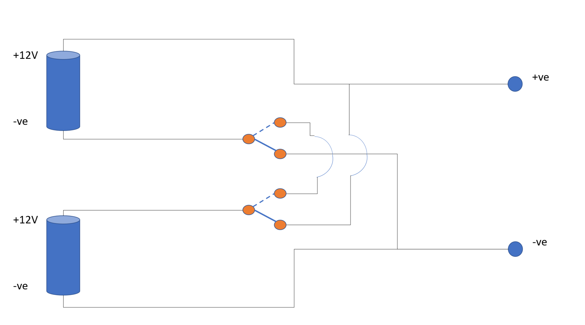

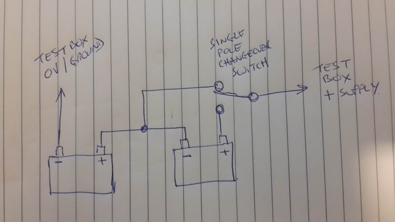

It would, but at the expense of nicking some forward voltage (which probably isn't important) and the (more significant!) expense of needing two at ~400A which are around £35 to £40 a go.Thanks for the info, two more questions though. Would a diode fitted on each battery live stop one robbing charge from another and exactly what knife switch do I need ?
Bob
And, as rtb states, you'll also need fuses.
How many poles on a rotary switch are needed to follow
