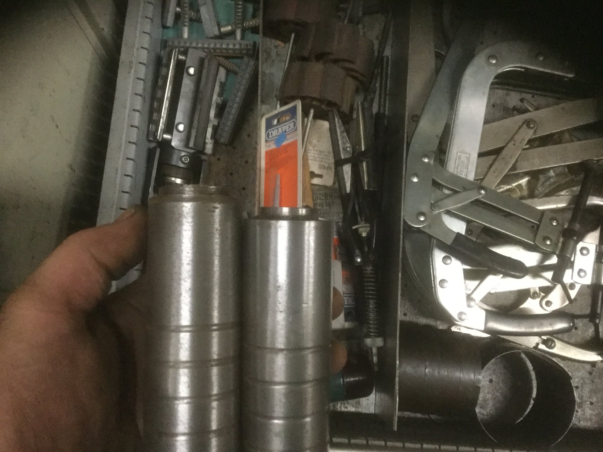

replacing core plugs on an old engine what would you do to make sure they had a good seal . a Loctite b jb weld c other
If you make a stepped punch to fit them, leave a good internal clearance for when the core plug closes up. I can still hear my Father laughing at his mistake!
Clean the block up well.
Chill the core plugs in fridge, a smear of blue hylomer.
Using a socked drift them in.
Or this does as well.

To lazy to go and take a picture of my kit.
Works for me.
Works for me.
