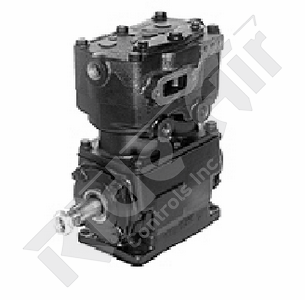

KN13060X - EL1300 Pulley Drive Compressor
EL1300 Pulley Drive (KN13060X) Air brake compressor for heavy trucks, semi trucks, 18 wheelers, commercial trucks, ect. Used to pressurize air for the actuation of air brakes.
ride-air.ca

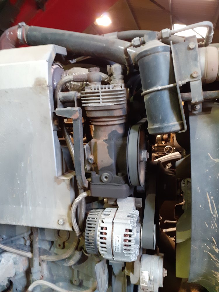

Some belt drive lorry compressors here James. Appropriate electro magnetic clutch and belt and bingo.
) be reasonably straightforward to take the gear off and put a v pulley on. Then run it from whatever.
