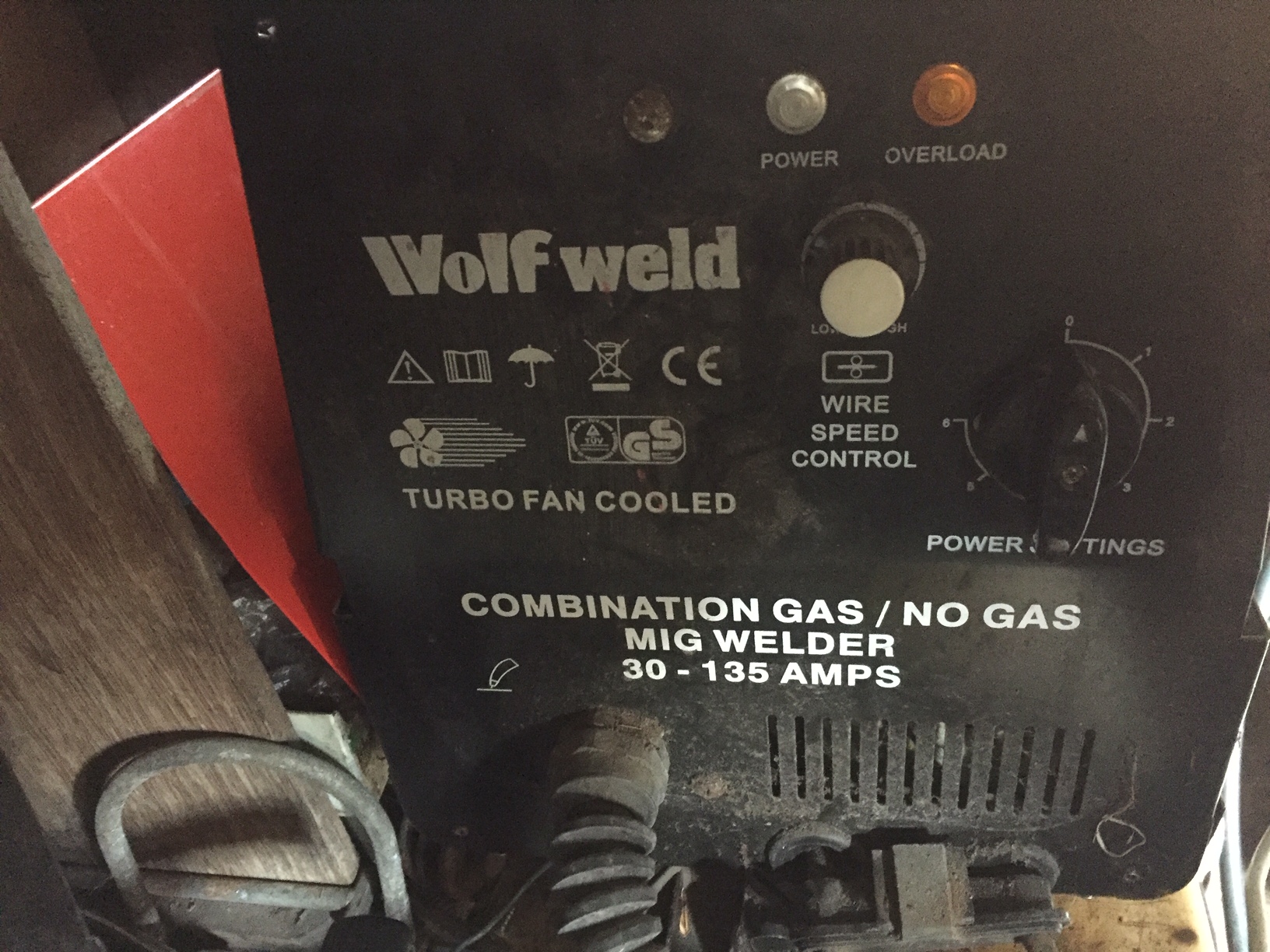

    what is or is there any difference between these new inverter type welders over my old clockwork type? i just been told it is going to cost 100 euro to replace the main switch on mine with a second hand switch or 200 euro for a new one. i found a cheap gasless welder on ebay ya know the same design but different name type for £80 so thinking get one of them as if i replace my main switch something else could go wrong.
    this is mine

    Your current machine has 6 power settings, from 30 to 135 Amps. According to the label on it, the one on eBay has only 4 levels, from 32 to 100 Amps.
    It is not an inverter machine, it is a traditional transformer type, and I really wouldn't expect that at £78.49 it is even half as good as your present one.
    As long as you ( we ) can work out how to wire it up, I would think that the first switch I suggested, at just £8.63, will fix it.

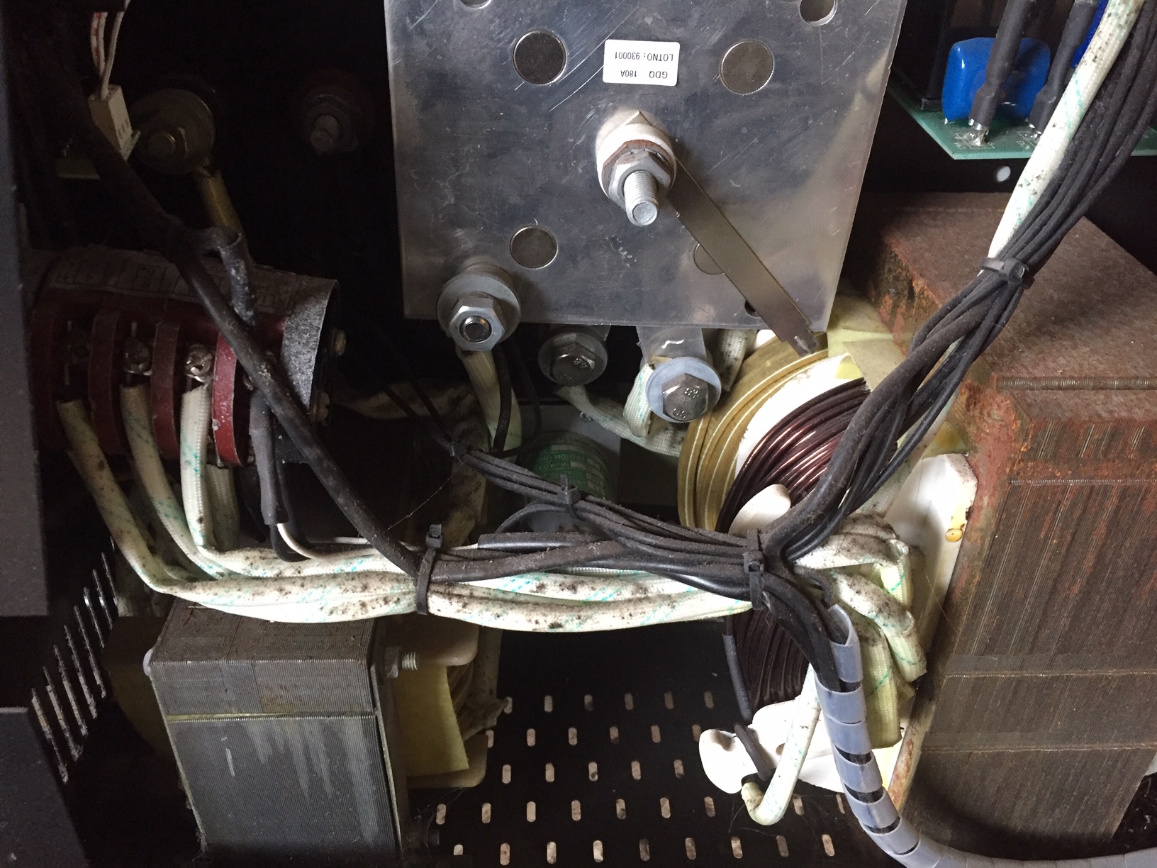

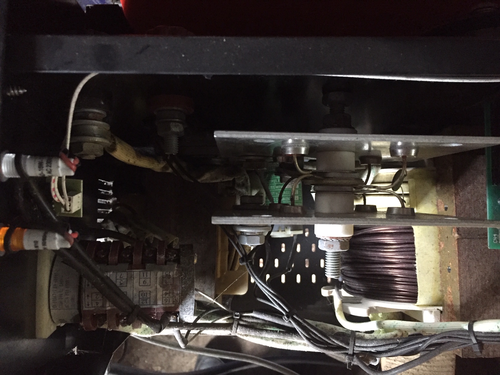

    i like the idea of the first one you posted but i wouldn't even know where to start with the wiring the yellow one looks easier as it has the screws on the terminals.i have a pic that i took of mine before it went away and they look very similar what do you think?

    A transformer-based MIG welder is a pretty simple machine, there is not a lot to go wrong. If the current broken switch problem is solved, I would not expect anything else to fail soon. It's a machine that you know, and has previously worked for you, so after it's fixed it should be fine.
    I don't think paying £78.49 for a new and very basic machine with a lower spec than your present one is good value.
    The first switch that I linked to, at £8.63 inc. postage, will probably do the job. These welder power range switches can be a baffling nightmare ( especially if you try taking them to pieces ). However, that one is just about as basic as you can get. All you need is 1-pole, 6-way, plus an "off" position. There may be some documentation shipped with the switch, and I'm sure that with the help of an Ohmmeter we can buzz out where the wires should go.
