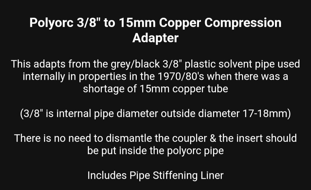

I am clearing out what used to be an outside toilet, masonry built attached to my house. The old cistern feed pipe coming out of the concrete floor and from God knows where is still live so I need to cap it off.
It is a black plastic pipe, very much like modern MDPE. But the outside diameter is measuring 17.63mm approx.
What size of cap fitting do I need to order for this does anyone know please? Maybe it's a known old imperial size. Common fittings are 20mm and up which is no good for this pipe.
