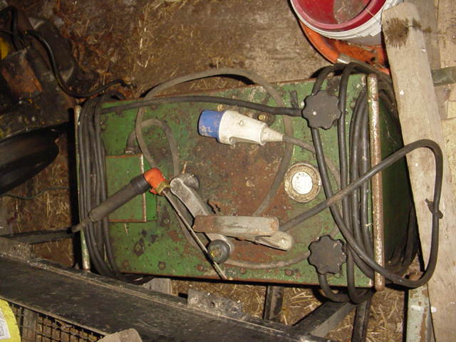

So, an Oxford or similar won't run off an extension cable from the kitchen then???
I did exactly that. The socket is specified for a cooker at about 30A, I think. The extension lead is standard 13A. The 180A Oxford works fine on lower settings but, not surprisingly, it blows one of the two in-line 13A fuses on higher output settings.
