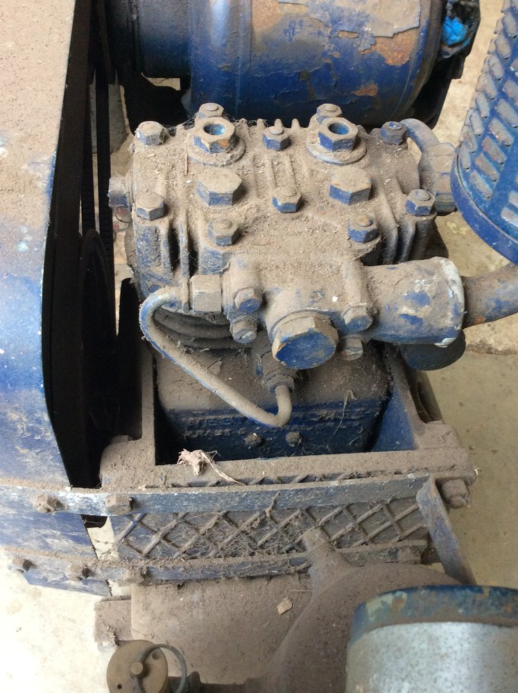

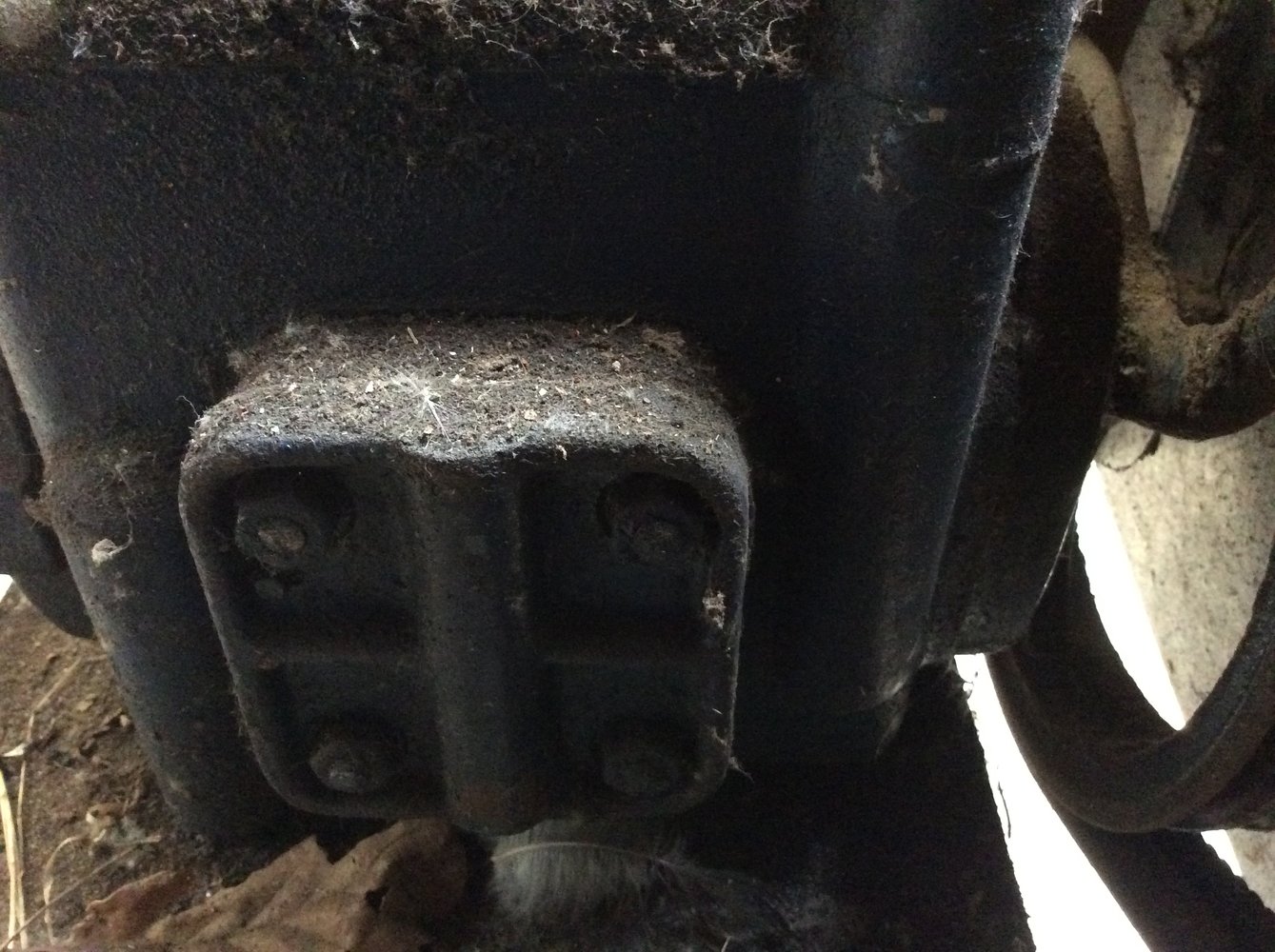

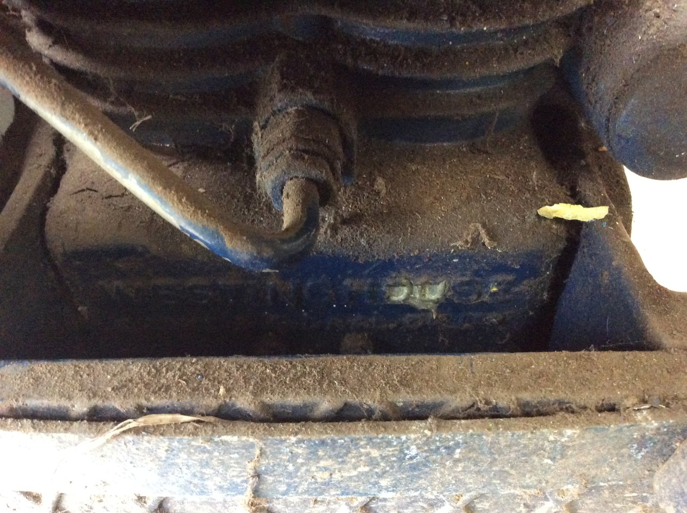

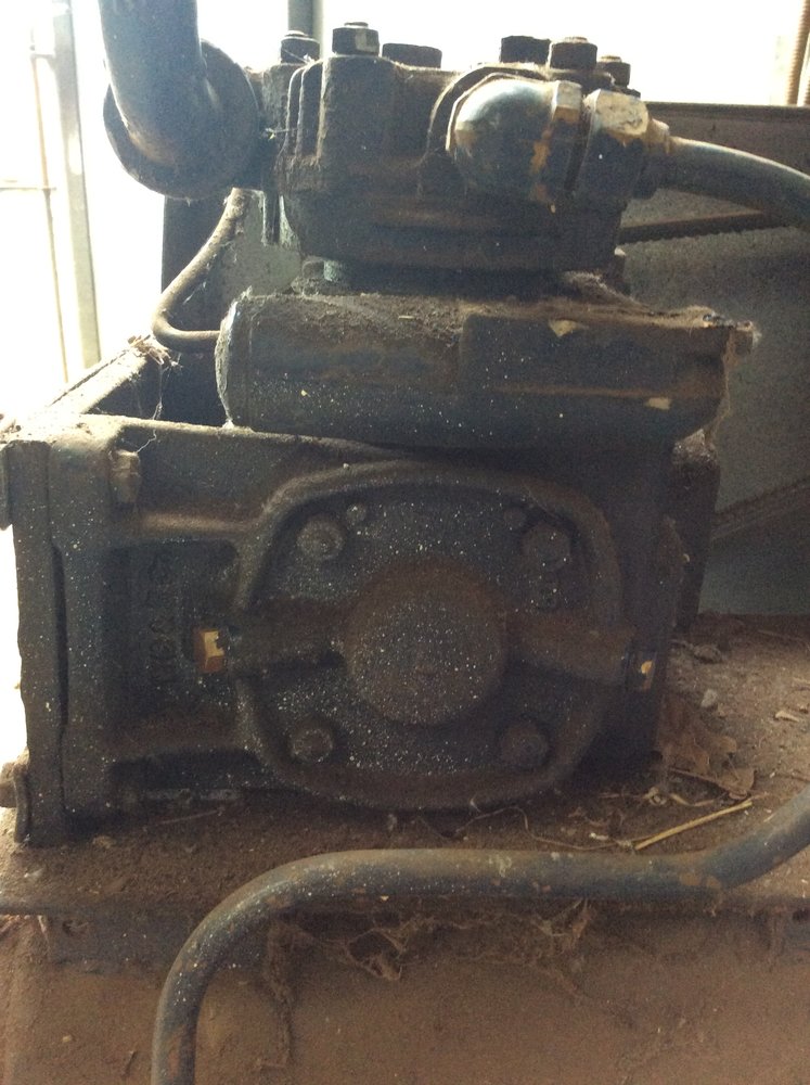

N nickk Member Messages 5,045 Location Hay-on-wye Apr 17, 2023 #1 Old Westinghouse,question is where’s the level and filler plug,can it be a combination one such as the two brass ones at 3&9 o’cloC.K. ?
frank horton V twins are great but 4"s rule......... Messages 3,852 Location Crete, Greece Apr 18, 2023 #2 yep, go for it....... all my comp pumps get synth D engine oil.....
dobbslc Member Messages 10,950 Location Hertfordshire UK Apr 18, 2023 #3 Could do with blowing all the crap out of the cooling fins! That must have been running hot
N nickk Member Messages 5,045 Location Hay-on-wye Apr 22, 2023 #4 My question was,where’s the level/fill plug?
James1979 Member Messages 8,438 Location Orkney Apr 22, 2023 #7 I didn’t comment as I don’t know but when i first saw the post I thought that the one on the left was drain, one on the right is fill. The pump is side mounted. There may not be a level plug. Mine has a glass. Some just use a dip like a car.
N nickk Member Messages 5,045 Location Hay-on-wye Apr 22, 2023 #8 Good observance,didn’t think of non original orientation. My two others have a sight glass.
James1979 Member Messages 8,438 Location Orkney Apr 22, 2023 #9 I just didn’t say anything as i didn’t know but that’s my educated guess. You may well find the glass under paint. From experience
