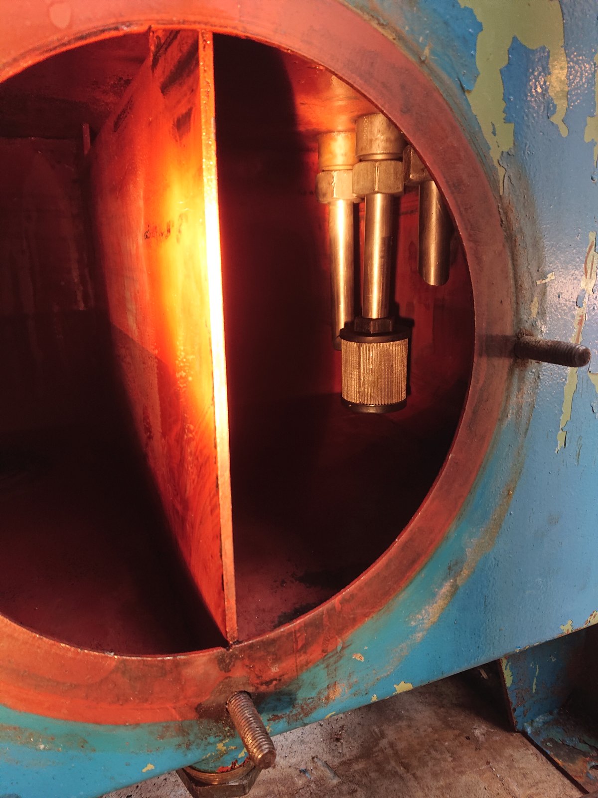

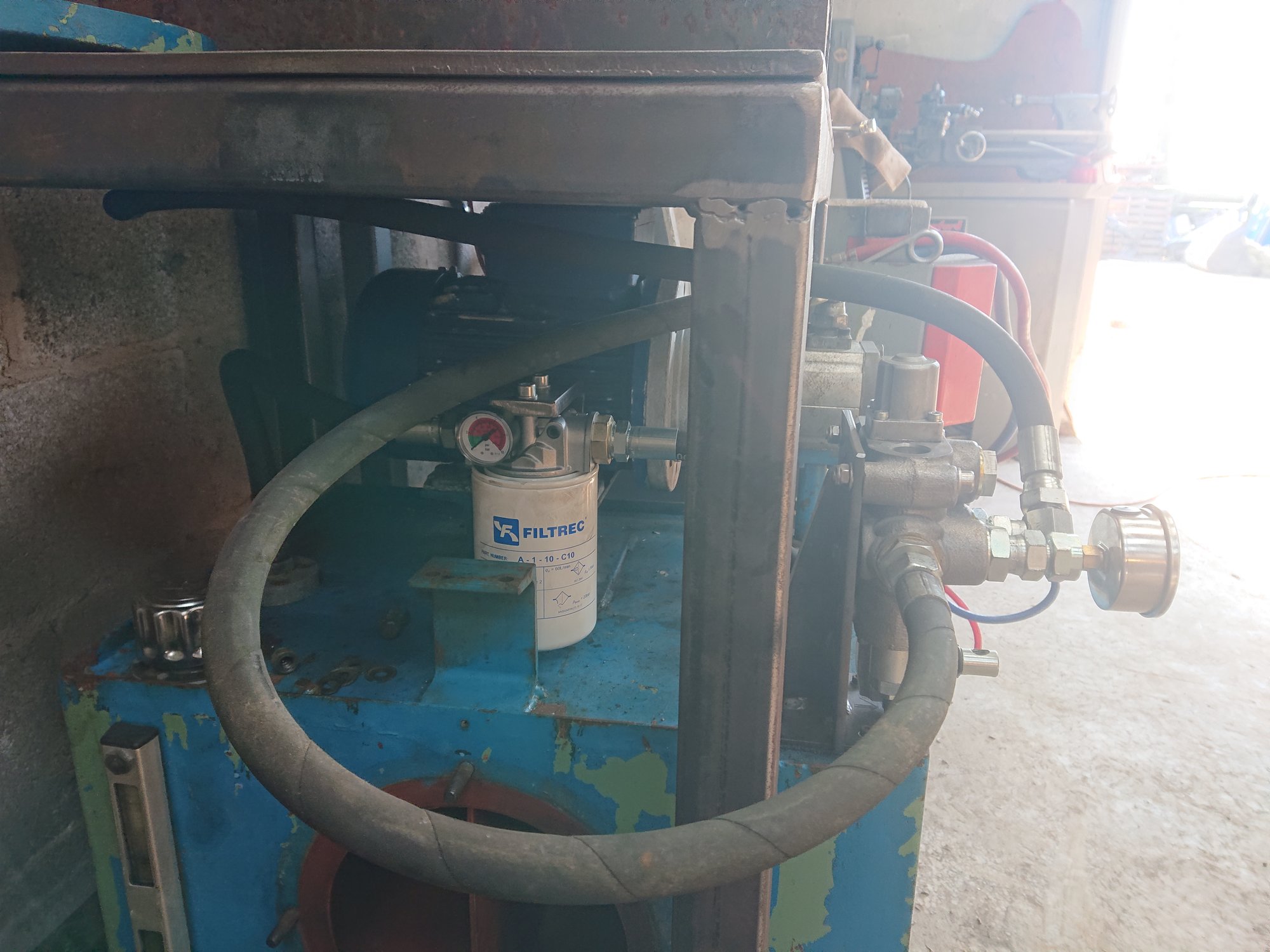

Well I've got 2 drums of iso46 sat in the workshop, a return line filter that was supposed to be here today but FedEx are useless and say they've been but we weren't in... (the Mrs was, all day!) And a suction strainer to fit when it turns up, just need to thread the end of the pipe 3/4"bsp.
Also drained and cleaned the tank out, not tok bad, a bit of grey sludge in the bottom but oil was clean.
Will post some pics once I've fit it all and made a new footpedal for the press.
