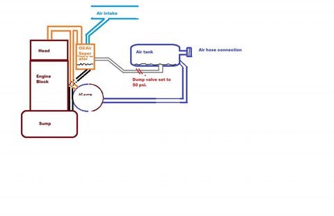

i m going to try the rocker breather
What engine?
The TD5 has a depression valve on the turbo to stop it pulling on the breather under boost, I’m guessing you would only use it at idle so that would give a decent amount of oil if it’s similar on yours
. Most of us make our own.
