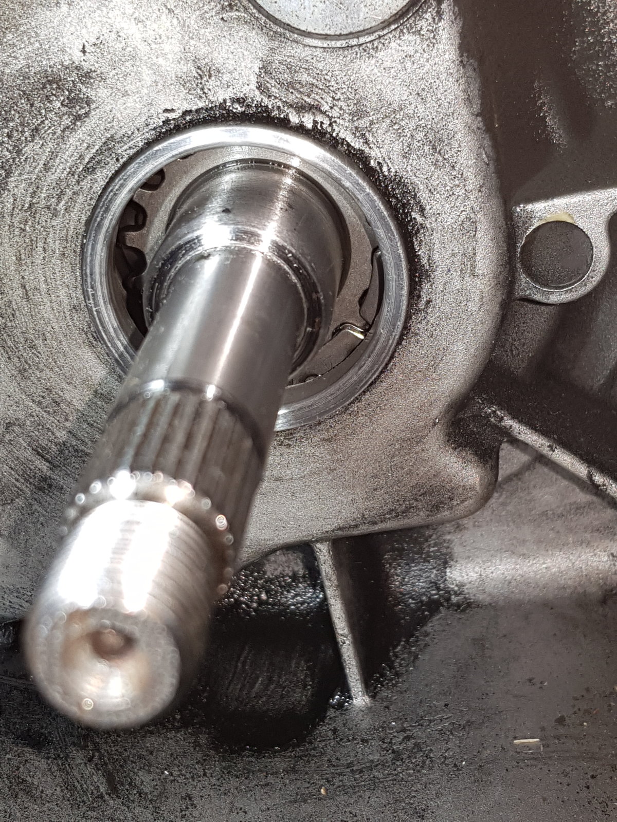

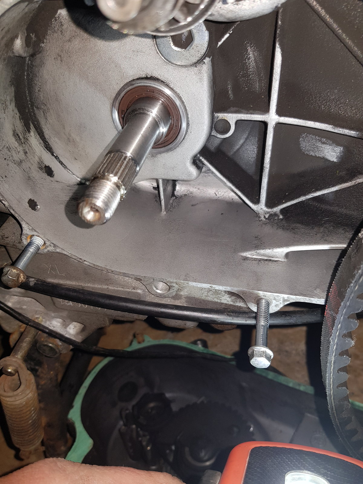

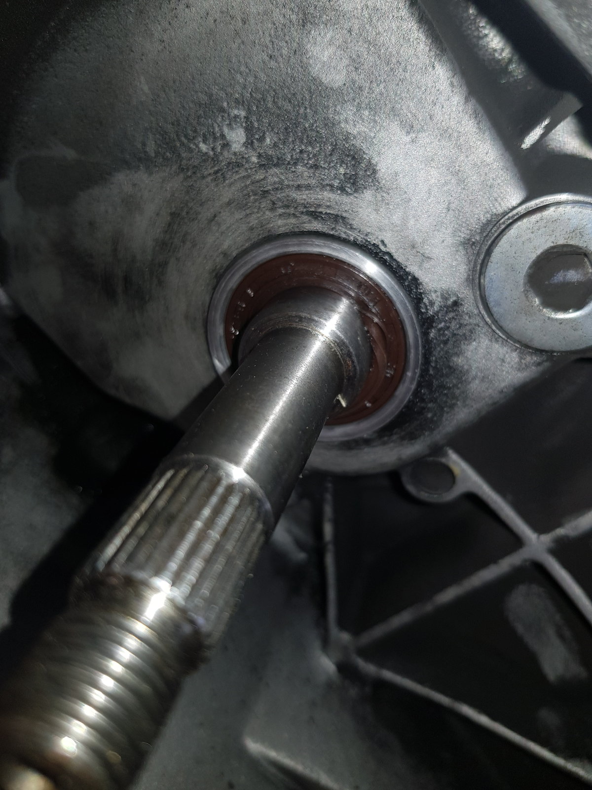

Ok a follow on from my son's bike gone bang thread we fixed it put all the bits back in the bike the bike runs well untill my son said dad is that oil
And after trying to find what was wrong as most of the oil was from near the clutch area removed the front cog to see this stupid mistake View attachment 170321 see the right hand side of the oil seal seams to be turned over can this be pushed back or changed with out a full dismantle ? (ADD HERE LOTS OF 4 LETTER WORDS NOT ALOWED ON THE FOURM )
Did the seal spring come out with it?
slather the outside of the cup in a bit of permissible grease slip it inside the seal and slide the seal over the well lubricated shaft .
