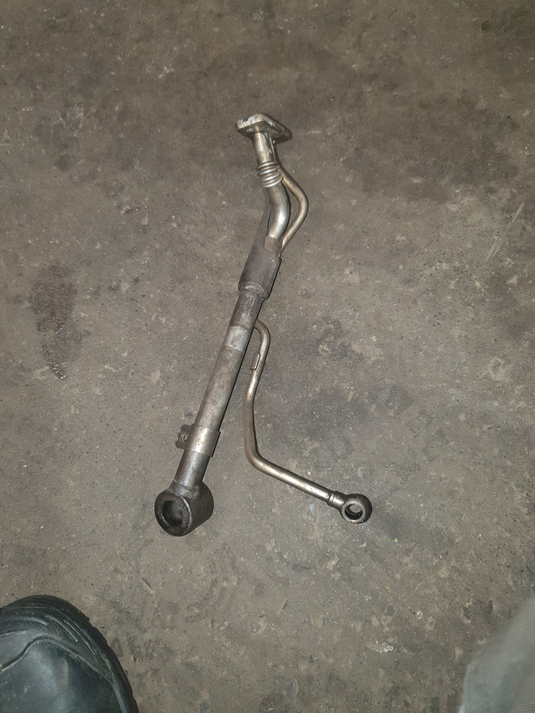

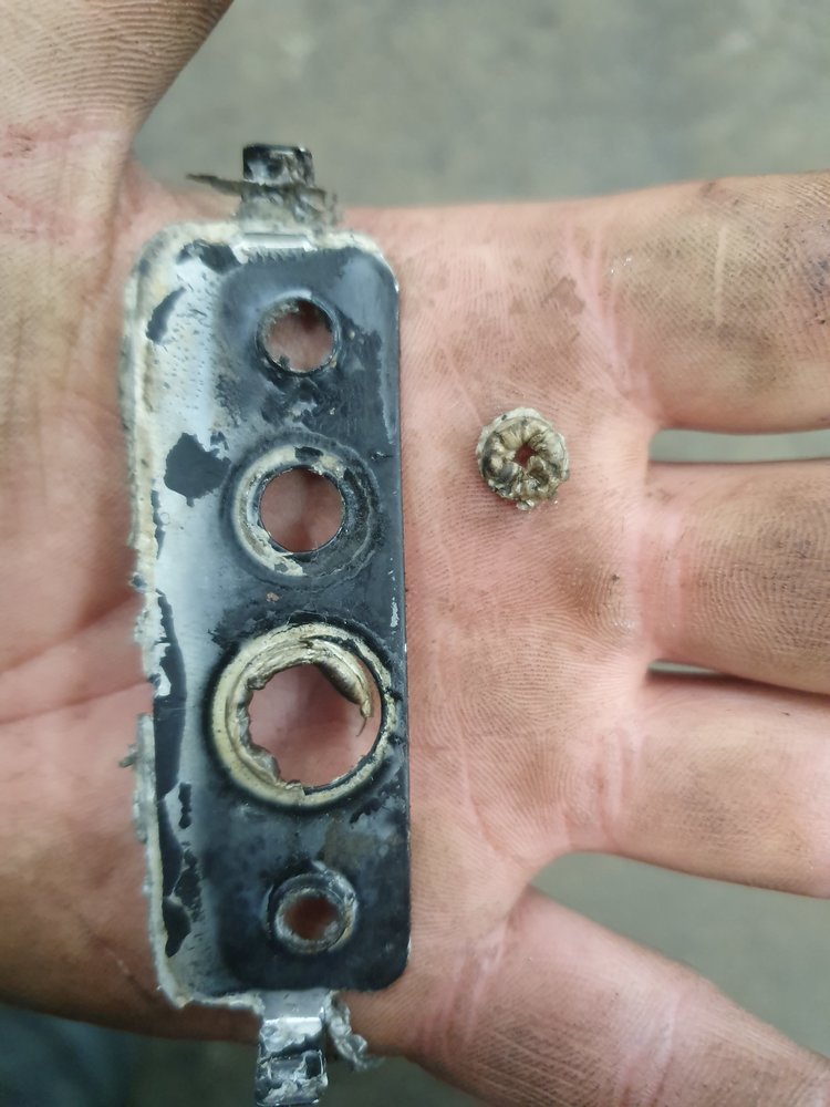

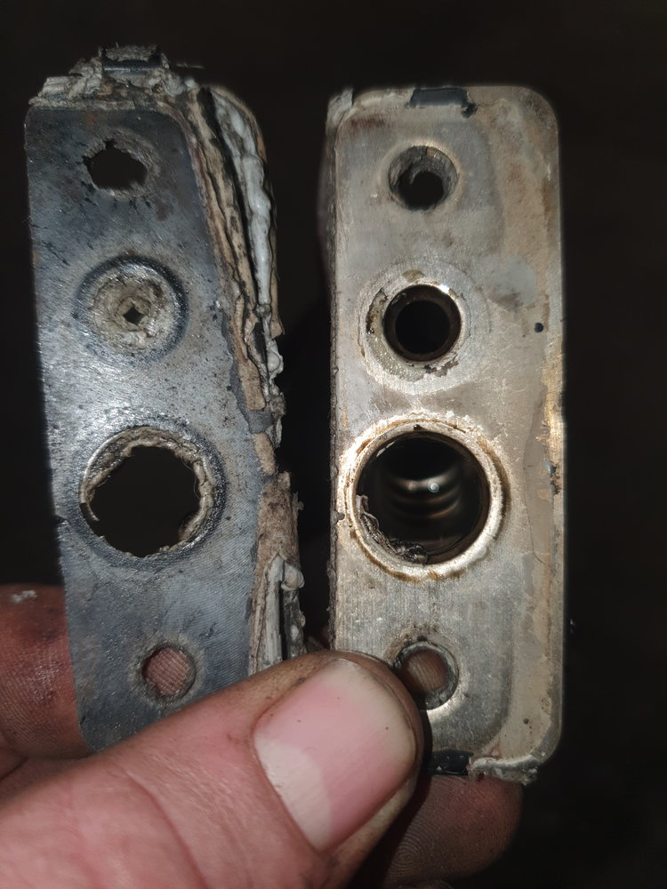

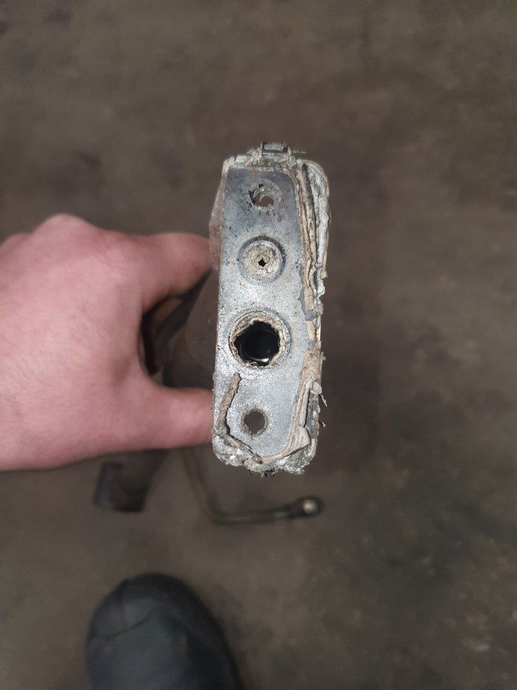

Numptyies huh. You know it will be over the strainer in the pick up alsoThis is a 1.6tdi golf, sump is being removed and cleaned, pick up pipe will be either replaced or given a clean before new turbo fitted. The turbo that came off is a very recent replacement so someone killed a few hundred quids worth of a new turbo for the sake of a gasket that costs less than fiver.
