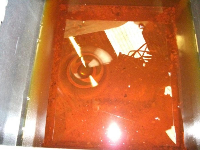

what is wrong with the oil thats in it has it been lost or contaminated ??burnt or water in it . the only settings are the amps marked on the switch dialHi could anyone tel me where i can purchase shell diala b ...oil for my rt180 oxford or a suitable replacement oil...ive had all the usual remarks scrap it its a dinsaur my old man has used this welder for years and now its mine i thought i would refurb it for the next generation to play with.Also does anyone know where i can find any info on these old tanks ie: settings oils etc
part lost due to being stored on its "side" dont ask its always somebody else's fault it must be about half full or empty ..what is wrong with the oil thats in it has it been lost or contaminated ??burnt or water in it
