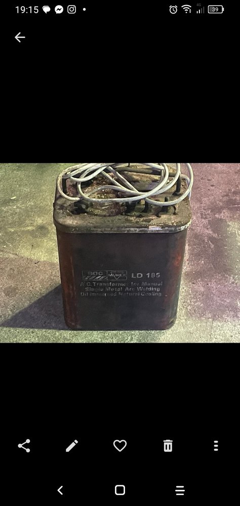

I have acquired an old boc murex ld185 oil cooled welder. The data label on the top of the machine is worn out. Does anyone have any pictures of one of these so I can figure out how to work it

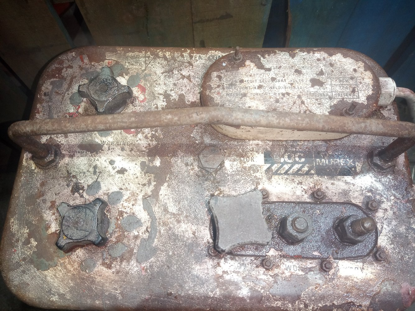

your terms look good so place it on a board for the first plug in an try it.....
u'll need to test for earth leakage etc but I'll bet it'll be ok....They made em proper.....

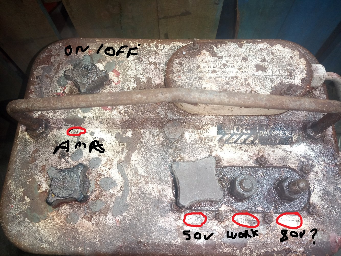

It'll be an AC welder, you can see the terminals are labelled (just) if you look, an amp clamp would provide info on output amps if you require but stick a rod on and burn is the best way.
