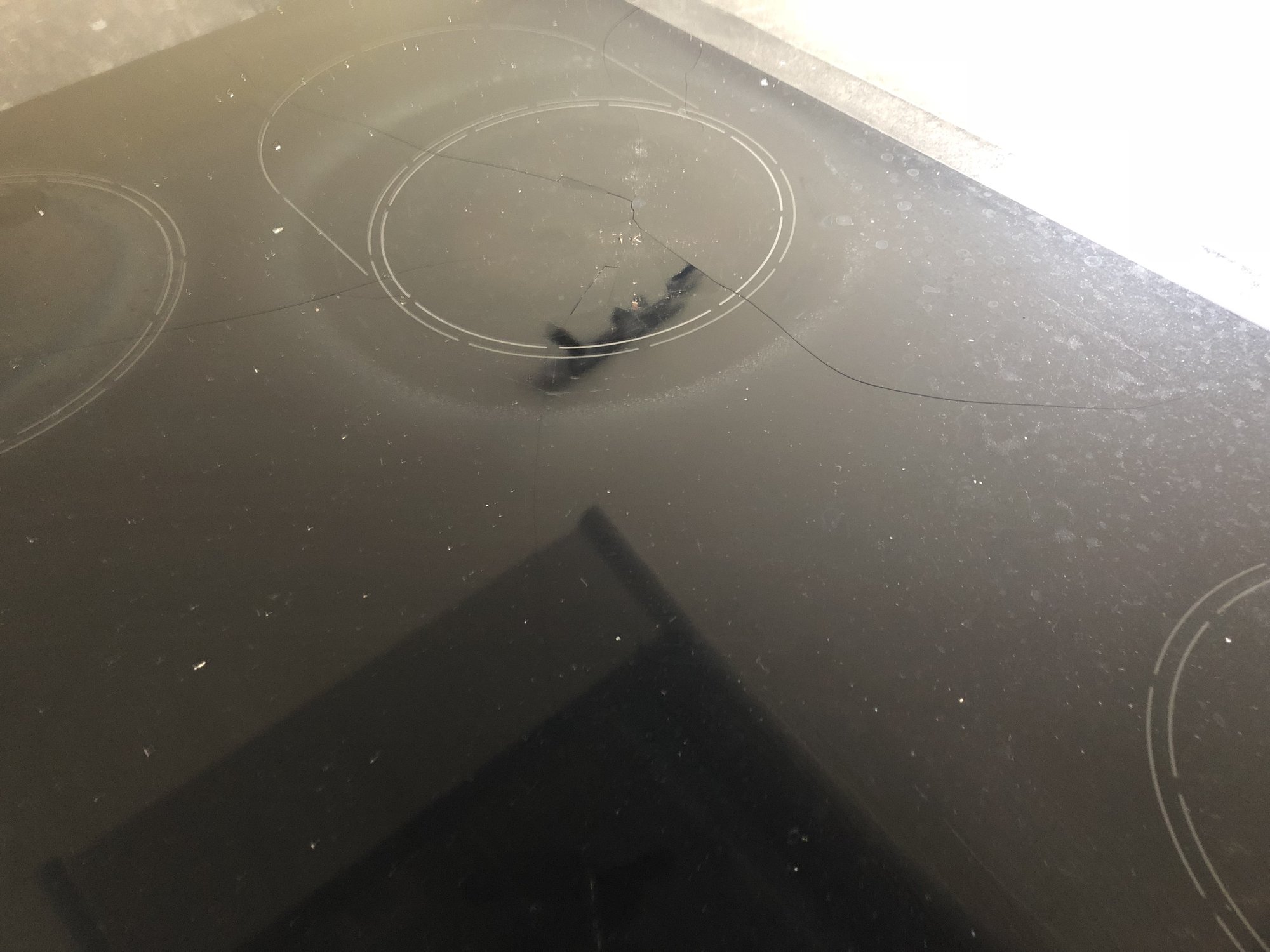

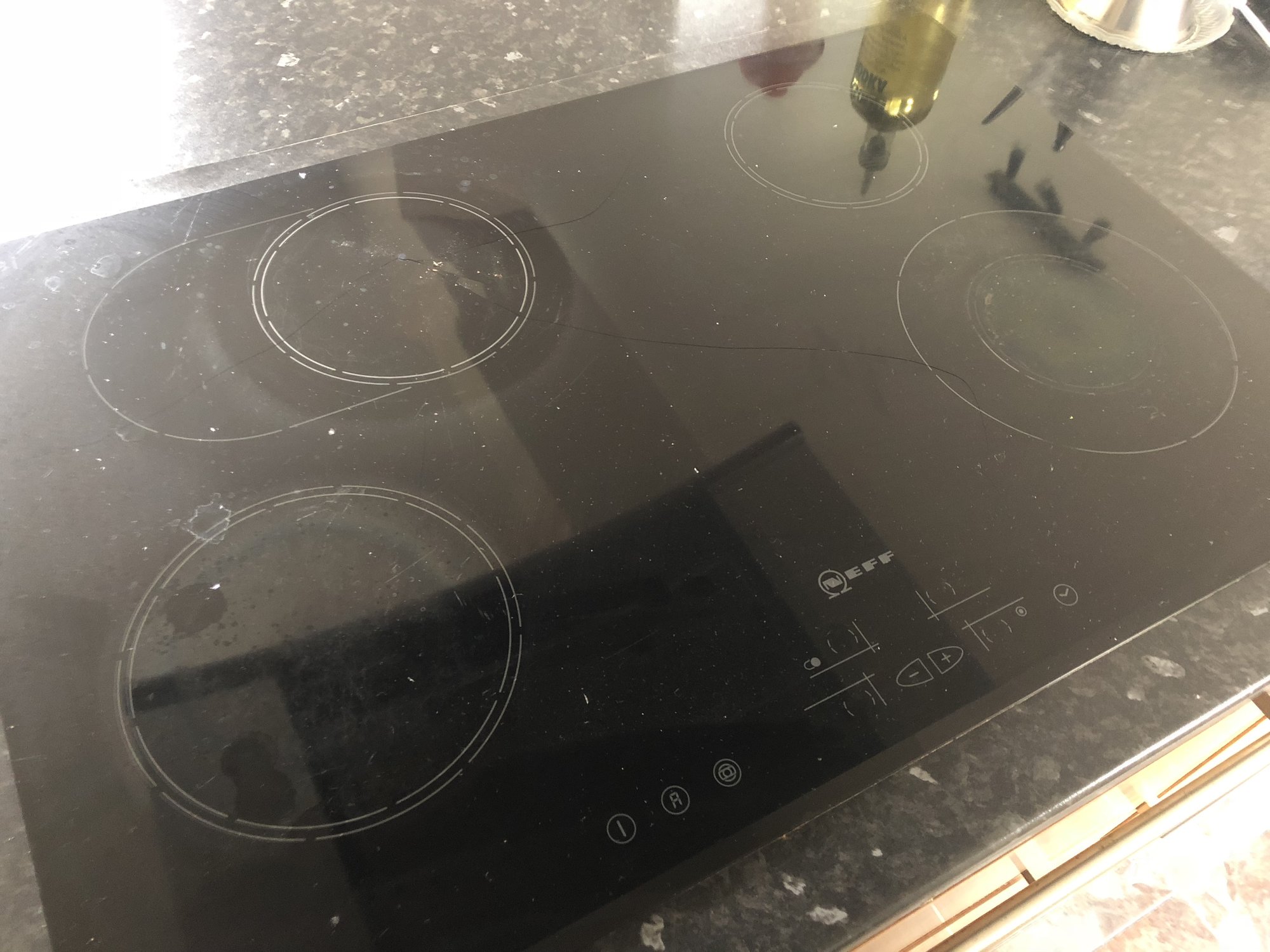

Part way through cooking the stove top threw a wobbly
Top left section has melted and cracks all over
This model isn’t made anymore. The replacement is 30mm bigger

Yep, but this happened with a regular light weight stainless steel panDo you use cast iron pots?
Have you got a router with bushings for a worktop jig?Ok, currently the cut out sits just inside the side frame. New one will require the wide of the side frames to accommodate. No way to cut out from below.
The cut will be directly above the side frame so nowhere for the blade to go, hence my idea of the router
If so make a jig up 9mm bigger every side from 12mm mdf/ply.
Free handing into the corners is hairy.
