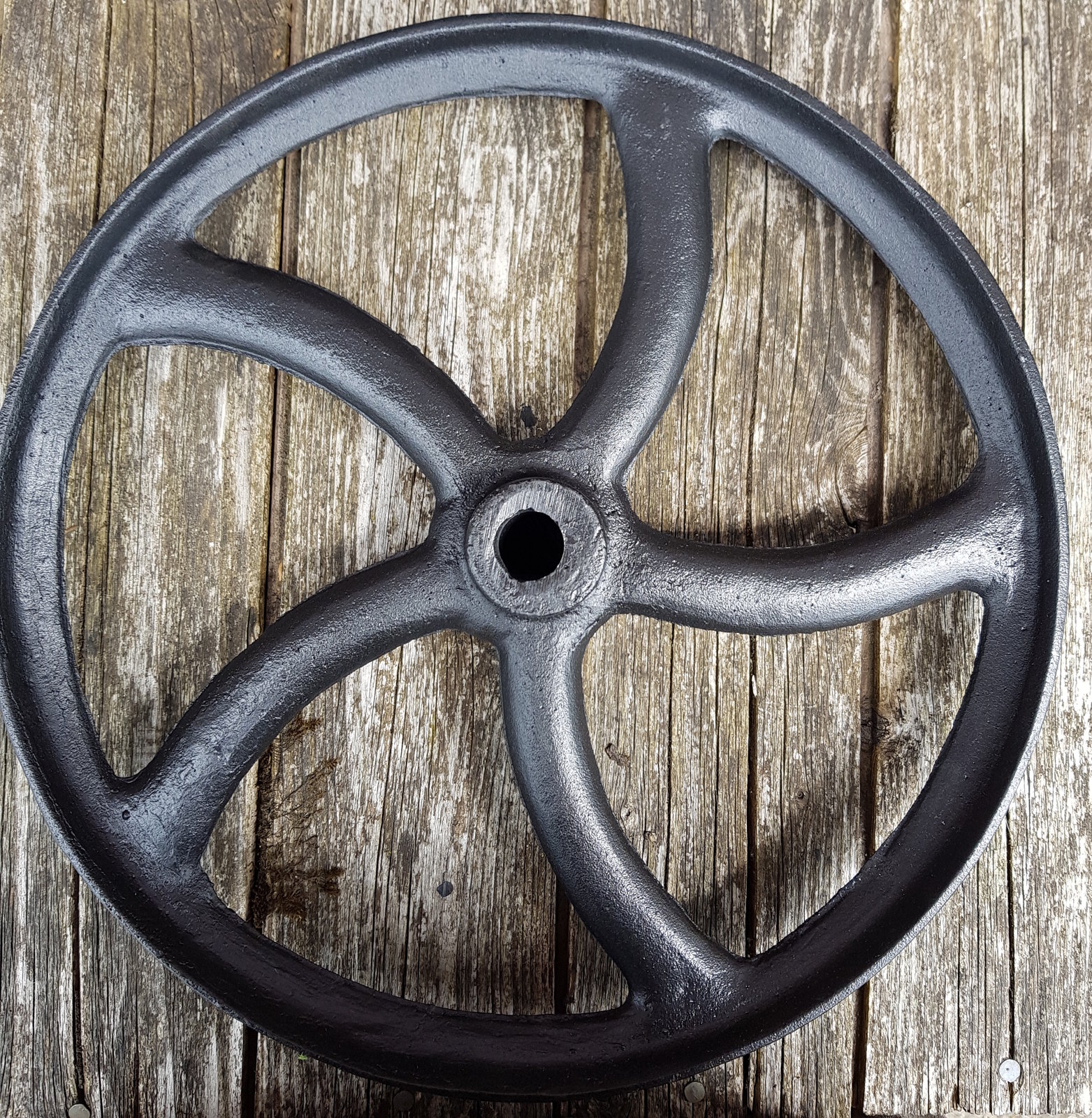

It ought to have been someone else doing that - it was your birthday, after all. Wheels came from here https://www.ebay.co.uk/itm/282073664531
The castings are pretty rough to be honest - check out the accuracy of the holes! I was planning to bore and sleeve them, but it's not going to be moving very far, so might just live with it..
Thanks bud. I see what you mean about the axle holes, a tad eccentric one might say!
I thought about it after my post and realised that I've got several gas cylinder of various sizes down the side of the house, so my plan is to slice two rings out of a small-ish one and then cut two triangles/triangular star-shapes per wheel out of flat steel sheet to make the wheel centres. A piece of suitable-sized tube for an axle and jobs a good 'un. All I need now is to get on and do it![]()

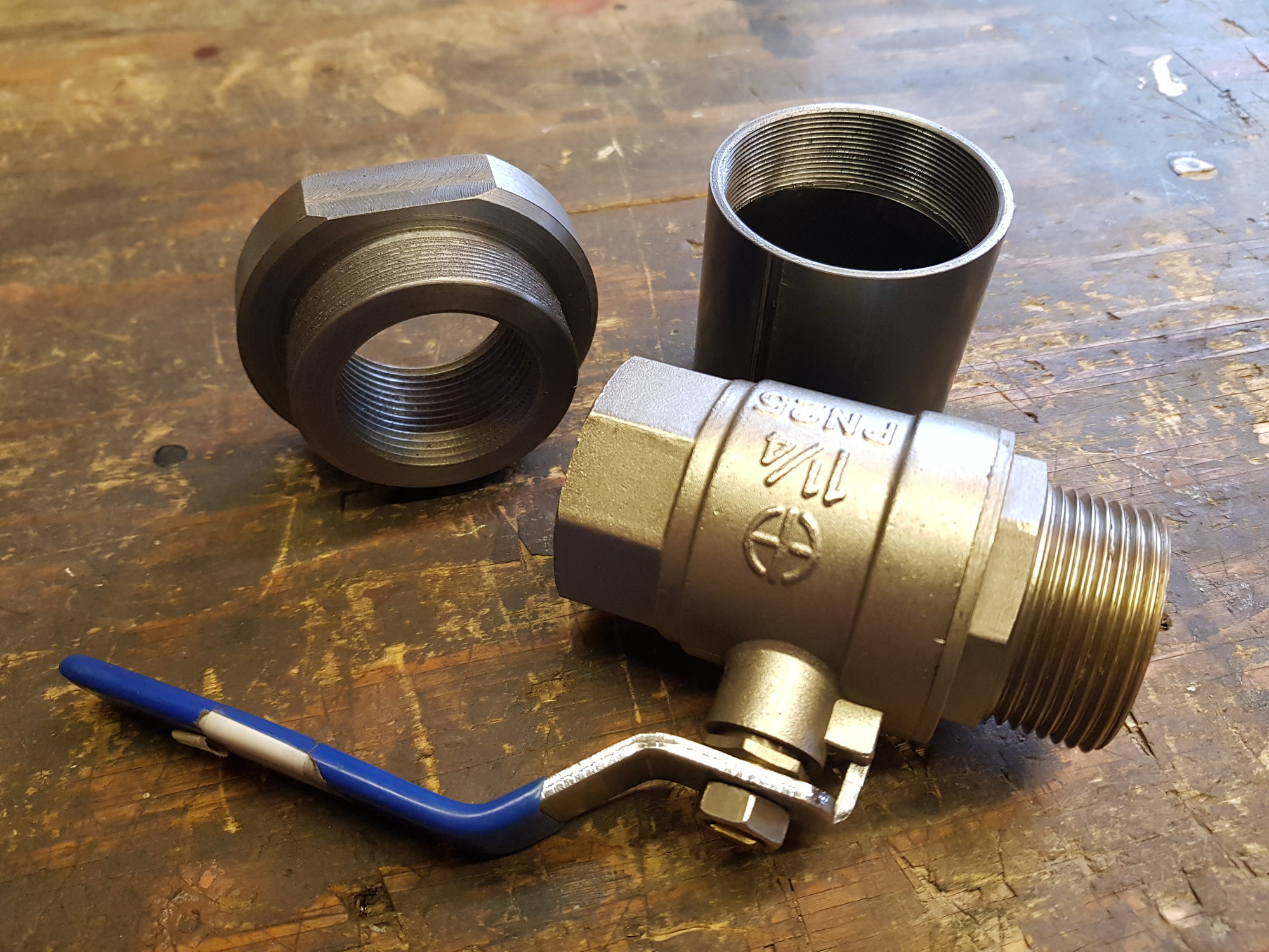

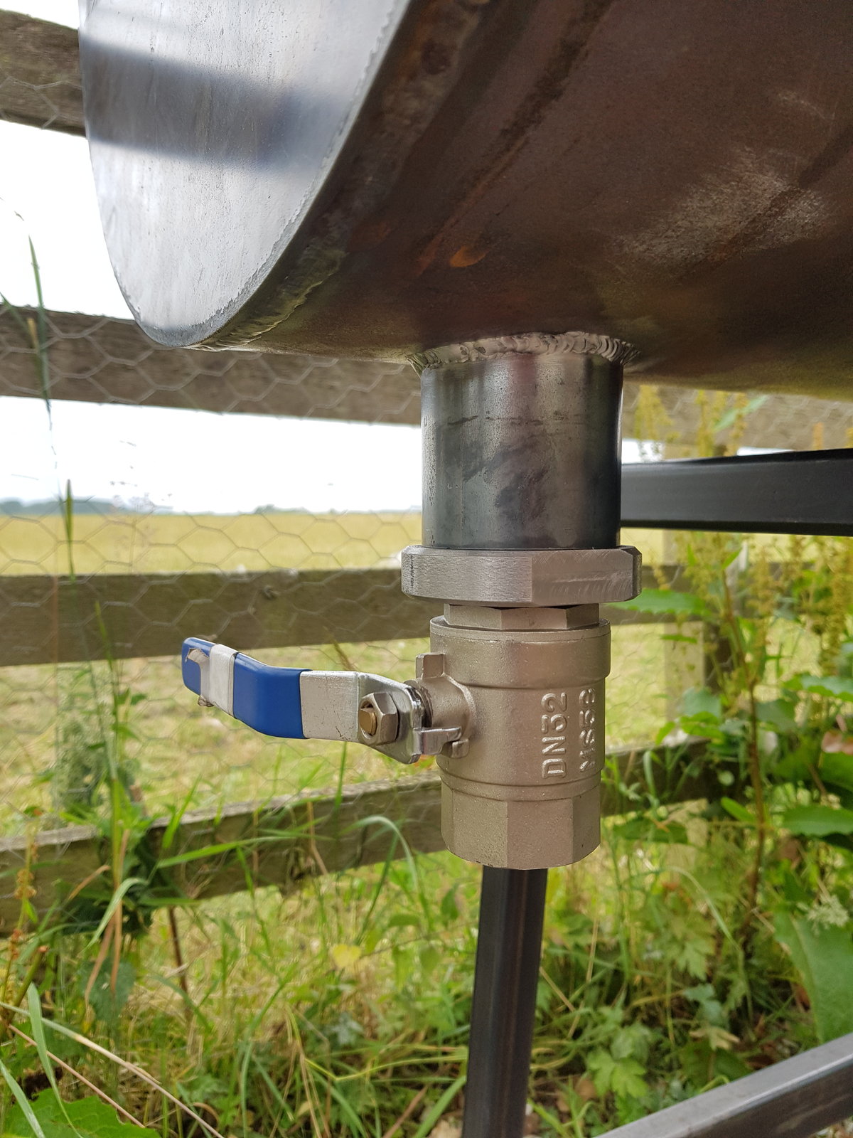

Will be the second outing for the smoker this weekend, so have added something to assist with the cleaning afterwards (was the least fun part of the first use!). A short section of 60mm pipe, with a threaded boss and ball valve on the end.
Taking on-board the advice from @gaz1, am hoping this will give me the best of both worlds, as I can just crack the valve open while its hot to drain, and unscrew as needed for scraping out. The welding is not my best (could not seem to find a good position under there), but don't think it'll be going anywhere..
