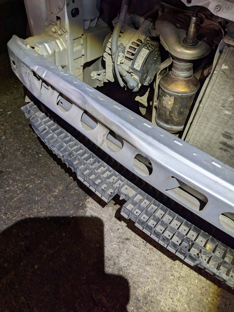

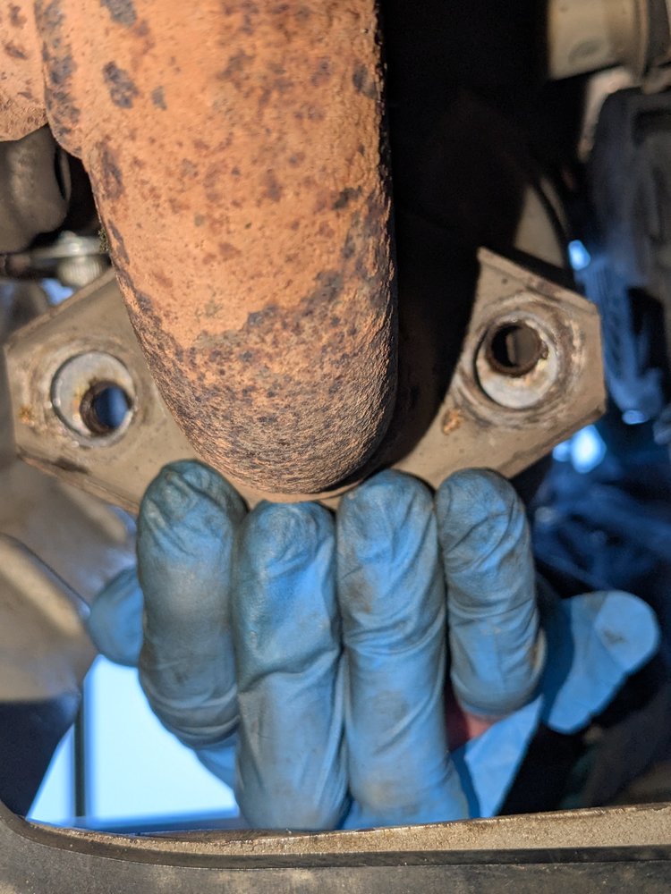

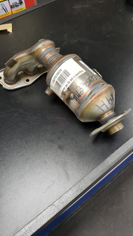

I've realised the plugs and air filter should have been changed 10k miles ago so they've now been ordered, the plug gaps was too big but they were a nice clean light biscuit colour so at least not covered in oil, I doubt that's causing the fault though. The cat is part of the exhaust manifold on this car so any advice for getting the bolts out in one piece?
