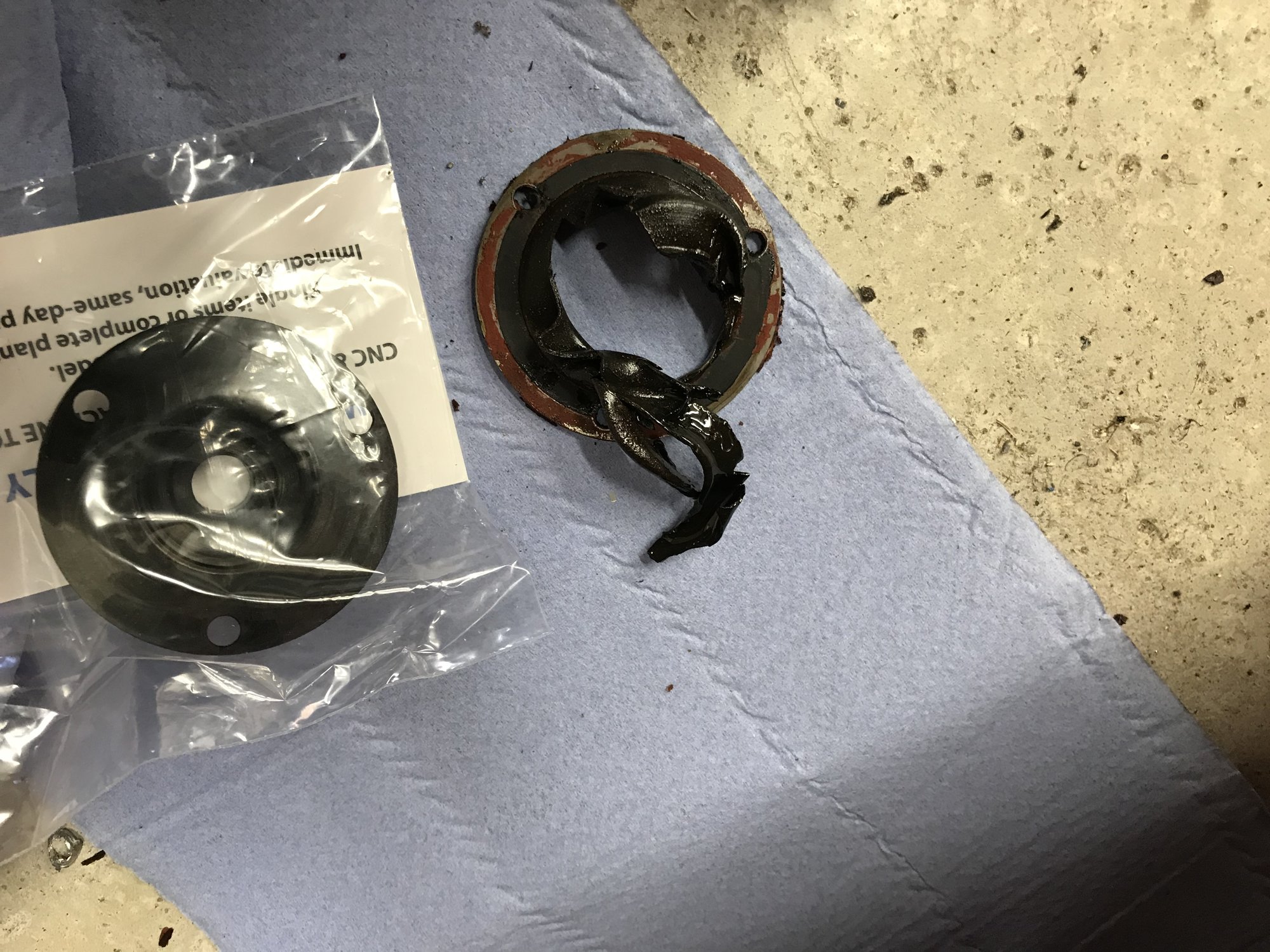

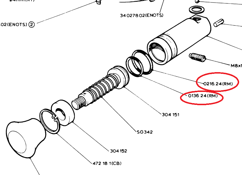

Found 1 out of 2 apron oil leaks. There's two o rings, O ring 0216 24 (RM) has been taken out at some time in history and the other o ring is a bit flat and past it.
I've been loosing the ends of my fingers with a selection box of various o rings trying to get them to fit.
The o rings fit over the shaft fine, and look to match the one that is there, but when I gently try putting the shaft back in the hole it just scalps the o rings and makes me swear.
I've oiled the o rings and being careful putting them back in... i know the script on how to fit them.
It doesn't help that there is a snap ring groove machined right on the lip of the sleeve.
Harrison M300...what is the actual size of the o rings that should be in there - there's nothing that seems to refer Harrison's code to a standard O ring size. It's evidently a common problem though.
