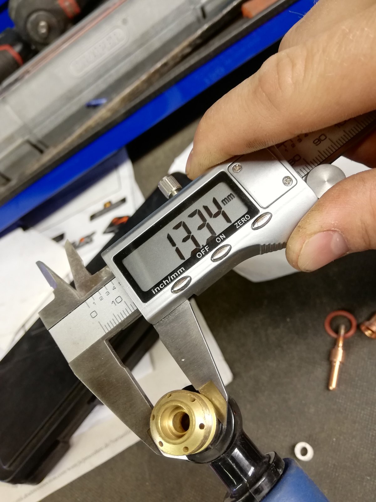

Divingdad Forum Supporter Messages 112 Location UK Northampton Jul 1, 2020 #1 As in the title, I am trying to obtain o ring size for my PT-31 plasma torch. Anyone point me to details or a supplier?

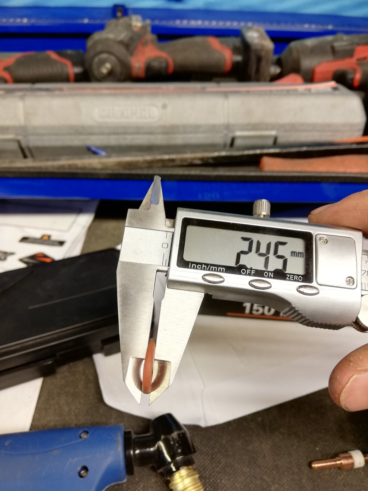

pondy Member Messages 1,627 Location chedburgh, suffolk. uk Jul 1, 2020 #4 I'm going into the garage shortly once I get the kids to bed. I'll sort pics unless someone beats me to it

Divingdad Forum Supporter Messages 112 Location UK Northampton Jul 4, 2020 #7 Many thanks ponds that’s exactly what I needed to know.

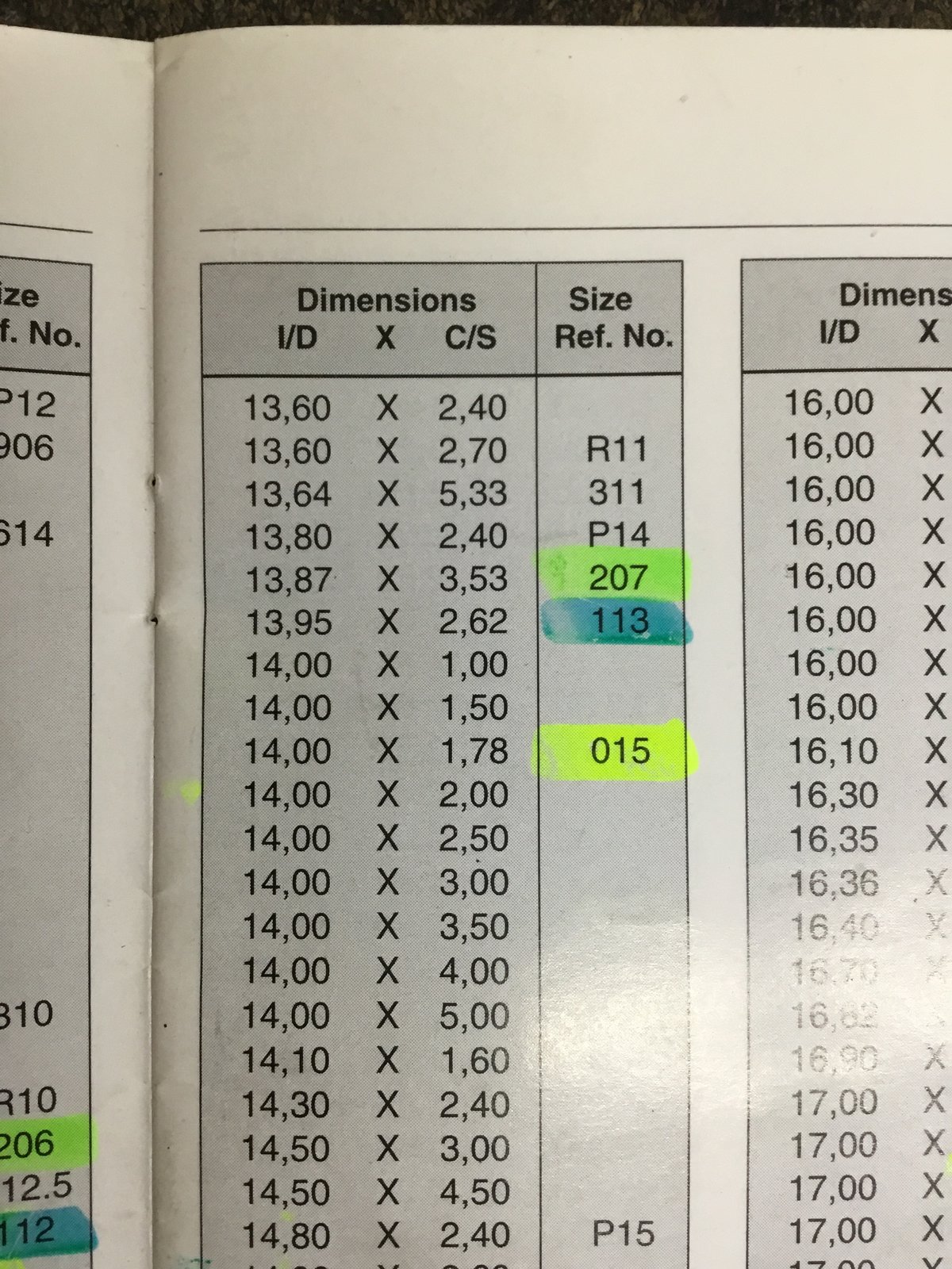

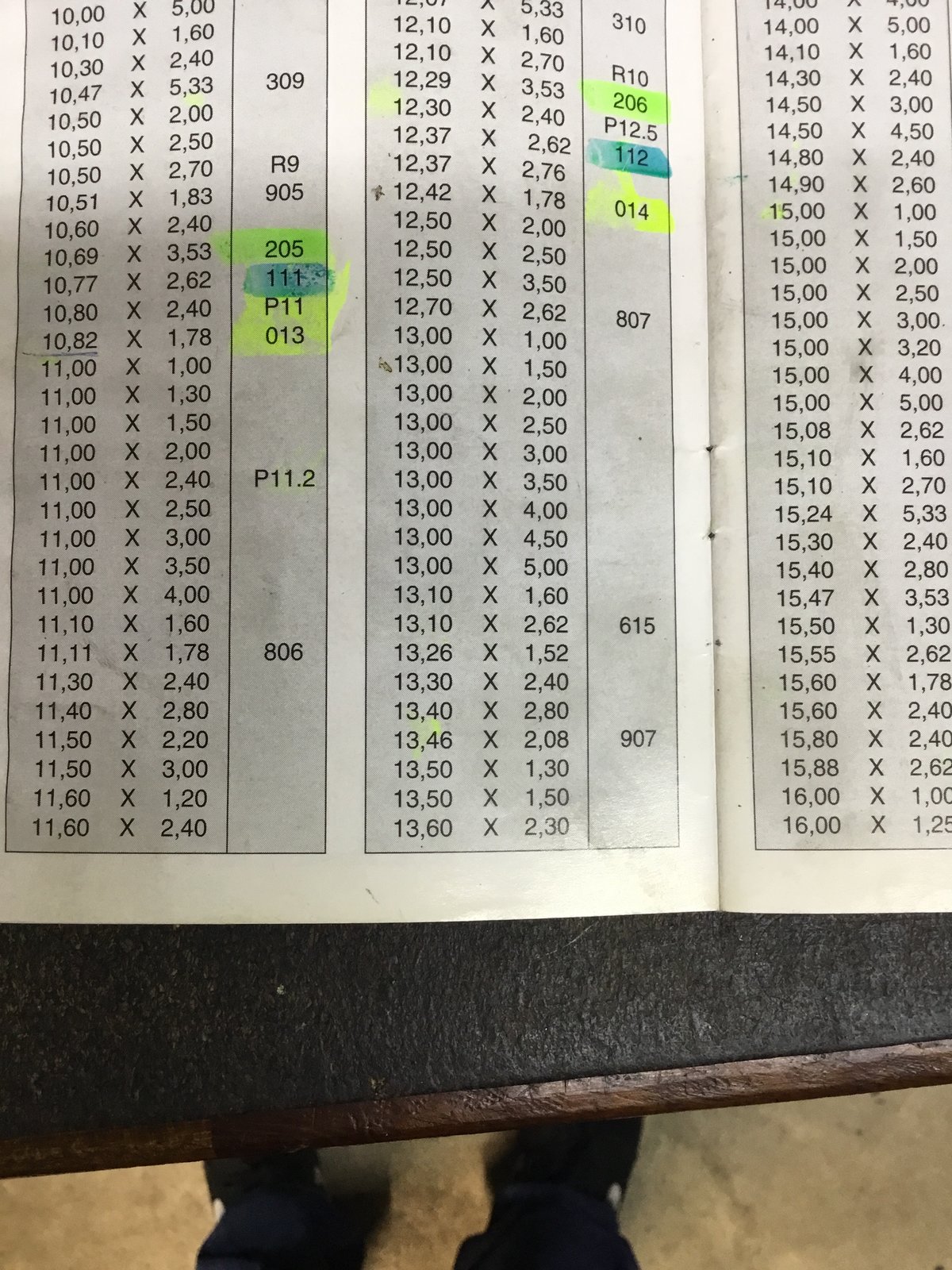

Shox Dr Chief Engineer to Carlos Fandango Messages 17,986 Location East Yorkshire Jul 4, 2020 #8 pondy said: View attachment 239424 View attachment 239425 Click to expand... Looks to be a metric size. There is no BS... size. Possibly 13.3x2.4. 13.95x2.62 is the closest BS size - BS113.
