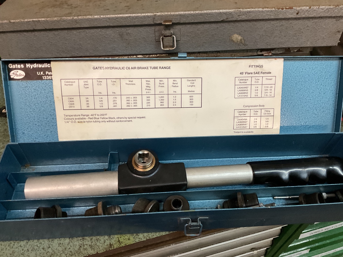

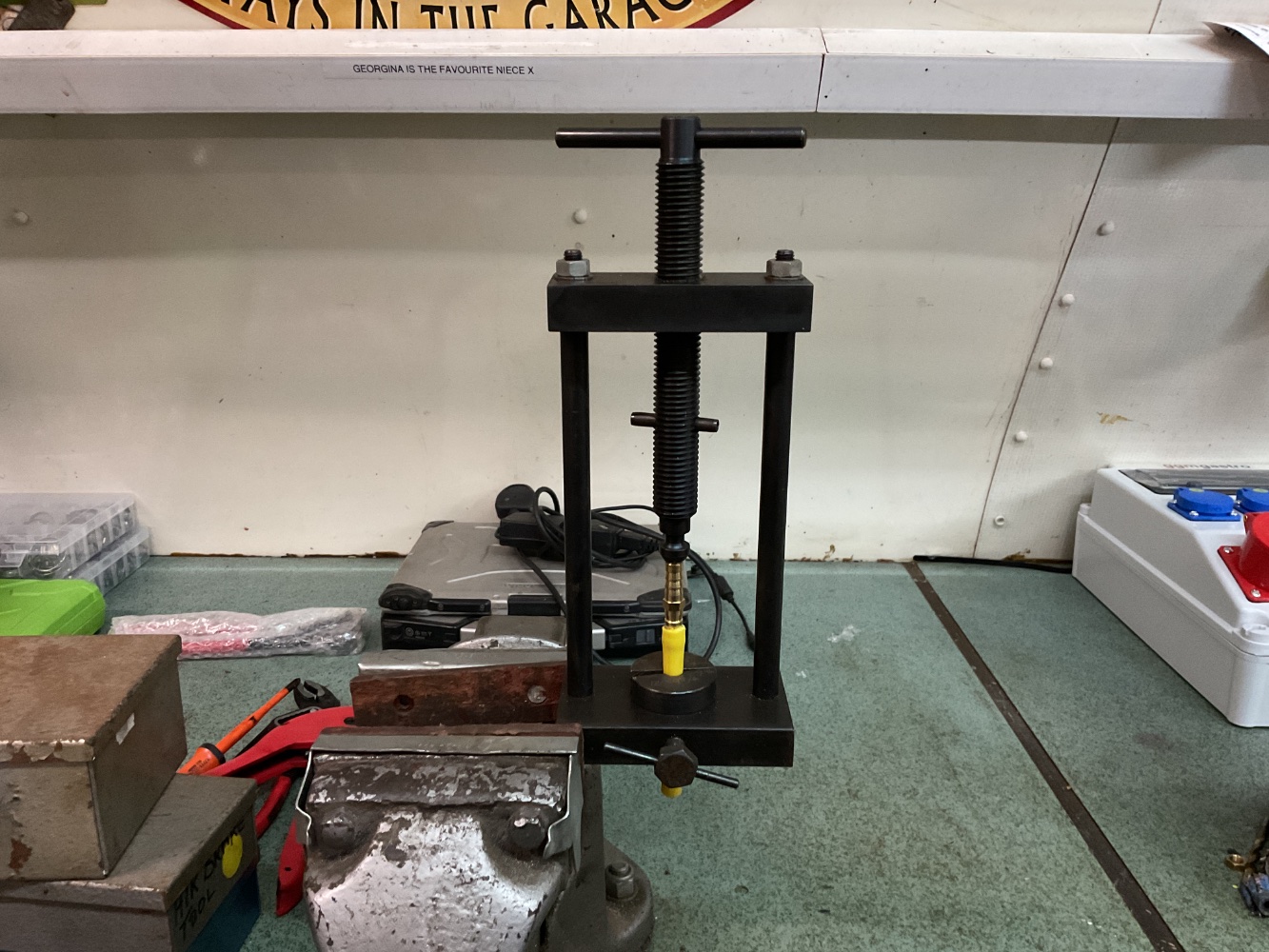

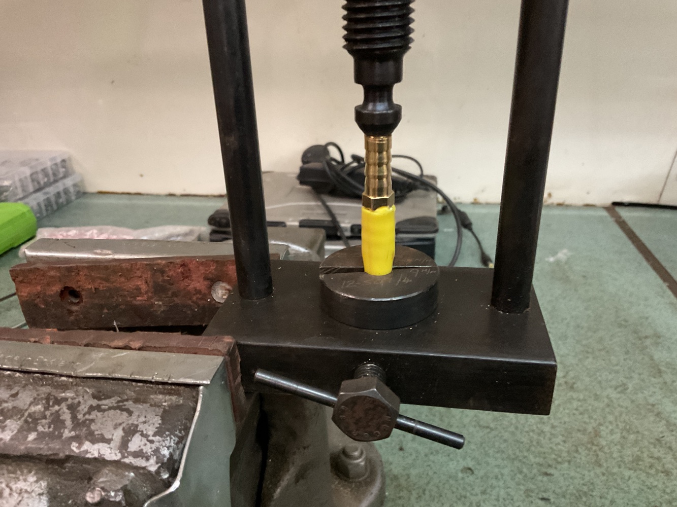

I’m re doing the line on one of my old opels.
Using nylon. But for the life of me I can’t recall what I’ve used in the past to connect the plastic hardline to the rubber hoses of fuel rails and tank etc.
I’m sure I had to use a special tool to insert into the nylon line.
Any experts appreciate your help as I don’t like the copper line solution (have gone brittle on this car from previous owner)
