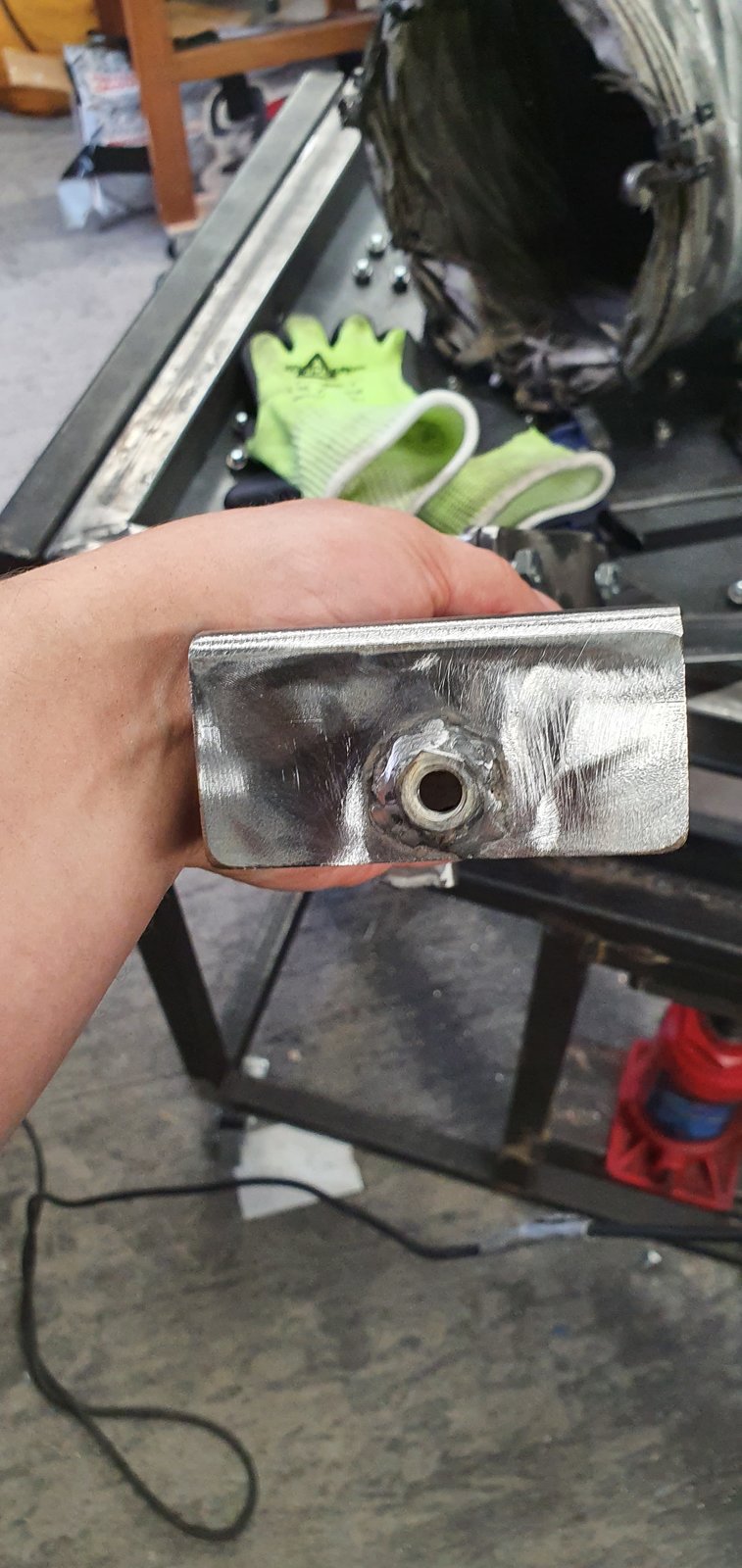

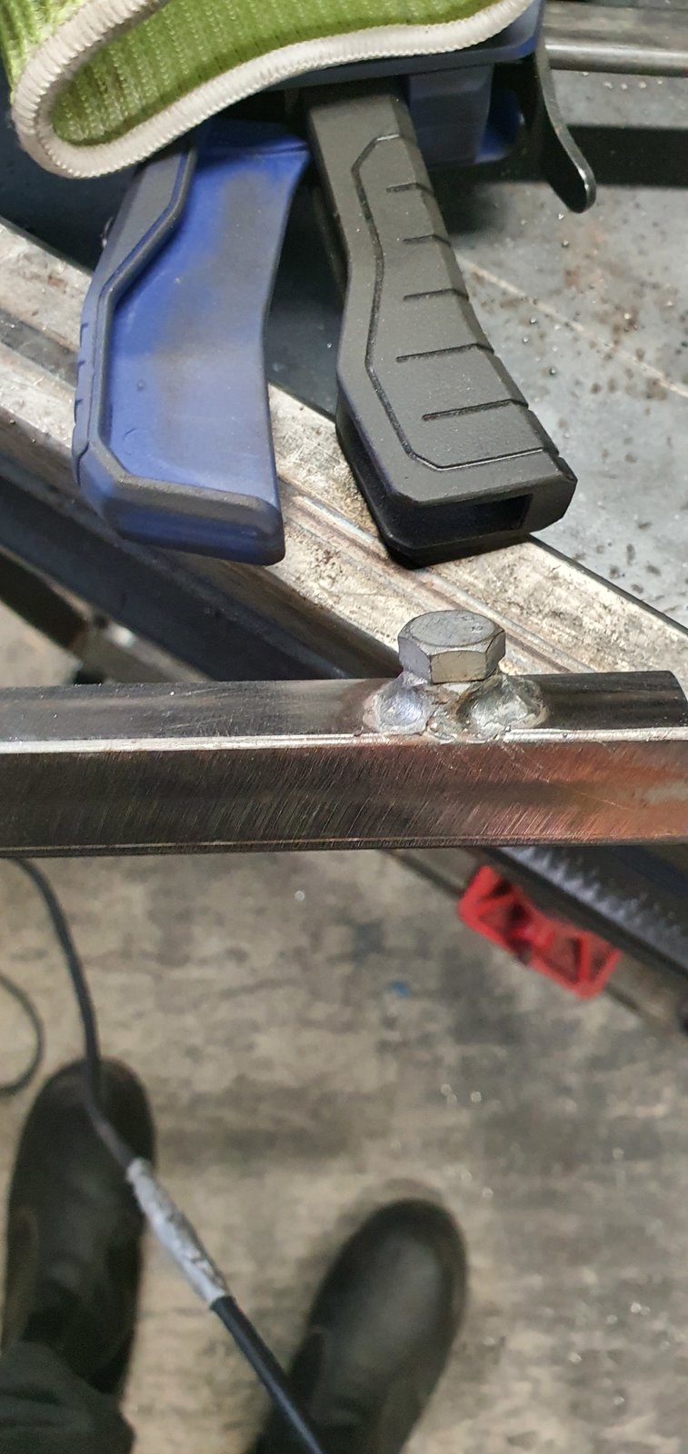

  8. Tombodge Member
    Messages:
    111
    Location:
    UK midlands
    Here is where i need to use them. Its 3/4 1.2mm box. 1/2" box goes inside the 3/4.
    The other is a 40x40x40 U channel
    M8 nuts.
    Thanks for the help
