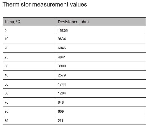

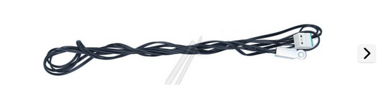

Hello all, one for the electronickryists. We have an ageing ISE10 washing machine that has sailed past it's 10 year guararantee without issue! But now it's attention seeking. It doesn't seem to be heating the water.
The heating element seems to test out ok, but the tempreture sensor thermistor does not, I'm getting a resistance of 60 ohms, the book lists it at 6.1 to 3.8 K Ohms ( this is definitely a teeny bit of knowledge is dangerous situation, but that goes for most of what I do).
It's an Asko part that seems to have a six week lead time on it, so I was wondering if it's possible to substitute a thermistor of similar values. It's simply held against the outside of the drum so the simplest of bodging can sort the mounting, it's the numbers I can't deal with. I was wondering if anyone can guide me , tell me if it's even possible if only for a temporary bodge/ experiment? I (think)I have attached a pic of the part and the asko manuals resistance values for the thermistor.
Thanks, Ed
