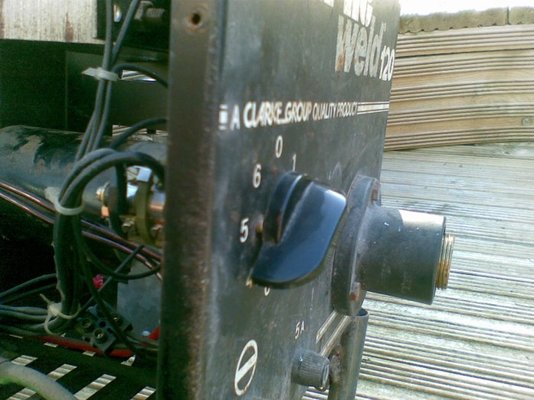

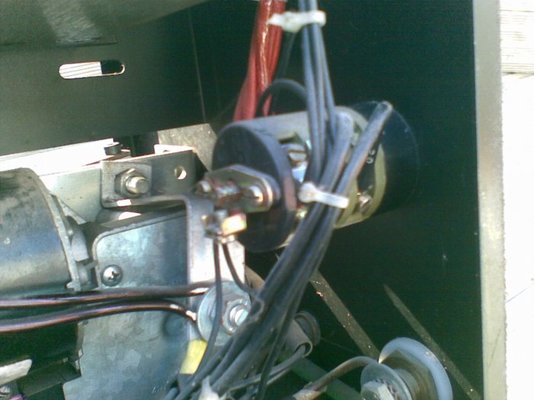

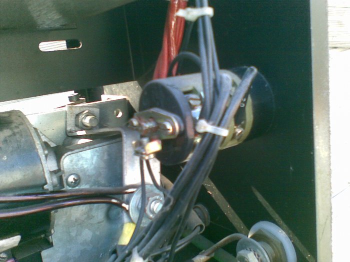

(mine) because I had similar probs with mine a while back. So took knob off, removed two screws that secure switch asy to m/c and generally cleaned and sprayed with silicon spray. Avoid wd40 because if there are any cracks or brittleness to the plastic that makes up the switch it will chase the crack and cause the plastic to fall apart
