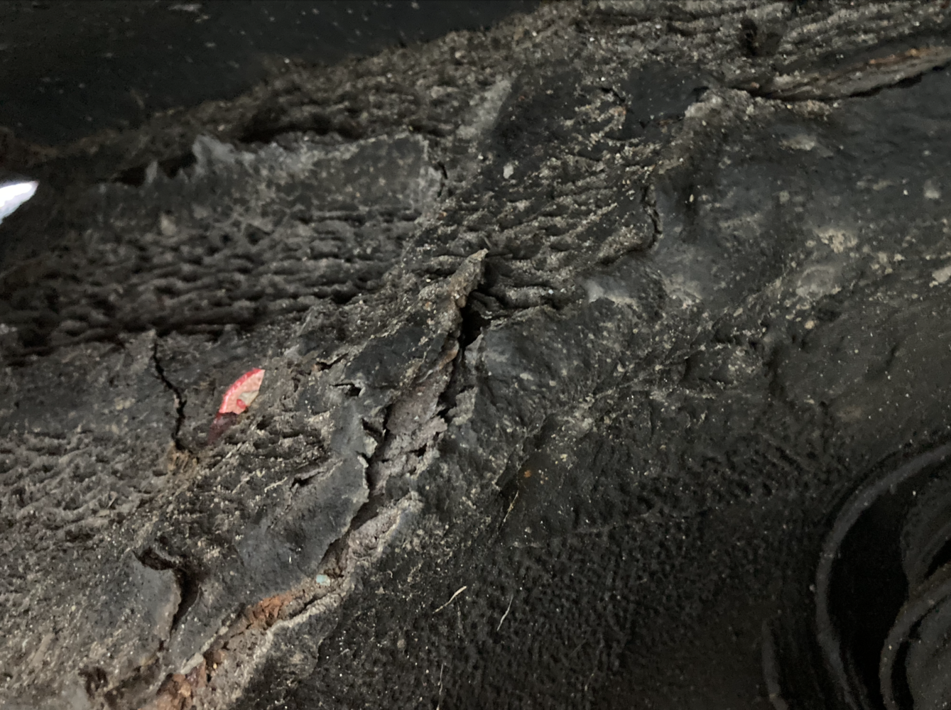

This is the inner wing passenger side. I know you can get these panels and was told by a welder he would try and leave the outer wing alone and just replace the panel from the inside?

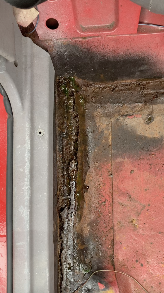

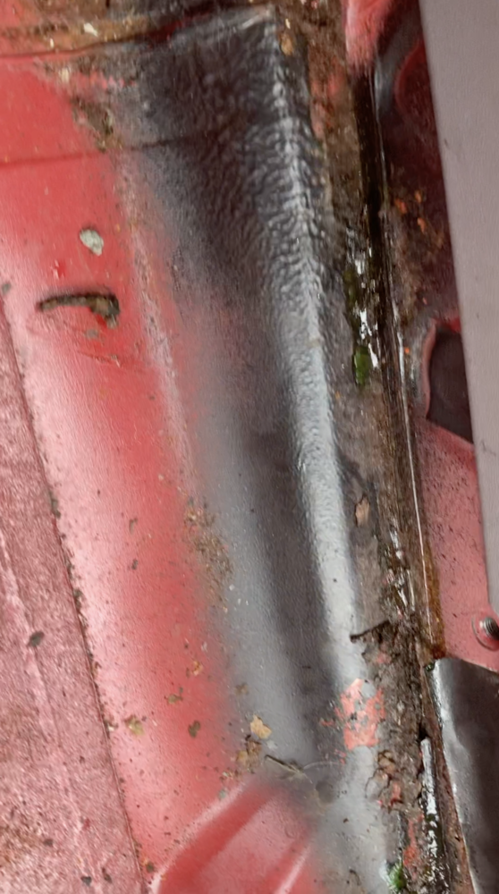

I coated the floor with some Krust stuff earlier this year just to try and give me a few more months . I think its had half floors in before as those seems run down the floor.

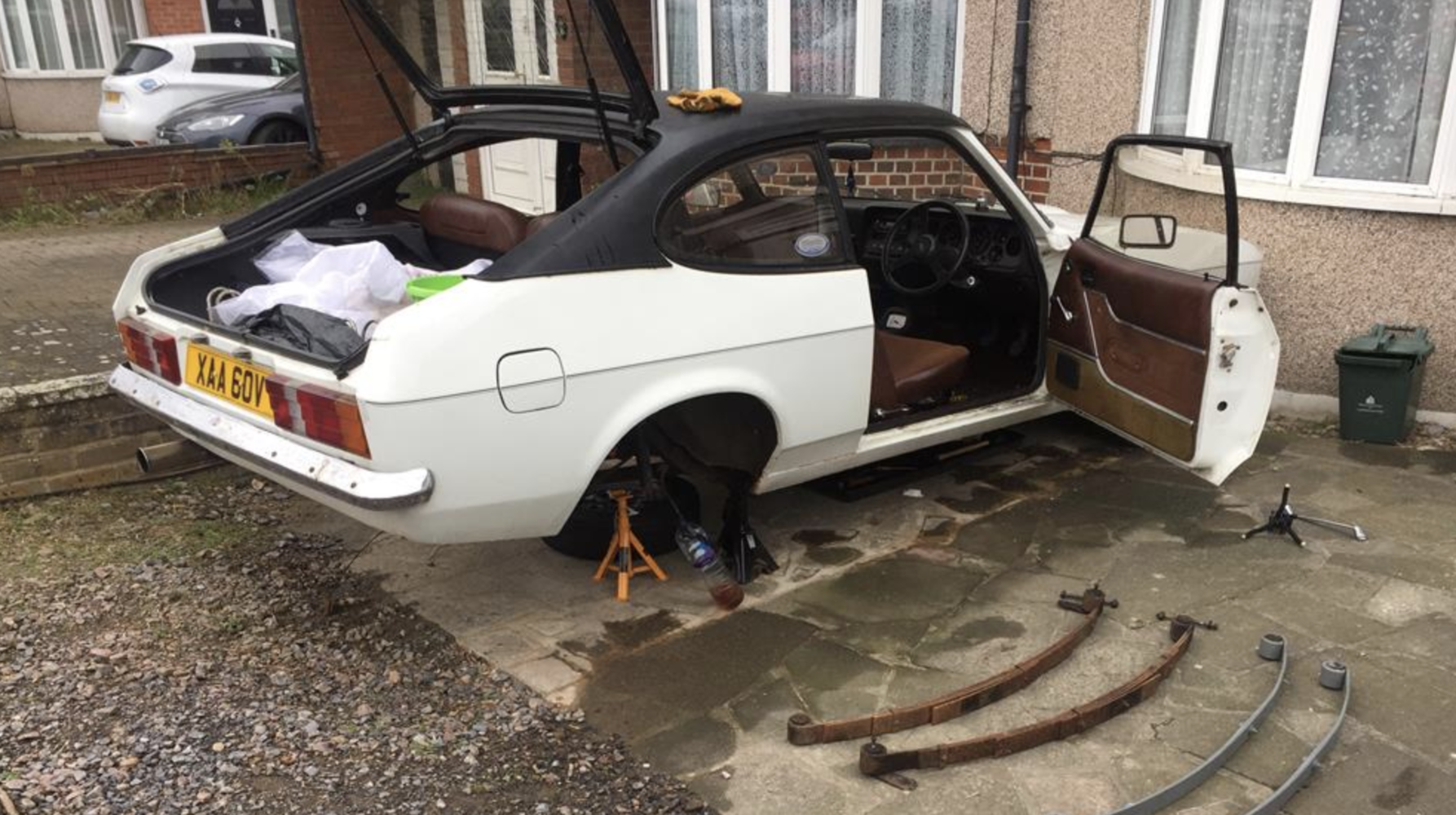

Again space wise, this is when I did a load on my Capri's axle. The Escort Lives next to it where the leaf springs are.

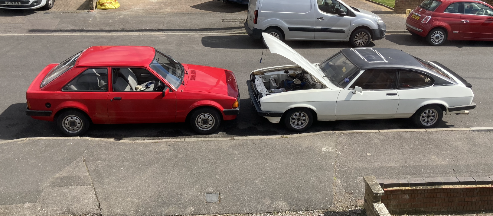

Both Cars in there full glory...The bonnet is always up on the Capri haha.
