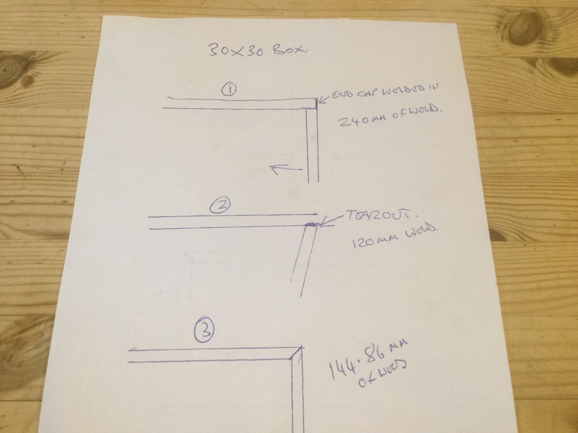

Not 100% sure, I think there are advantages in mitres. The way I see it is no1 in the drawing below would need an end cap welded on the box resulting in 240mm of weld, no2 just as a butt weld without the end cap would rip the side wall out of the box if pulled sideways , no3 has less weld or work involved and would be a lot stronger than no1.
