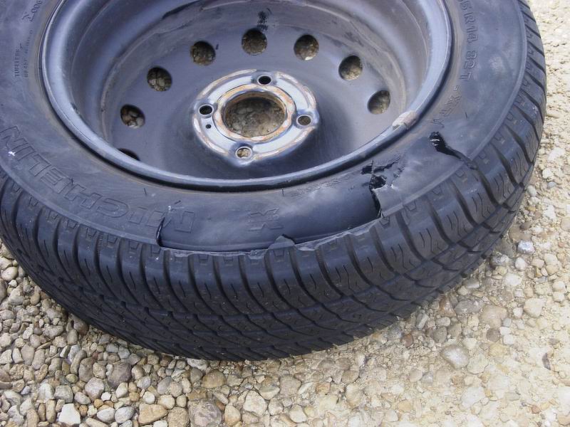

First puncture, big tear in the sidewall, fancy alloy's a odd size as she had the demo car and it had every option fitted. Came home on a breakdown truck after a 3 hour wait, and nobody in the region can supply the tyre size within 48 hours because its a bank holiday weekend. Buy new tyre online, comes next day, fit it with tyre levers myself in the shed.

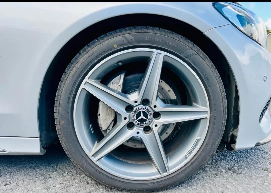

OK so for my W205 it has 17" AMG alloys staggered size front and rear.
So if I buy a spare full sized wheel it should be a front. Very few decent single wheels around.
I have located a 17 inch genuine MB space saver wheel which is supposed to be correct fitment for this car. Meaning it should clear the front brake calipers. So on Saturday I will go to that yard and test fit it onto the front of my car and ensure it does fit. I have a set of rhe proper MB steel spare wheel bolts too already.

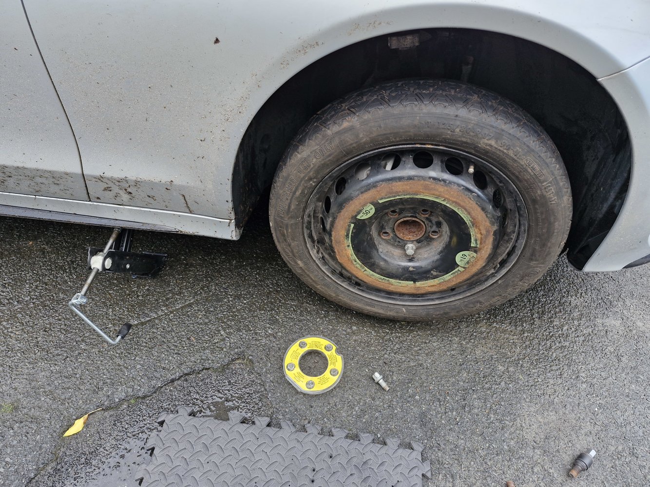

Make sure it is rust in the hub - I discovered alloy wheel bolts on one of mine, when used with a thinner steel wheel, passed out the back of the hub and up against the upright.I got an original Mercedes 17 inch space saver today. Tested it on the front with the large brake calipers and all good. Got an original MB jack too which are compact and solid
The yellow blister pack are the MB steel wheel bolts to go with.
I wanted to test fit the wheel to make sure all was well and I discovered another problem that would have been bad at the roadside!
The threads in the hub are corroded to the point where the steel wheel bolts won't Thread all the way in! So I have ordered a correct sized tap and I will remove all wheel bolts and tap them to ensure that is not an ongoing problem.
I will clean, touch up the rust and order a carry bag for this space saver and throw it in the boot. That leaves me properly sorted now with emergency kit in this car.

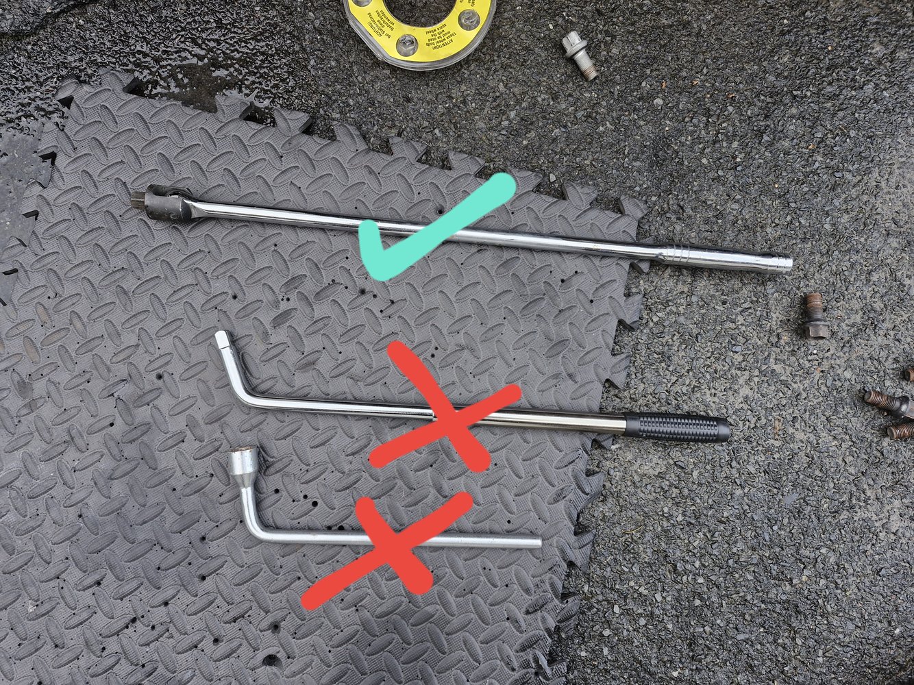

PS in terms of wheel braces only the top one below is any use! The extendable ones with the Swan neck work against you when undoing very tight bolts. Just wrong angle hence a breaker bar is the way to go and a thin wall alloy wheel socket.
