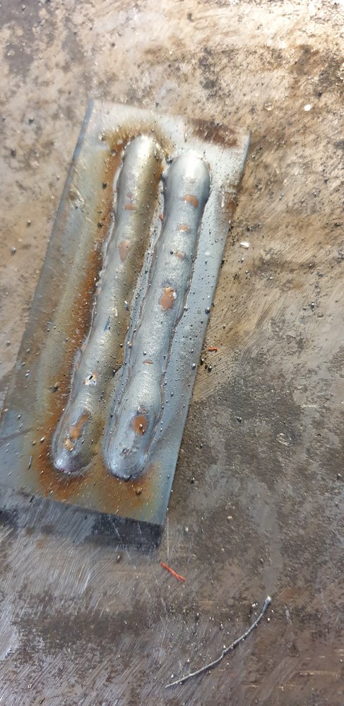

Not bad at all for your first effort !!!For your amusement here are a couple of samples from my first lesson...
View attachment 364817 View attachment 364819

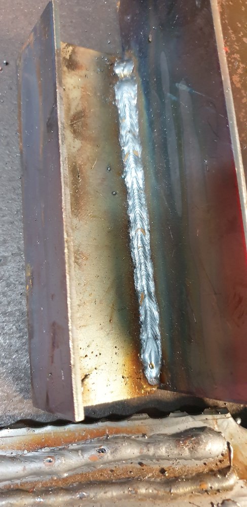

Thanks for the pointers! Tomorrow is the third session so I'll work on the fillet weld. We're all just finding our feet to be honest, some literally have never tried welding before in their lives. I have previously used gas and stick welders when I did my apprenticeship 30 odd years ago, so the concepts are not alien to me but the specific techniques and machine settings of MIG are.As Parm says not bad, re the runs on the plate, I bet the first one was on the left then while the plate was heat soaked you did the second run, with small coupons its best to quench between runs, on the tee fillet the pointed "spine" down the middle is an indicator that you are moving a bit to fast, good start though.
