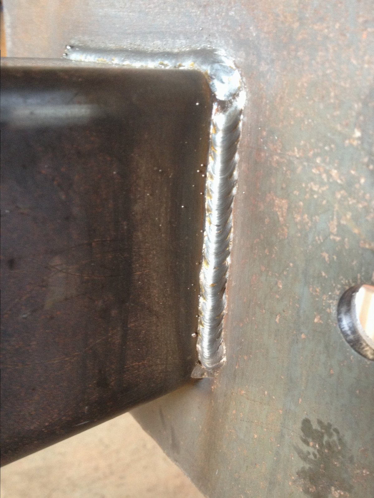

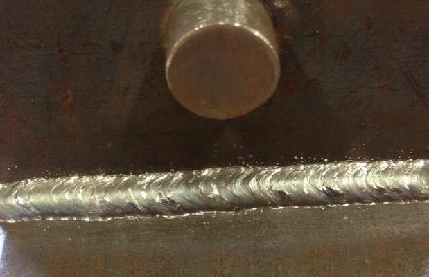

You've achieved a large cold lap on the above weld showing very little fusion on the bottom plate.
It's a typical cold Mig weld where you've weaved and slowed down on the travel to compensate for the lack of power.
I would not be surprised if that's very weak. Thickness like that needs 250 amps blasting down it in a straight line. Weld toes should smoothly flow at both sides of the fillet. Yours are prominent and act as stress risers. Sometimes we don't always get smooth toe transition as welded but we should at least be blending them up afterwards with a grinder.
Turn up the juice to start.

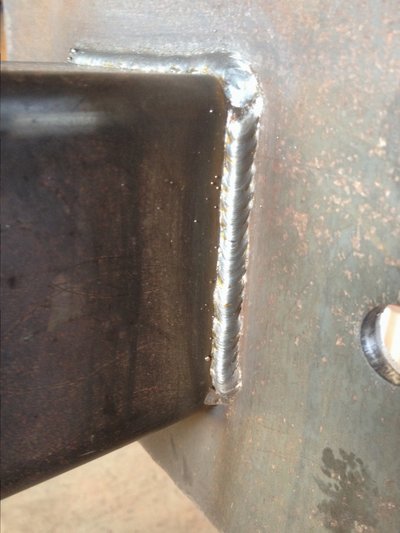

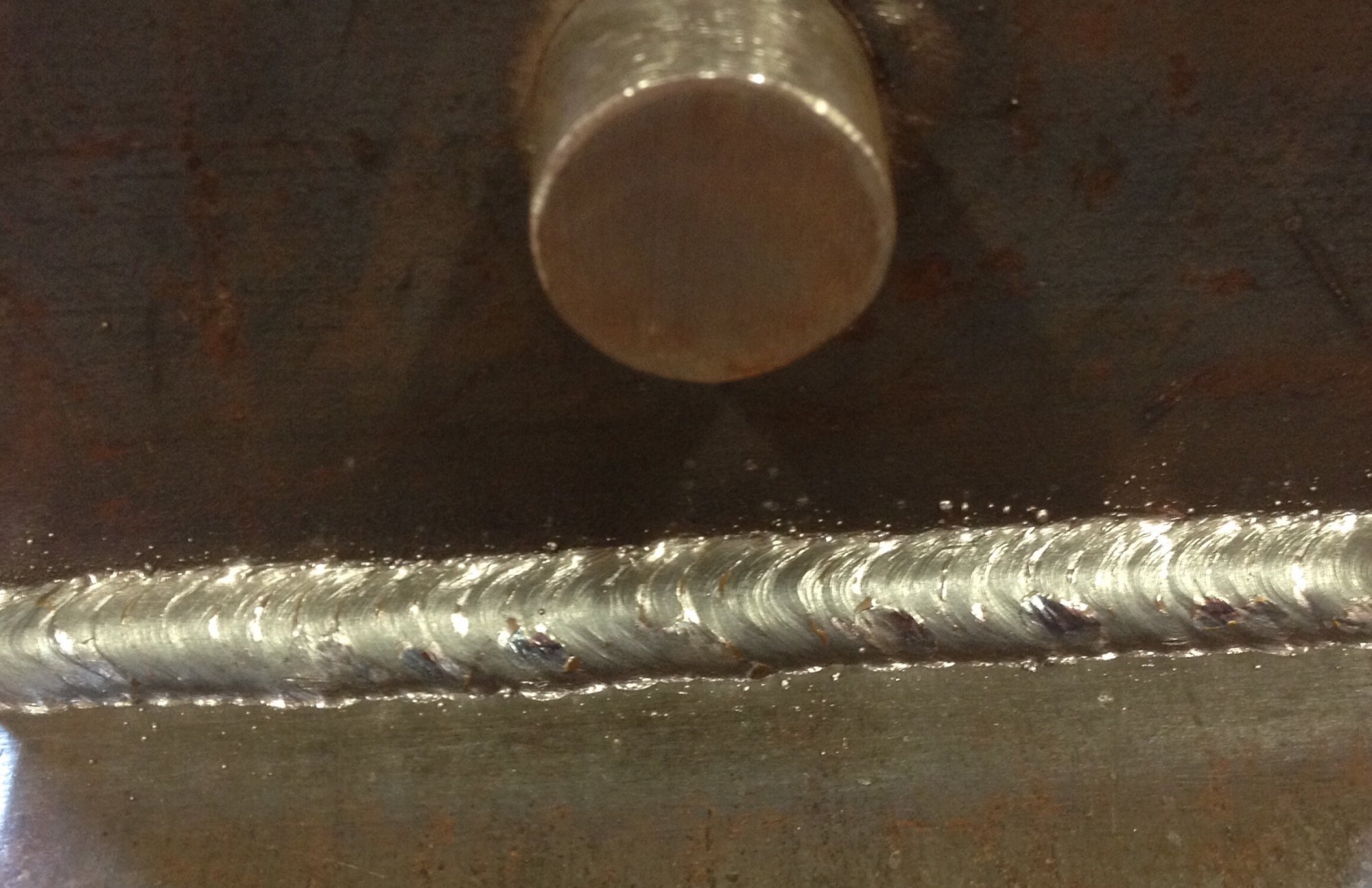

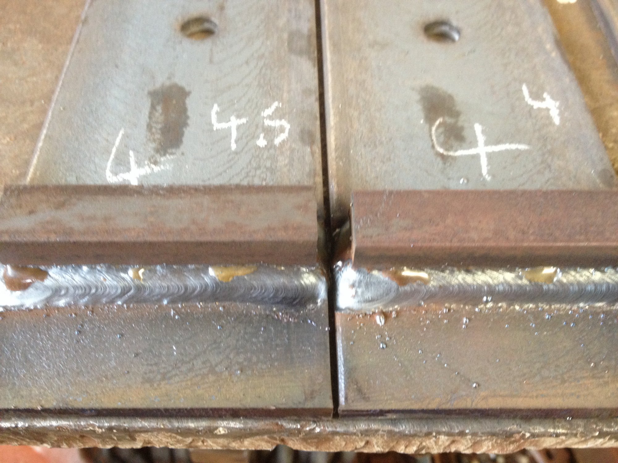

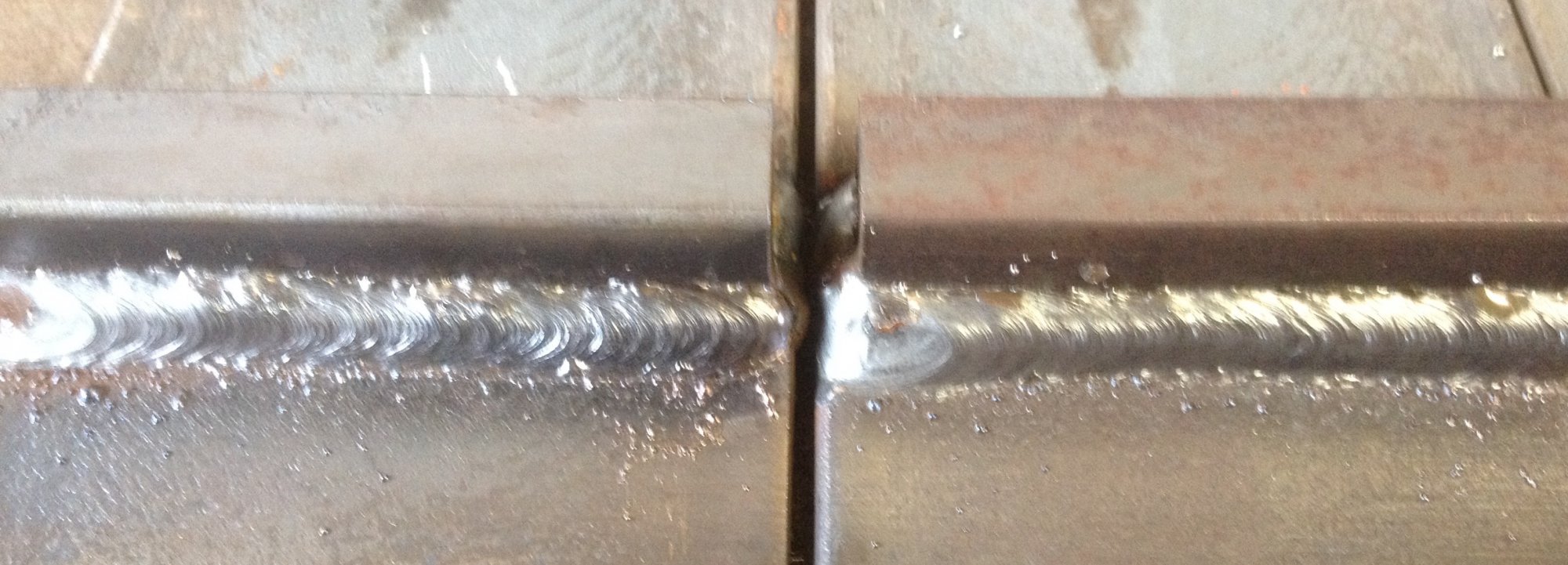

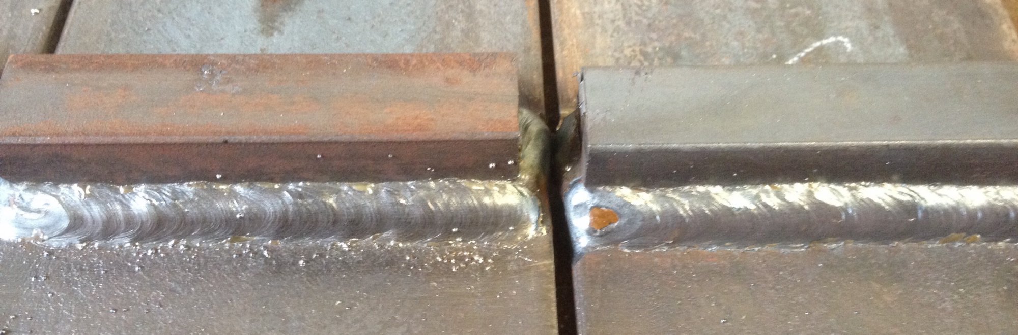

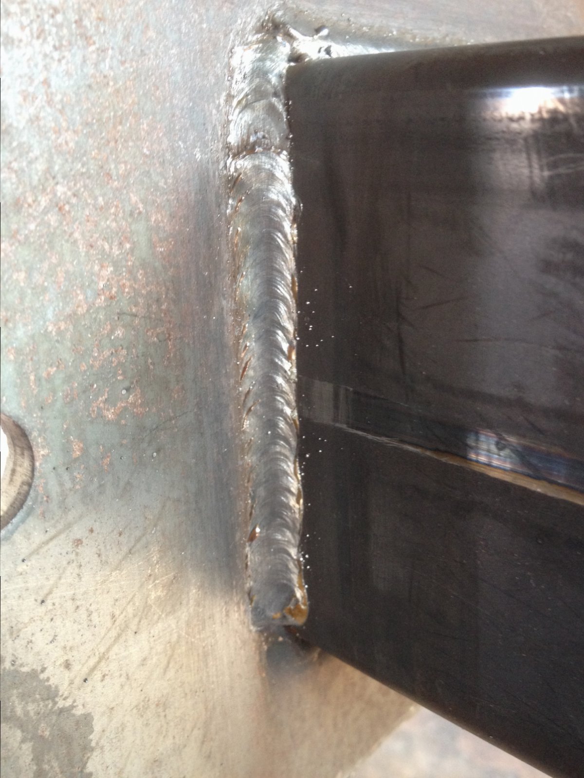

Does the same go for this attempt??
