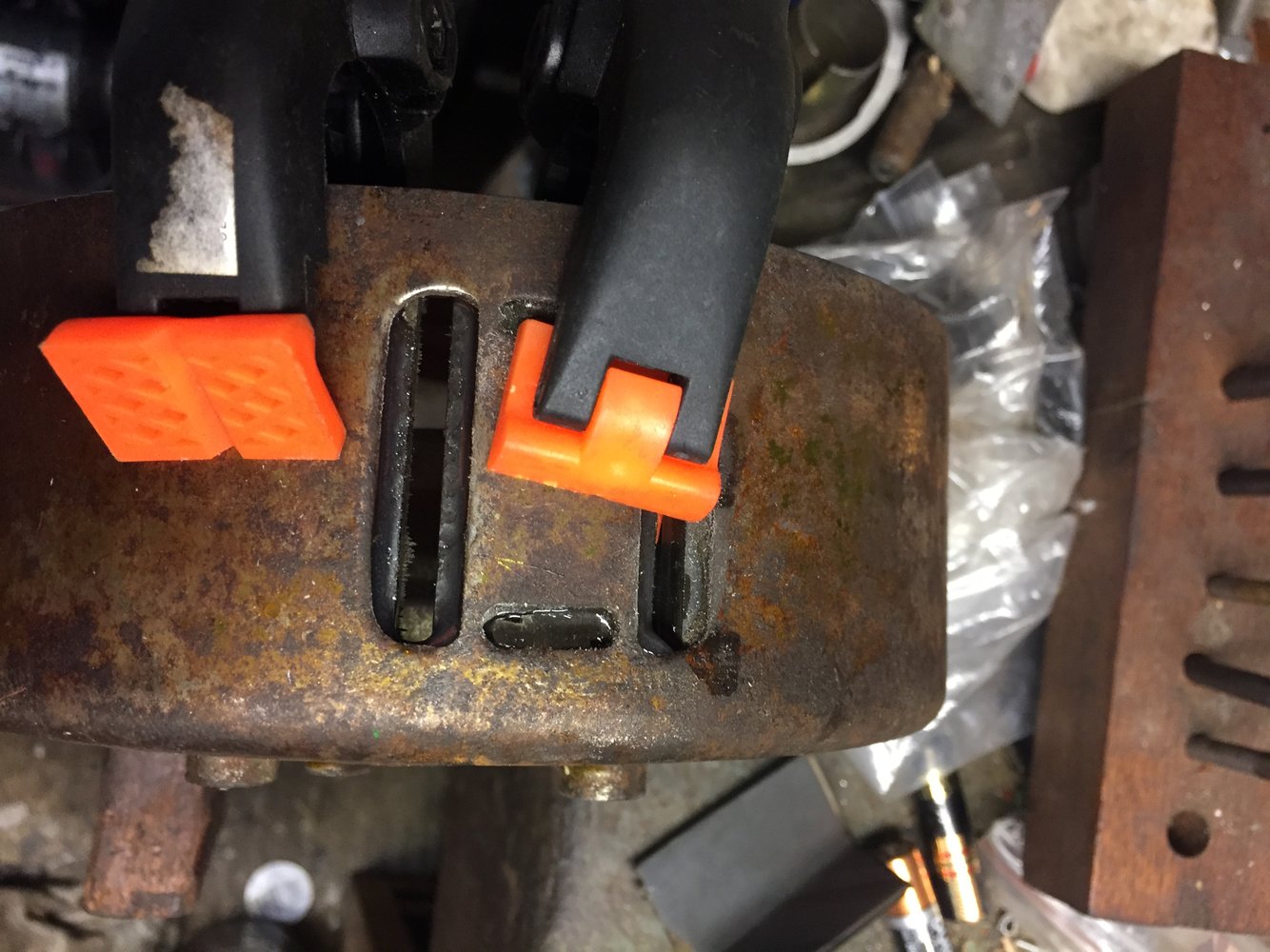

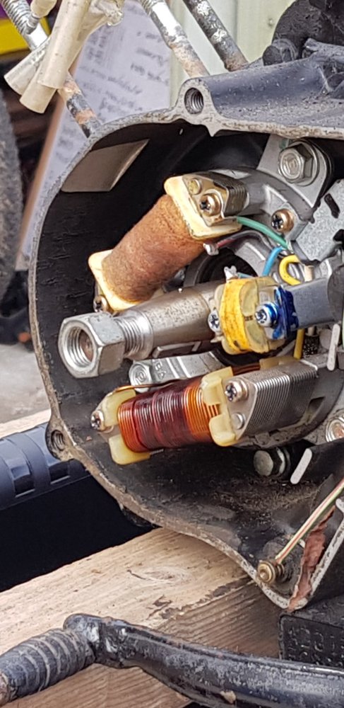

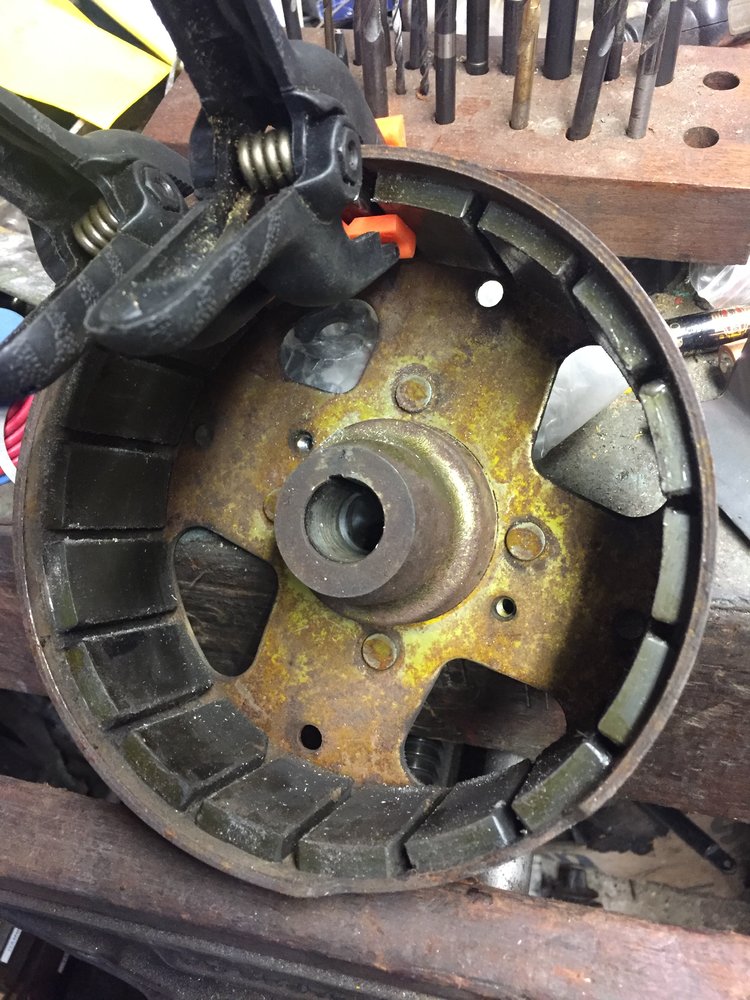

I got an Honda silent generator to look at that wouldn’t start. Pulled the ‘flywheel’ that contains the magnets that revolve around the windings to generate the voltage. This also excites the coil to generate a spark. Two of the magnets had come unstuck. And stuck to each other.
I’ve spaced them out correctly and Araldite them into plac.
I’ve not seen this method of using magnets to do two jobs but can see that the two slots must somehow isolate one magnet to use for the coil.
Anyone know the theory behind it? Thanks for any ideas.
