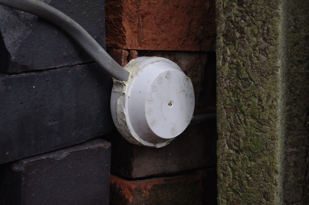

Those glands won't squash down onto Twin and Earth to form a waterproof seal.
