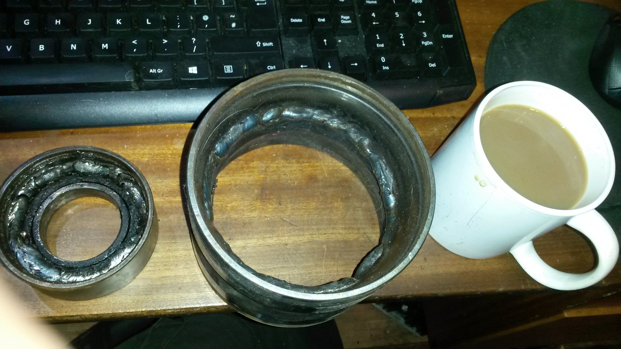

Done them this way for years It has never failed yetAlso another reason I weld them straight off it gives something a little softer to put the drift against, especially on hubs where there is an inside shoulder that the bearing is pressed up to and nowhere to drift against.
Quick with no damage
I have seen big bits of steel straightened with well placed weld beads
