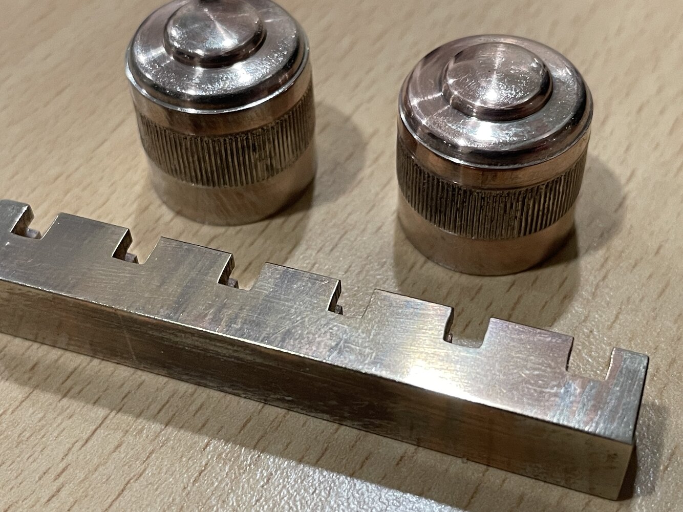

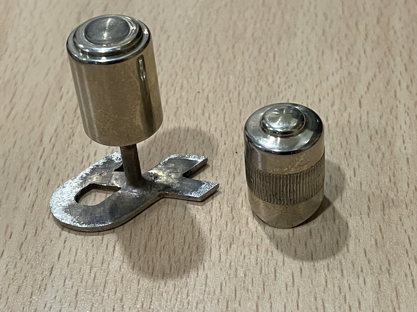

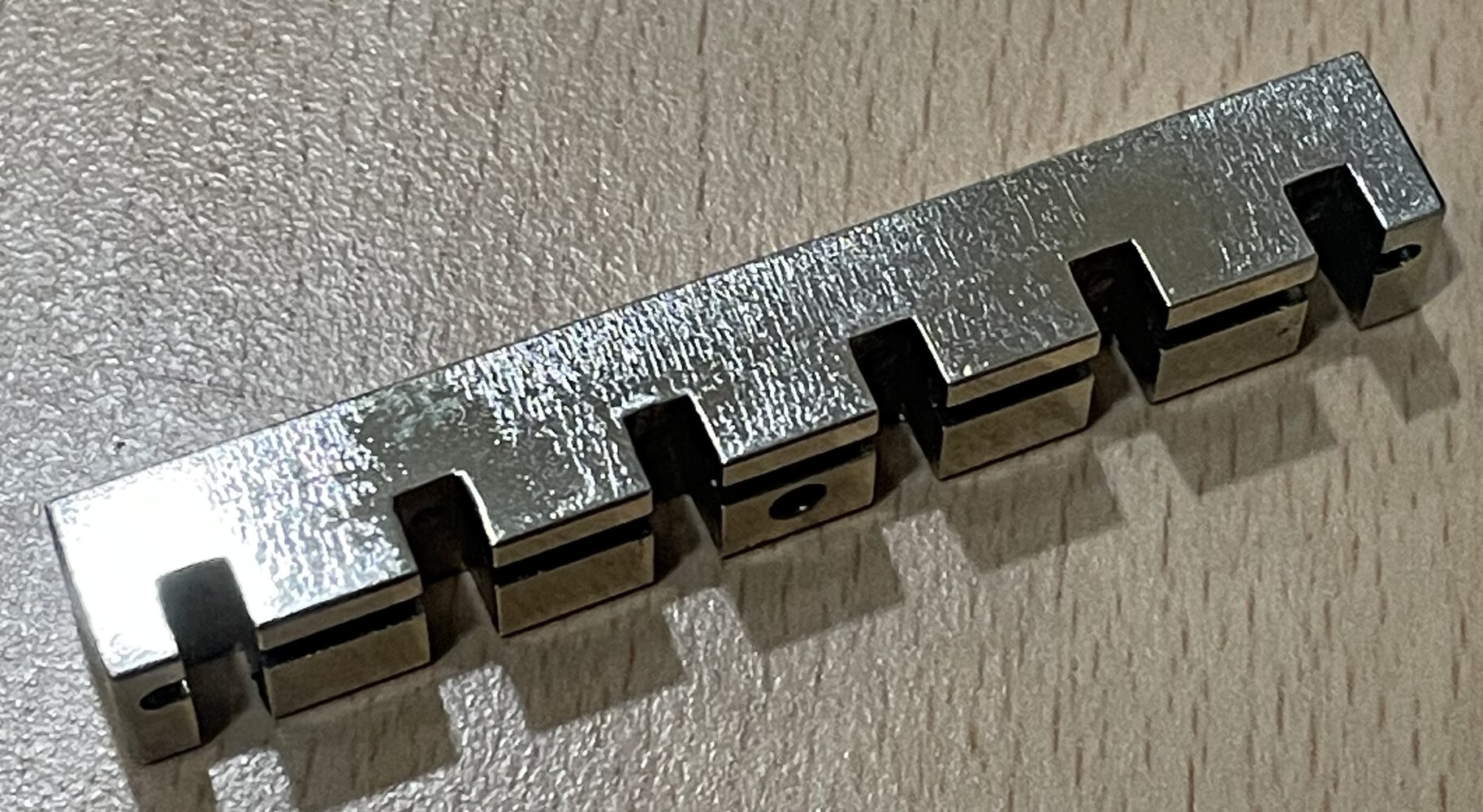

I'm trying to nickel plate a few brass bits -all smallish, this is 10mm sq x 64 long. Some have come out ok, but others not so much. They were all treated the same way - polished to 1000g with wet and dry, then buffed up with Solvol Autosol, 10-15 minutes in the ultrasonic cleaner, then cleaned again with brake cleaner. The electrolyte is Nickel Acetate. Each time some of them have come out like the one below, with a sort of crackle finish. This one is the third attempt - 0.3 amps and around 3v, using abenchtop power supply set to current limit. I put the initial failures down to too much current (around 2 amps at 12v) but reducing the current seems to make no difference.
Any experts here know what I'm doing wrong?
