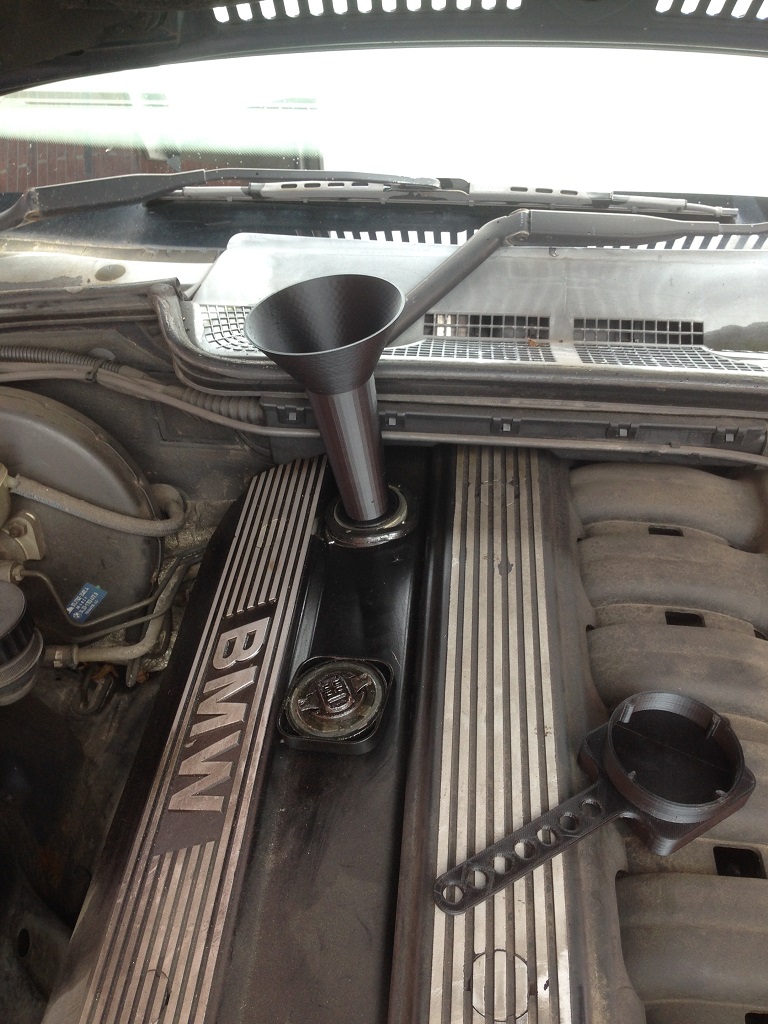

Hi rise funnel and oil / water "spanner"
One side is for the oil and one side is for the rad cap because my wife struggles to undo them to check her oilIs that spanner 38mm to fit the oil filter housing lid? If so, would you be prepared to do one for me and what would you want for it price-wise?
It'd save dragging out the 3/4" socket set when the change is due, although co-incidentally I just did it earlier this week.
EDIT: Just had another look at the pic & I realise it's for the filler cap, because yours in more difficult to get at than mine. In which case, please ignore the question(s).......![]()
The funnel is just because these are a beggar to pour oil in without spilling for anyone.
The thing you are after is one of these?
https://www.thingiverse.com/thing:1480117
https://www.thingiverse.com/thing:2300861
Second takes a lot less material
], even for me, so your wife has my sympathy. However, my oil filler one is further forward - more where your cap is resting, so no problem with access. Which model is yours/hers?
