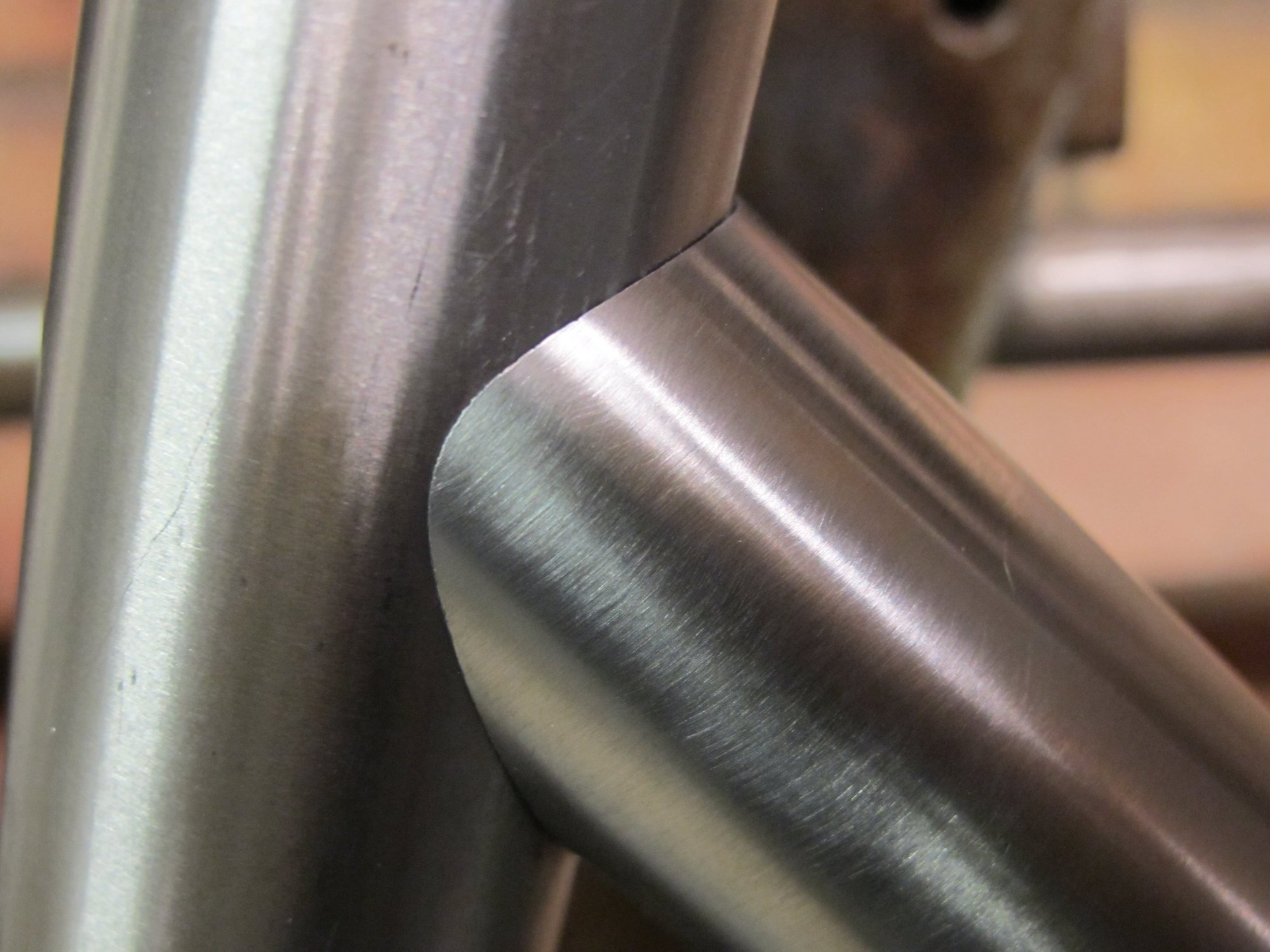

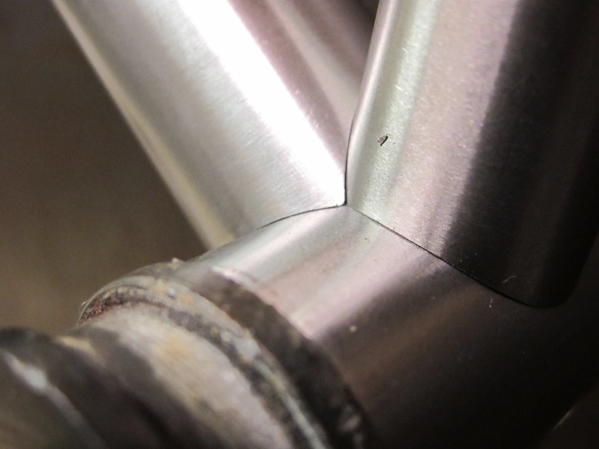

Beautiful!! and the miters are perfect for welding. That should help a lot.
Did you grind them on a beltsander?
I use holesaws as well in a mill. That works fine for me.
Grinding is interesting but produces a lot of dirt in the workshop and a little attachment to fix the seatstays or chainstays as a pair on the machine is easier to mount on a mill I think.
The saws are cheap and you can cut dozens of tubes with one.
Thats why I still use it.

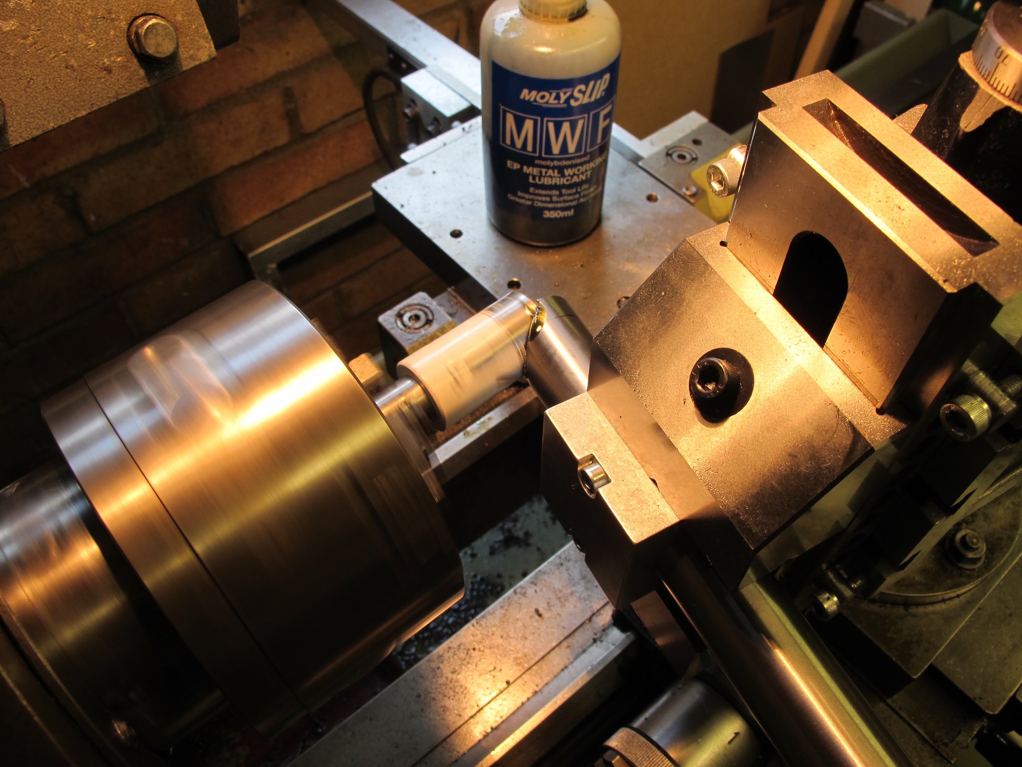

Hi,
when cutting really thin and hard material like (Deda EOM 44mm 0,4wall for example) a tight fitting plastik (pom) plug hammered into the tube helps to stabilize it during the cut. That protects the hole saw also a little from loosing teeth.
It´s one more step but might be worth to prepare a plastic plug before the tube cut on the lathe.
