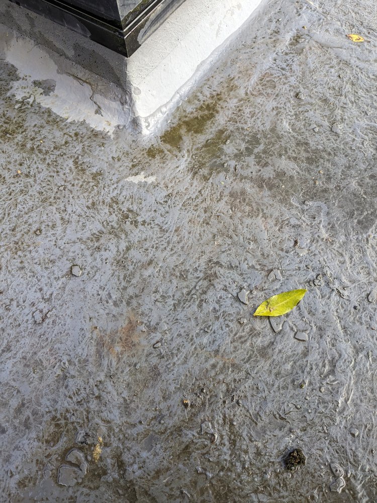

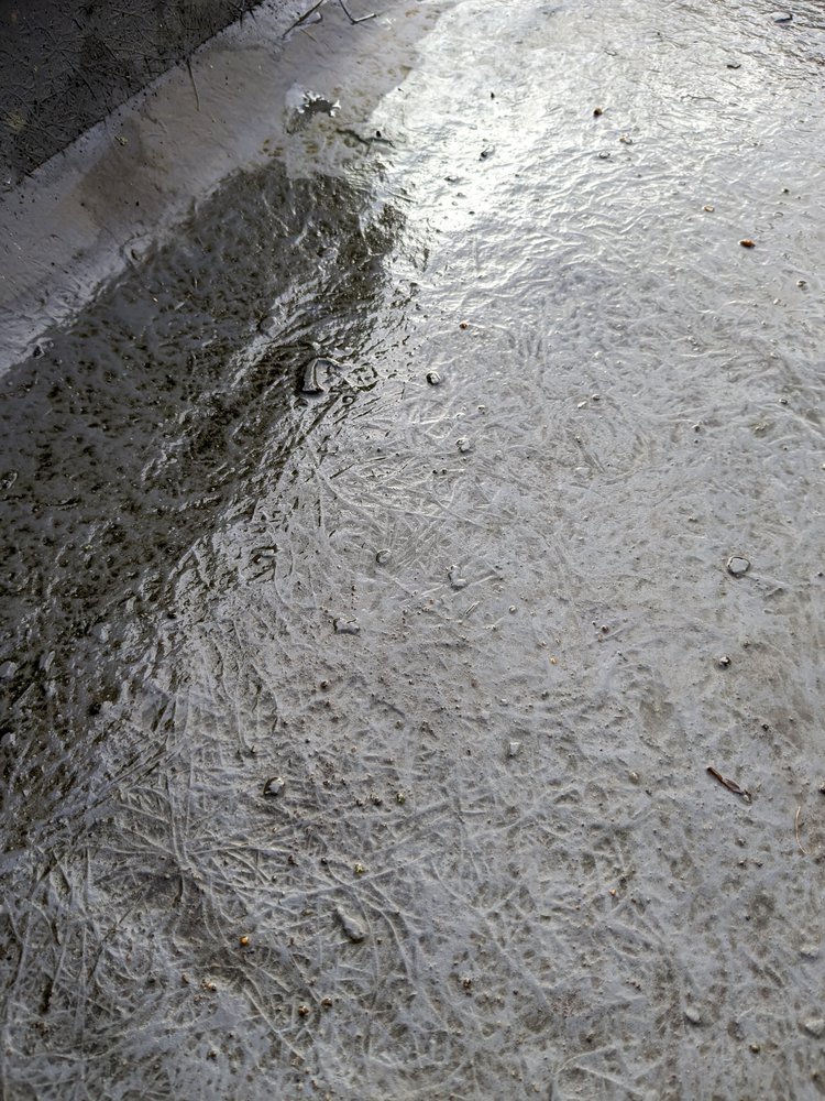

I've got a 3 year old GRP flat roof that sprung a leak in last weeks rain. I've been up for a look but can't see any cracks or holes but it looks like a poor job with the GRP matting showing through the finish. Is that normal?

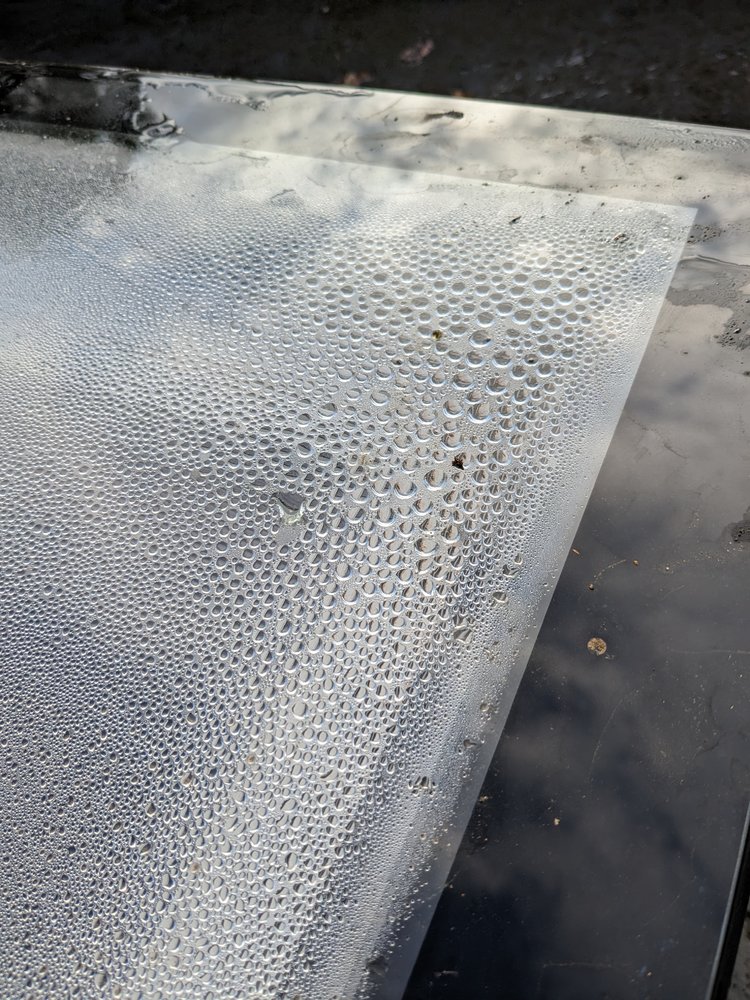

The leak is around one specific corner of a roof light so I'm thinking of adding some more resin or extra matting.
Thoughts?
Thoughts?
20 years ago when these type of lantern windows hit the streets they were sat on a welded four sided sill board that overhung the upstands,giving a good 75mm drip edge and weather protection.
