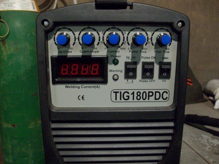

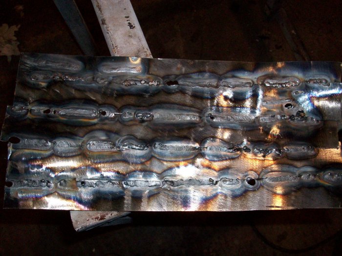

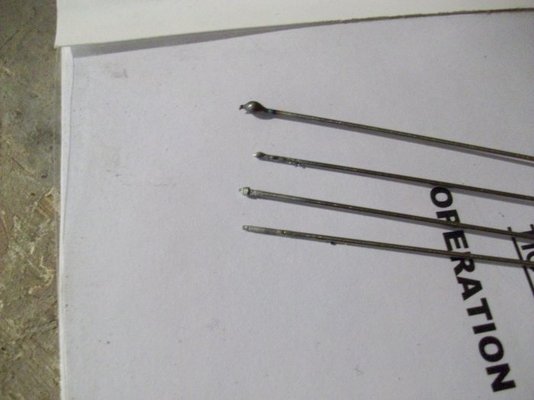

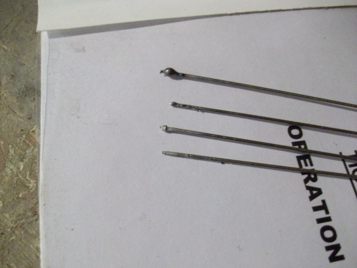

Hey guys, I bought a r-tech TIG180PDC a couple of weeks ago for some welding I have to do on a car. I've done a bit of MIG welding before but never TIG, I thought the TIG would be easy to use on the lighter stuff and leave a nicer looking weld as I'm going to be seam welding the car and the welds will be seen. I've been playing around with scraps from an old car door (1mm? mild steel). My problem is my Tungstens keep burning up. I'm welding at around 30-50 amps with argon gas set to abt 10lpm and a No.6 ceramic cup, I've tried both 1.6mm and 1mm Tungstens, red tipped ones. Have also tried sharpening them to a sharp point and with a very small flat on the end. But both are balling up. I can get a decent enough weld when tips are fresh but after a short time the Tungsten balls up and the arc bounces around. Any help would be much appreciated.
