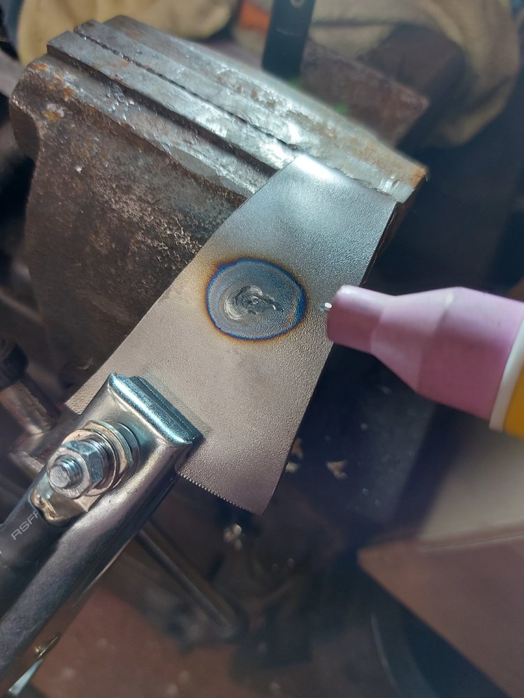

The rule of thumb that I picked up is to start with your cup size in LPM (#6 cup = 6 litres/min, etc.)What flow rate do you guys recommend?

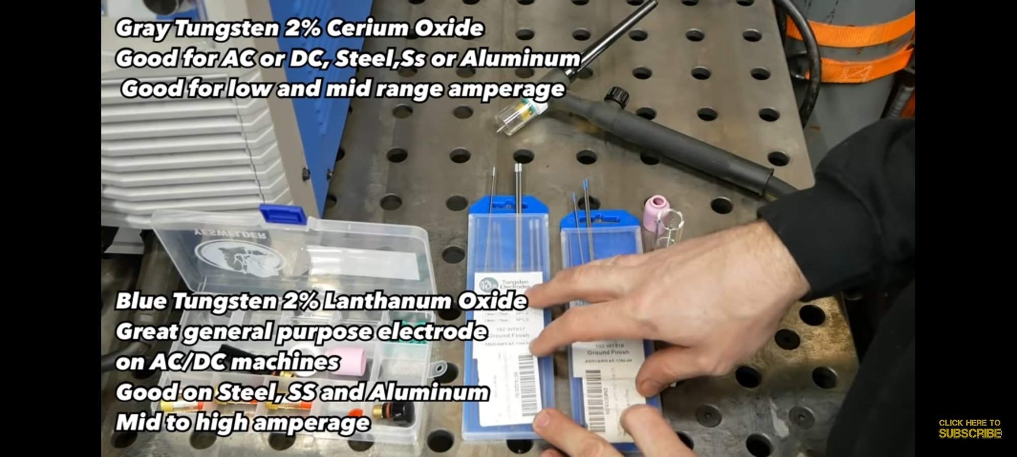

Can of worms…..red works fine on mild steel. Grey and blue work for everything.My first projects with this TIG will be mild steel only. Up to 5mm fillet welds with it.
Looking online I ordered grey & blue tungsten to get started.
Is Red also recommended or are these grey and blue OK for most all projects?
