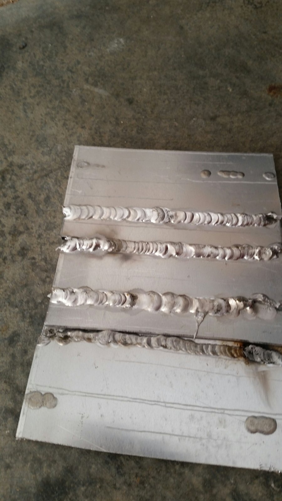

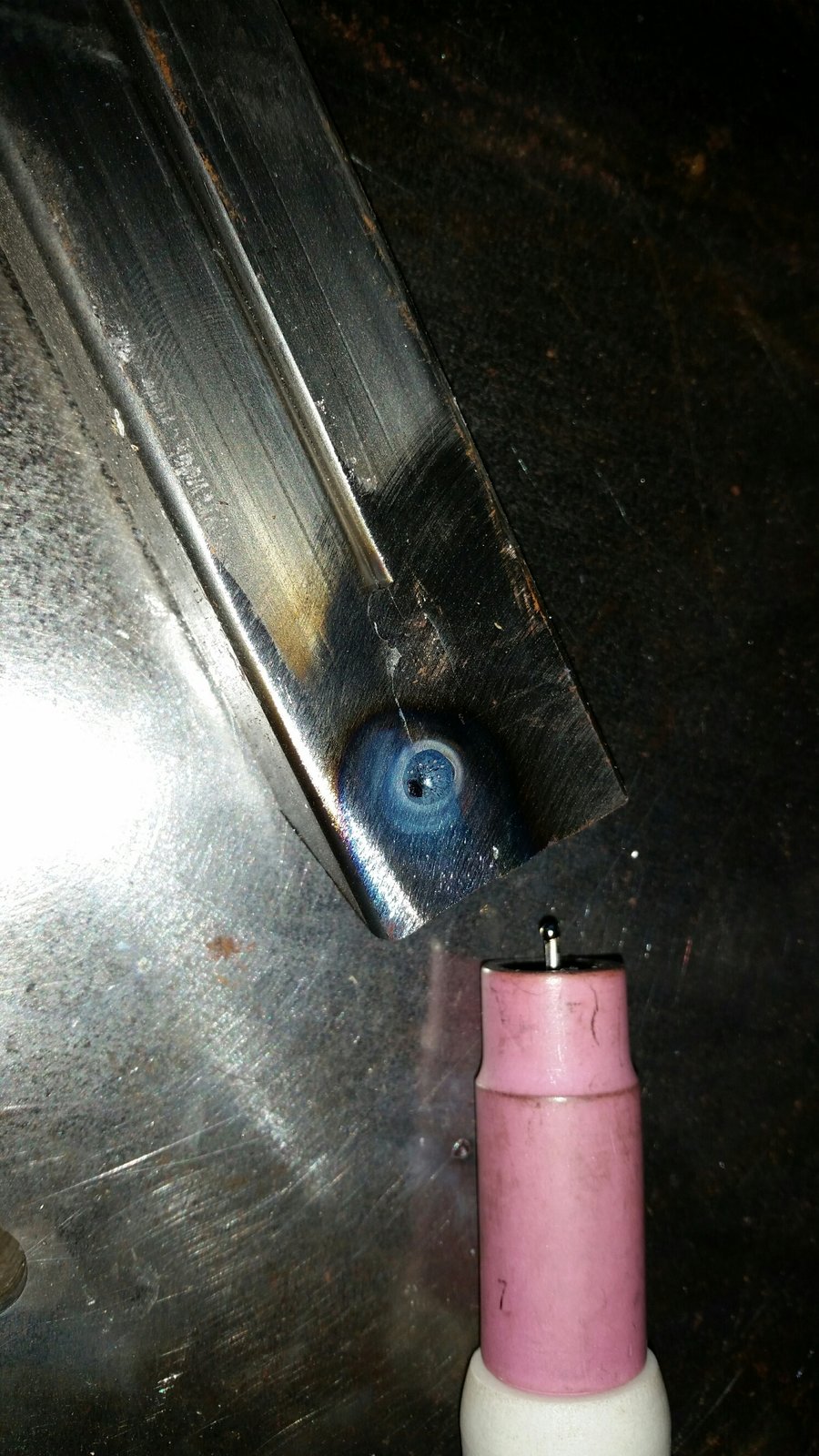

Post flow is way too low also. That's why your tungstens are blue and again will be contributing to the poor starts. You need at least 6 seconds on the lowest current and I'd say closer to 10 for what your welding.
Try striking on dc with a balled electrode daz. Post findings.
That's is mate. Spot on. This will determine if the strike issue is hf related or ac related.Will give it a blast later, Ball it up on ally then switch to dc and arc up on steel?
Ok. Good news I think. This demonstrates your hf is strong even with a balled tungsten.

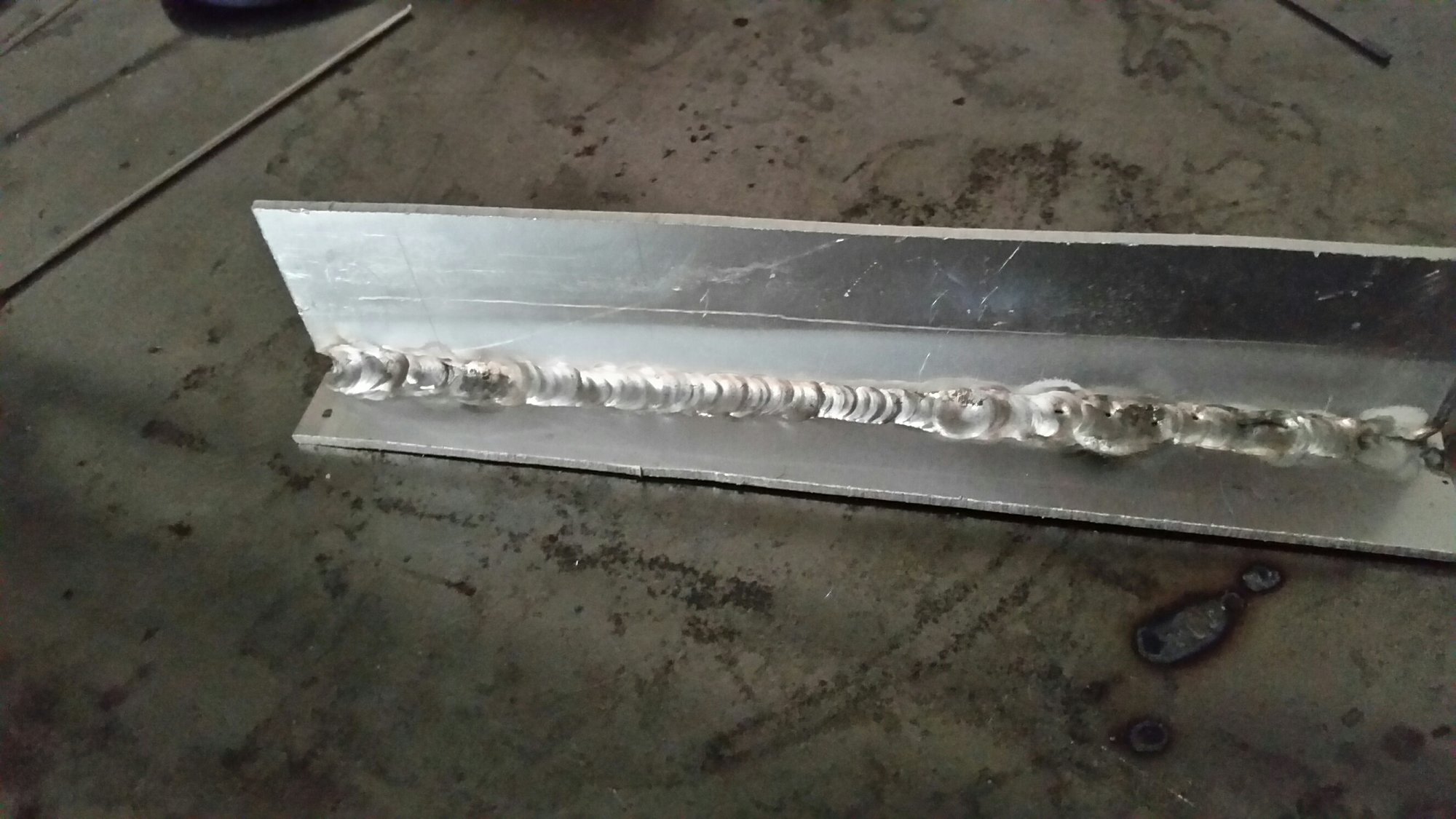

Bad news I have no clue whatsoever as to why it won't strike up as nice on ac.
It's rubbish mate send it to me I'll dispose of it for you. I'll pay postage too (one way![]()
Another member with the same machine has a higher setting but this is was the tech at EWM said.I'd say you've got a machine issue there. Setting 1 shouldn't have that much effect.
Possibly a pin hole somewhere between the bottle And end of the torch too.
Tested all joints will have to pick up a new hose.Yeah a pinhole can cause that dirty start. I typically use around half a second preflow, 6 seconds of post flow (although I'm water cooled so my tungsten cools quicker).
You need enough postflow so that your tungsten stays shiny.
The ignition EP setting must be different to my machine then.
You've definitely got an issue somewhere. Hard to say where without the machine in front of me.
I'd try a new hose from the regulator to the machine and test all joints with leak detector.
HI Simo welcome to the forum, Don't let me slow progress put you off ac. I don't practice enough been on the same bottle of gas for a year which shows i've not been tiging as much as i would like.Dazza, thank you for documenting your journey into the world of Tig. I am also considering a Tig purchase to work on my project car and as much as I would like to go straight in to having a go at aluminium this thread has made me a lot more cautious about jumping in to something that has the possibility of destroying my moral.
I think I will get a cheaper DC welder to first have a play around with stainless steel so I can fabricate a few exhaust components and I will definitely be keeping an eye on this thread to see how you get on. From the little I know about welding and having read this whole article in one sitting your welds have become much better from when you first started out and your perseverance is exemplary.
