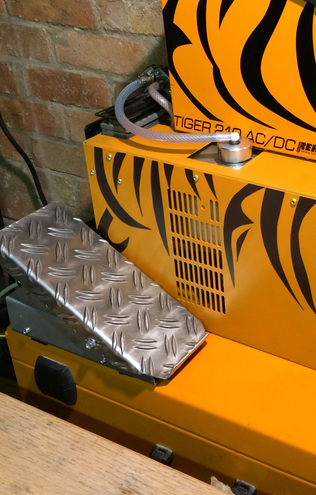

Well if it's that bad why don't you make your next project a perfect pedal for you.I will keep practising, need to work out a way to get comfortable first.
You got all the guts and wiring so it's just a case of transferring it into a shell more suited for your seating position. My old Rehm pedal was the best I've used by a mile. The angle, the design, the smoothness etc and the foot part was a nice piece of folded Alu chequer plate.

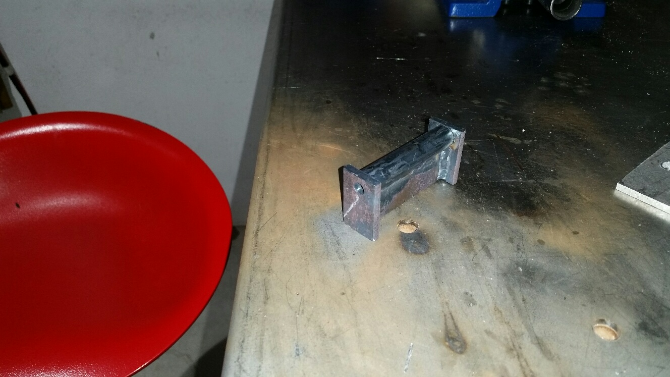

. I'm going to make a rest for grinding lathe tools.

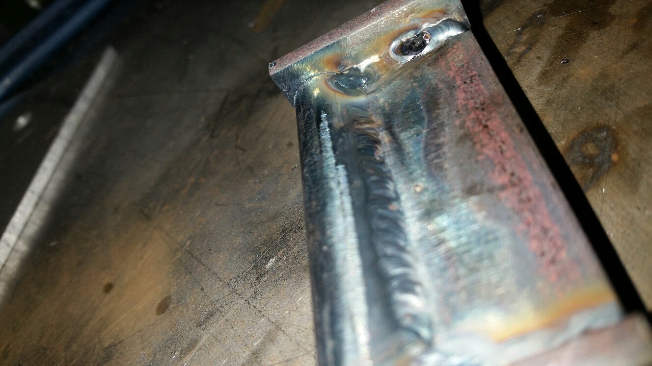

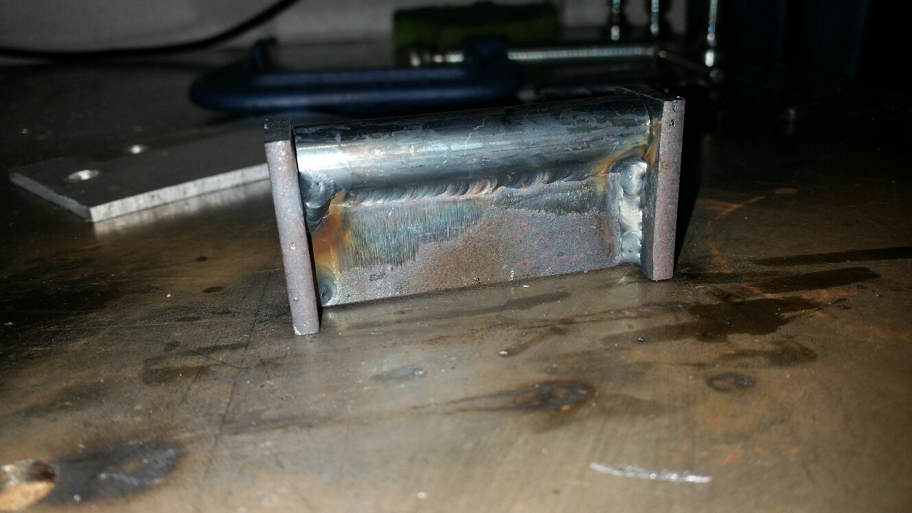

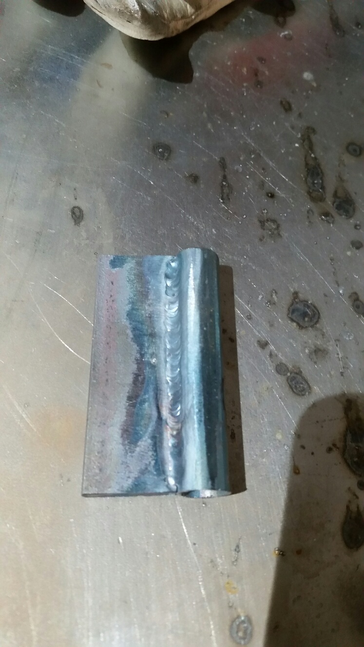

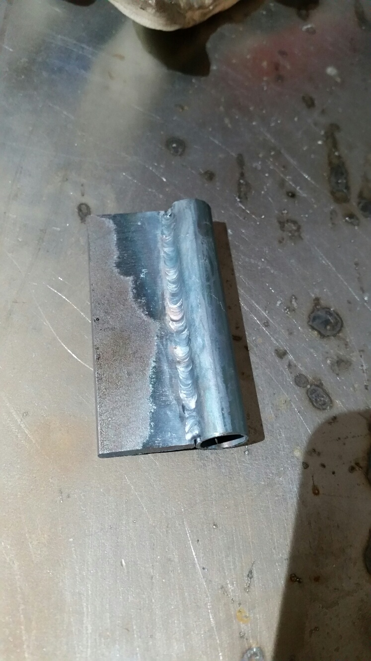

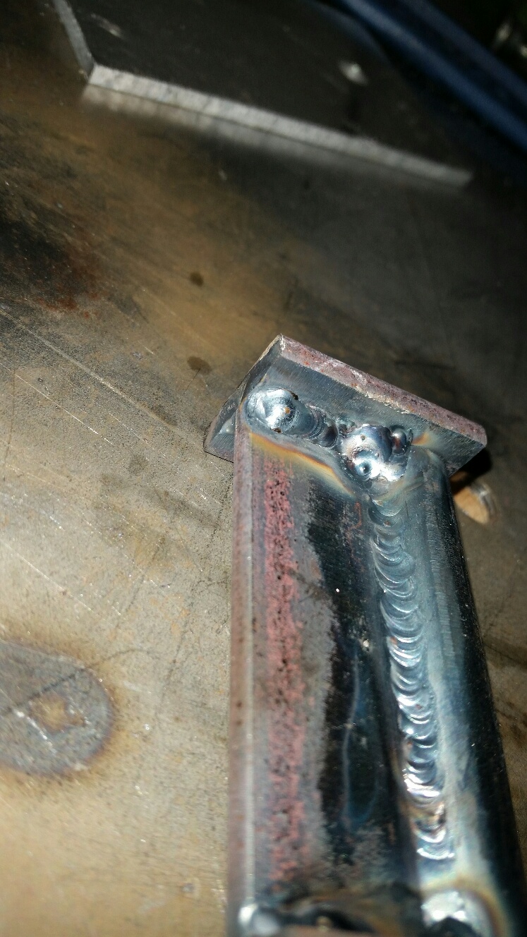

. Learnt a few things though... up the gas when you stick your stick out, its weird because i've never had problems with shielding and stick out until today. even when you up your gas you may loose shielding when you get to the edge of your workpiece.
