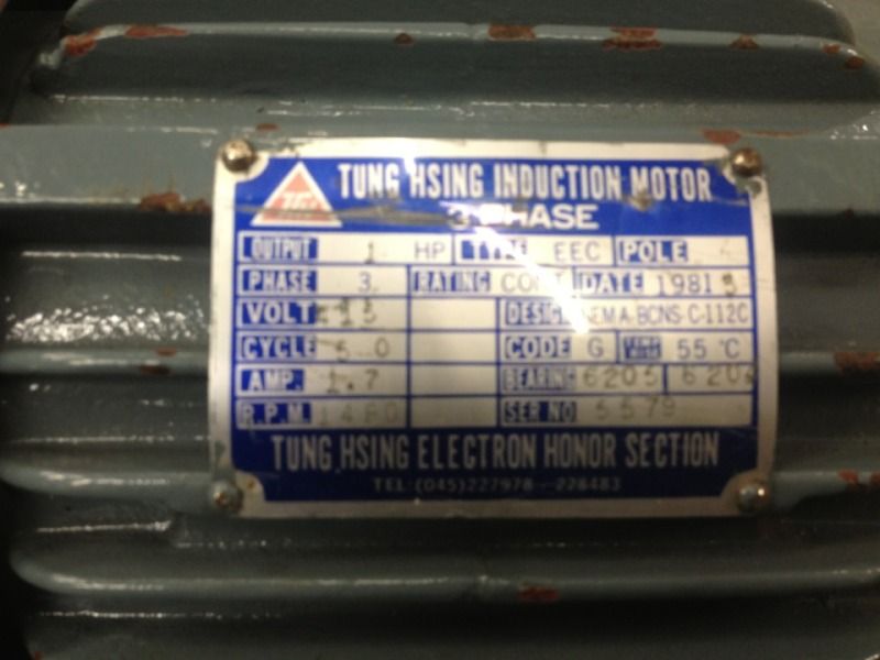

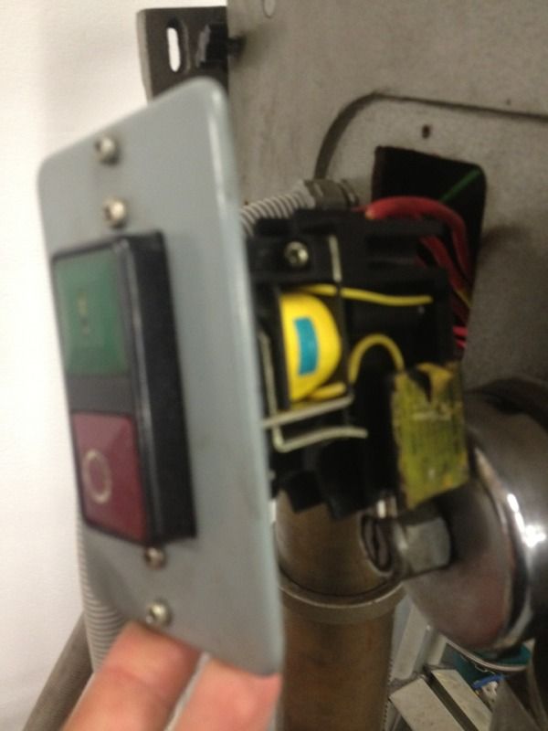

its not a dual voltage motor so wont run on an inverter unless u get a 415volt one and the starter switch has a 415 volt coil so that will need changing 2
Lot of the stuff I see only has start /stop buttens, Machine mart/clarke all look on/off jobs. simple cheap push in to make contact push red to release, no motor protection and if theres a power cut during drilling it starts up on its own when power is restored.- unless you have hit the red.

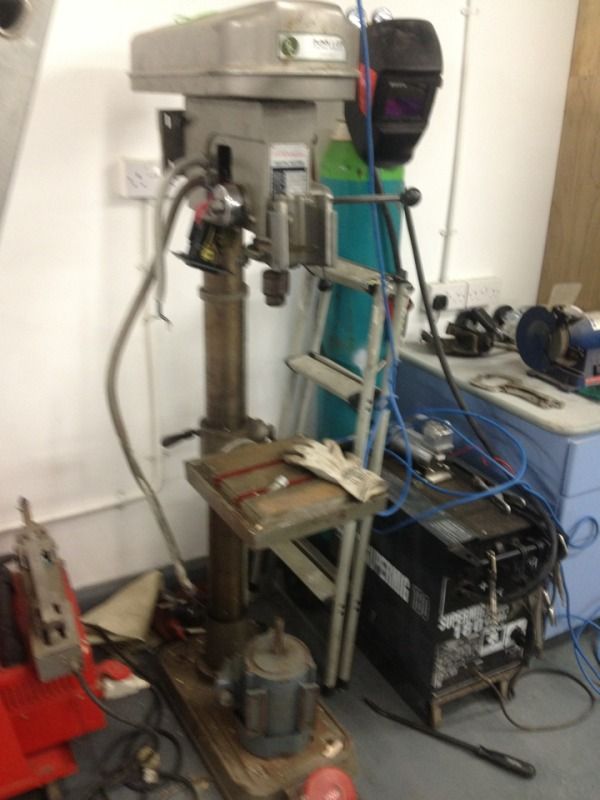

If it's anything like the one I did last week, just a matter of unbolting the 3 phase motor, finding a single phase motor with the same mounting holes, fitting the pulley from the 3-phase to the single phase (boring or bushing as neccessary), and bolting on the single phase motor.
NVR switches are cheap on ebay.
I mounted mine in a box - the original motor on mine didn't have one fitted (looked as tho it was hardwired, and the switch had been left behind on removal)
I'd really like to work the stop as well if I can?
