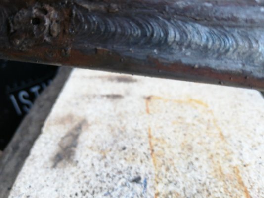

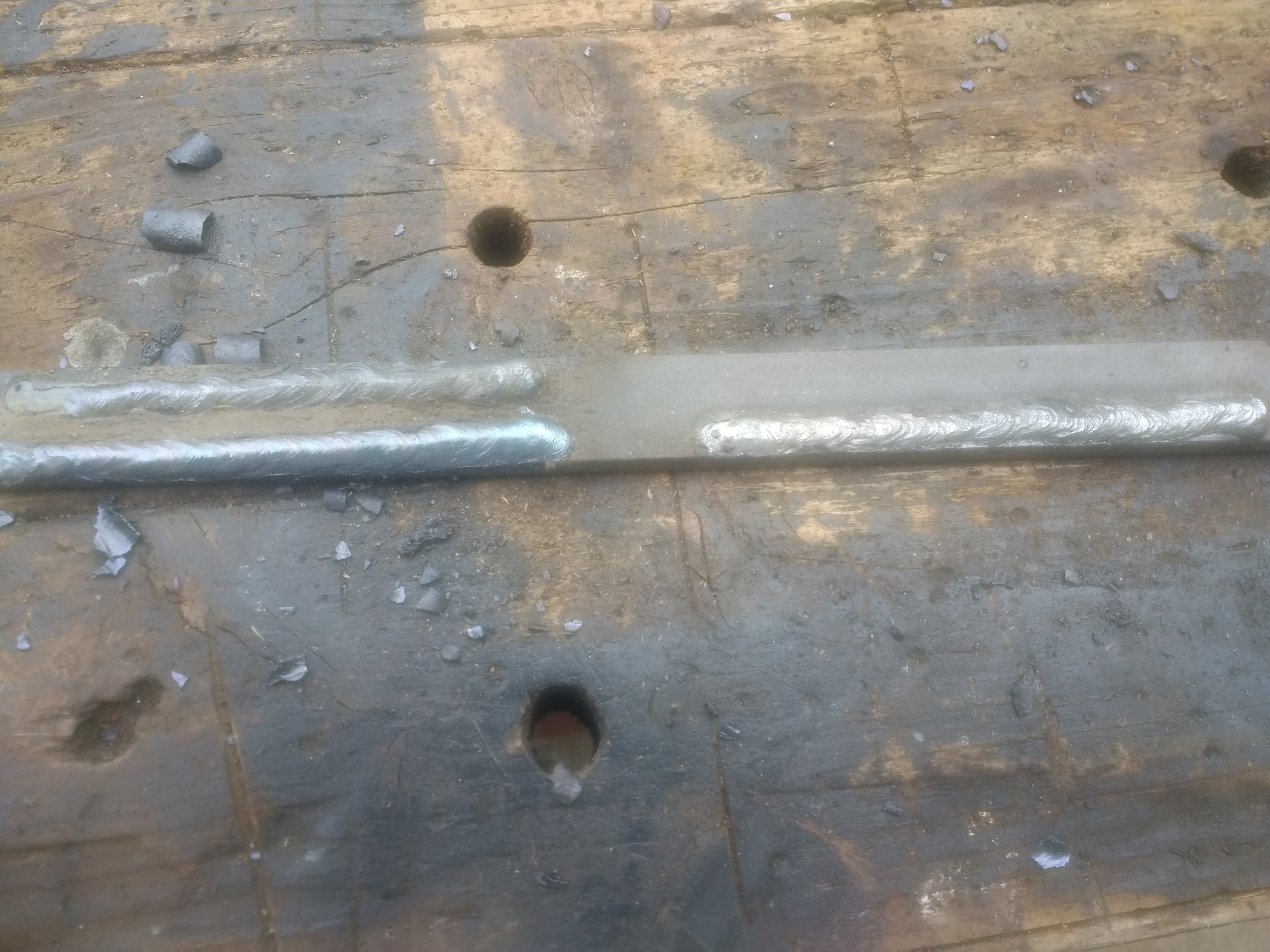

Watch the puddle ,I say that because if you look the puddle when you weld you should see the puddle digging into the parent metal and slowly it fills upDoh...me an computers, sorryView attachment 191787
The sides are critical ,give an eye on them
Try to keep always the same travel speed
7018 isn't fluid as 6013 so any variation of arc length and travel speed go to change how the bead looks
