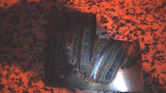

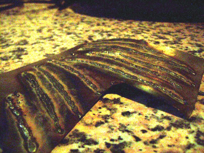

went out today and bought a clarke MIG90EN and all the stuff needed for gas welding , unfortunately I was given industrial 0.6mm tips - so Im practicing gasless for just now
