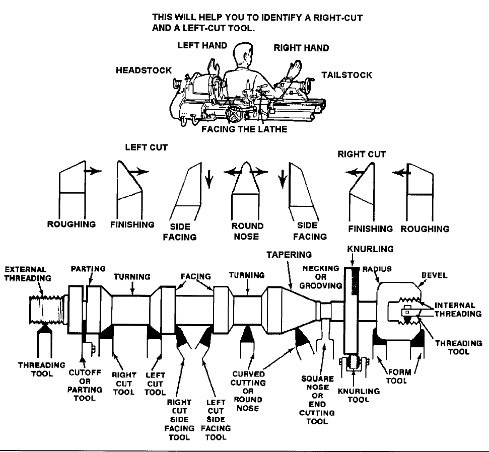

Got hss tooling on the way. Should be here Monday.I suspect youll get far better results doing away with those carbide horrible chinese tools and either going hss as described earlier by kmp or tipped.
Also keep the stick out as little as possible for best results
The most time consuming thing at the moment is finding out what tool shape/design is for different jobs.Well done I'm sure you won't regret it in the long term, a bit of time to try out different shapes, various angles etc and then when you decide to go for tipped tooling you will have a good idea what type of tool will suit your work best. Rather than buy the sets when you feel ready for the change buy the individual tools that you feel work best for you. I still use HSS for much of what I do but I also have a selection of insert tooling for the harder materials or when I really want to reduce the diameter quickly. While it is not fashionable to say at the moment, it is quite possible with the right speed and feed and a well shaped and ground HSS tool on a Myford 7 series lathe to take a 4-5mm cut off mild steel in one cut. Yes you will need basic coolant and the tool will need re-sharpening more often, but you will gain a feel for the cut and how your lathe is handling it. Changing the various tool angles will also show you how small changes can help the machine by reducing the cutting force necessary and this will allow you to choose the right tool for your task. It won't happen overnight but with a bit of effort you will soon look back and say what was I worrying about. Just as you will now recognise the need for adequate clearance when boring. Good job by the way glad you got it sorted.

You can do an awful lot with 5 basic tools.The most time consuming thing at the moment is finding out what tool shape/design is for different jobs.

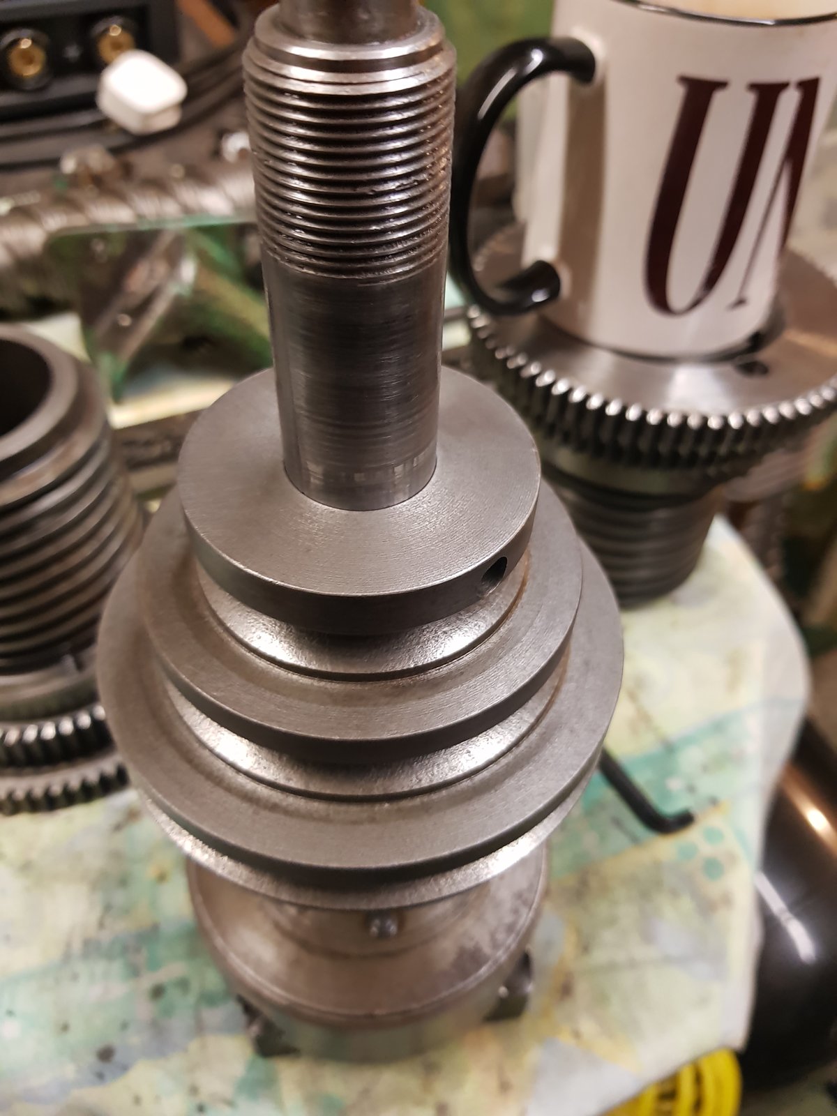

Sorted...cheers. will get a drum on order.
Will find out this morning once I had a tidy up. It's a right mess in there at the moment.NP. Nice to see the pulley fitted. Hope it smoothed the drive out.
