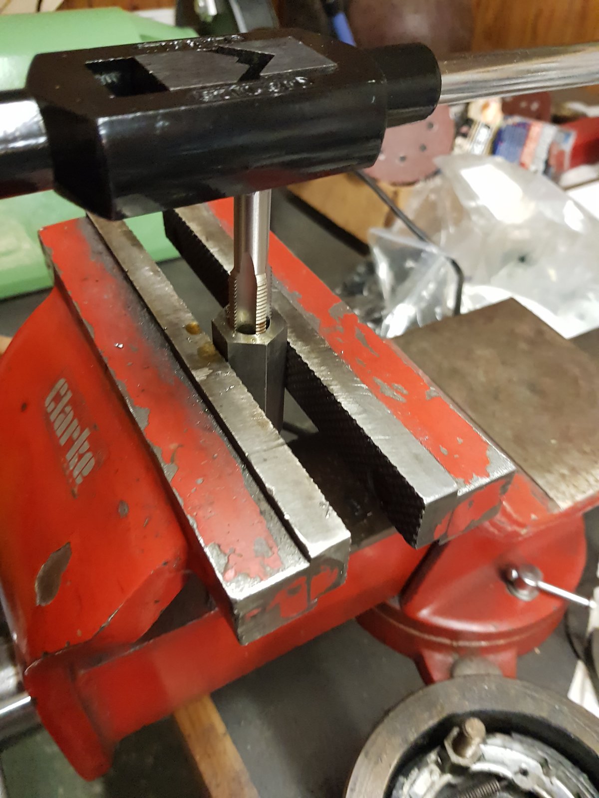

or u turn the chuck by hand using the chuck key and wind the tailstock in at the same time to start it off parallel
