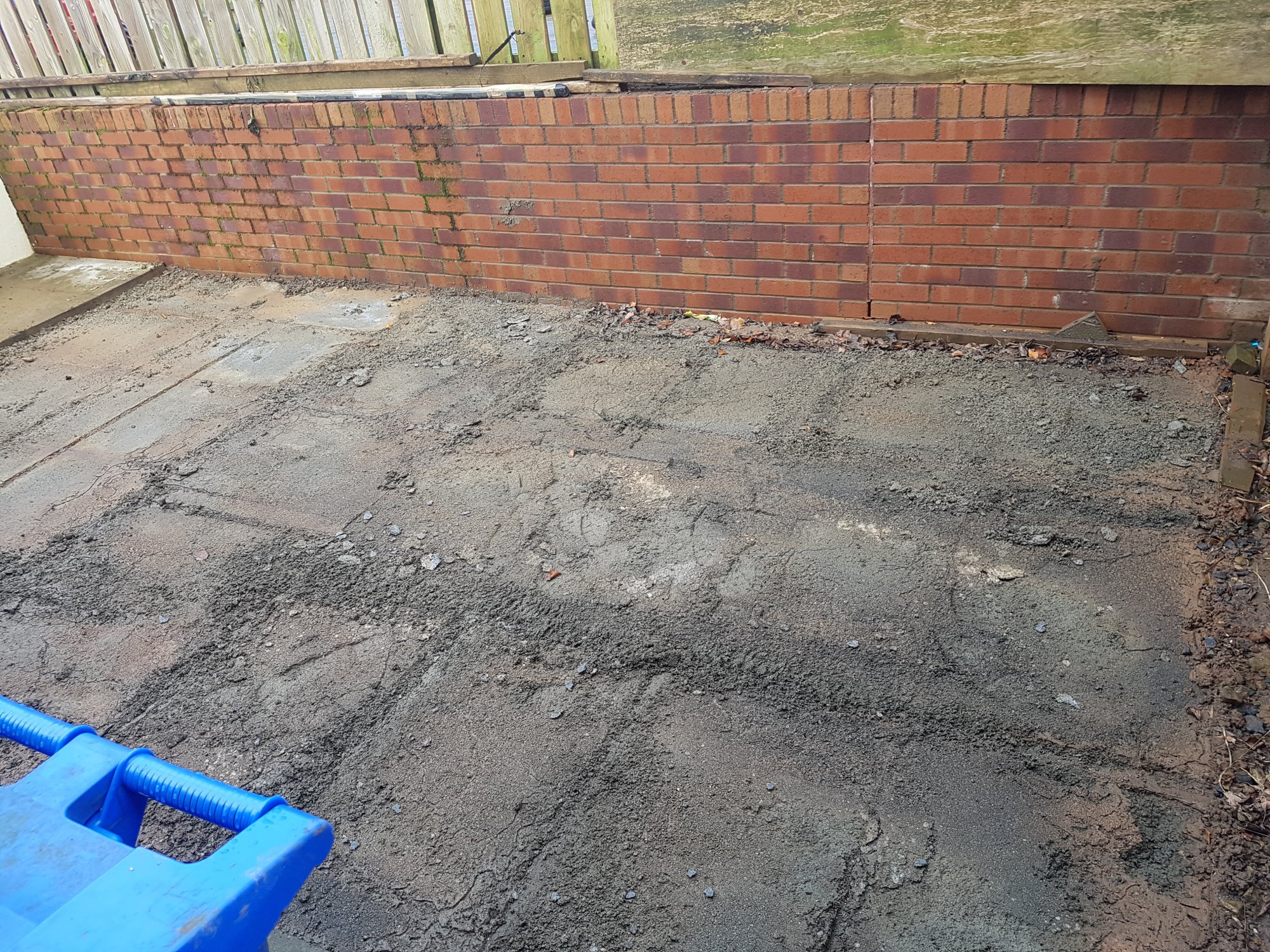

Just a couple of things, its well worth including a DPM under the concrete and its also worth organising one of those mixermate type batchers when you order the concrete. It will give you plenty of time to lay and finish the concrete, they only charge for what you use and the dont make the same mess when washing out. Its also worth giving some thought to duct entries in the slab, its a lot easier to install a few ducts into the base for cable/waterpipe entries than trying to get them in at a later date. Just thoughts.Thats the concrete sorted thenJust a couple of things, its well worth including a DPM under the concrete and its also worth organising one of those mixermate type batchers when you order the concrete. It will give you plenty of time to lay and finish the concrete, they only charge for what you use and the dont make the same mess when washing out. Its also worth giving some thought to duct entries in the slab, its a lot easier to install a few ducts into the base for cable/waterpipe entries than trying to get them in at a later date. Just thoughts.
Edit: forgot to add float finish rather than tamp, if you spend some time on the float finish you will get away with sealing/painting the surface as is.

Going for the batch mix option. We have a company 2 miles away that does it. Was contemplating power floating it to finish it, but not sure I'd be capable of that.
