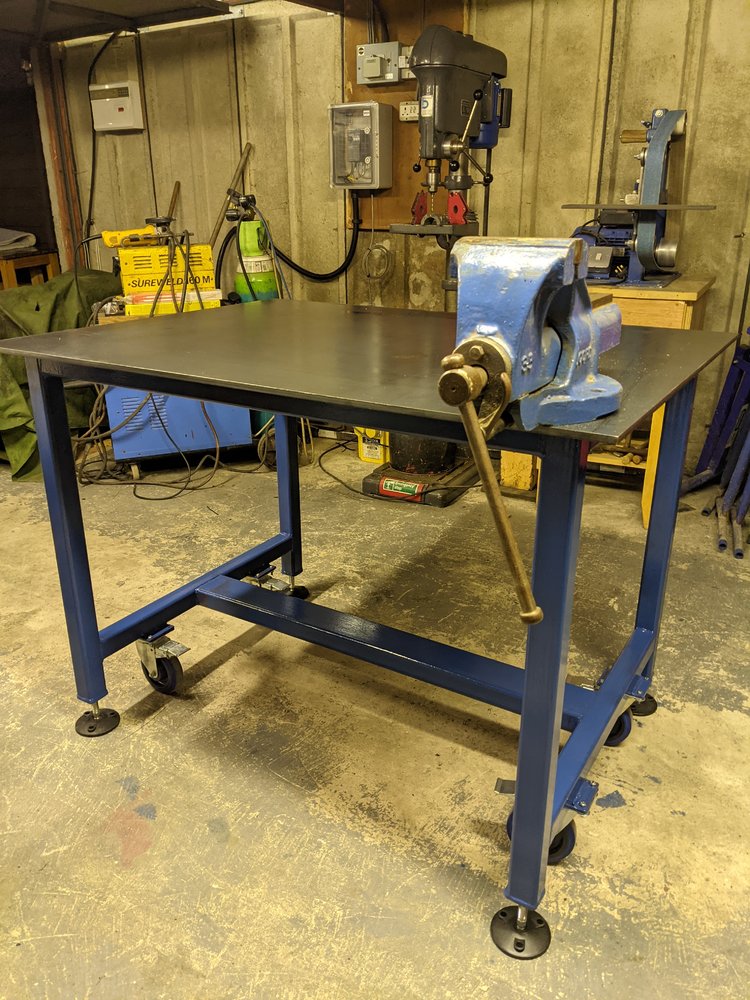

A few weeks ago I posted a thread about leveling castors, @Munkul advised me to steer clear of the 'all in one' jobs and I'm glad I did, sturdy, level and moveable, thanks for the advice.
Theres more to making a decent bench than meets the eye for a relative newcomer like me, theres a slight bow to the center which I can't do nowt about, I've learnt a lot but like the result. Cheers.
Now to fit the vice properly and some fixture holes...
(10mm Top, 5mm wall thickness box and rectangular section, conveyor leveling feet)
